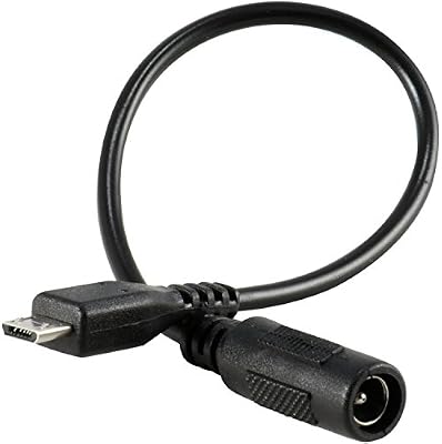

I use this since forever for my phone (usb-c), tablets and micro-usb devices. I plug them and sometimes I add a small dot of glue (external) to keep it secure. Never had a problem since years.
worth the price, almost nothing... There are now some round (rotating) connectors: never tested but the idea is the same.
magnetic%20micro-usb
