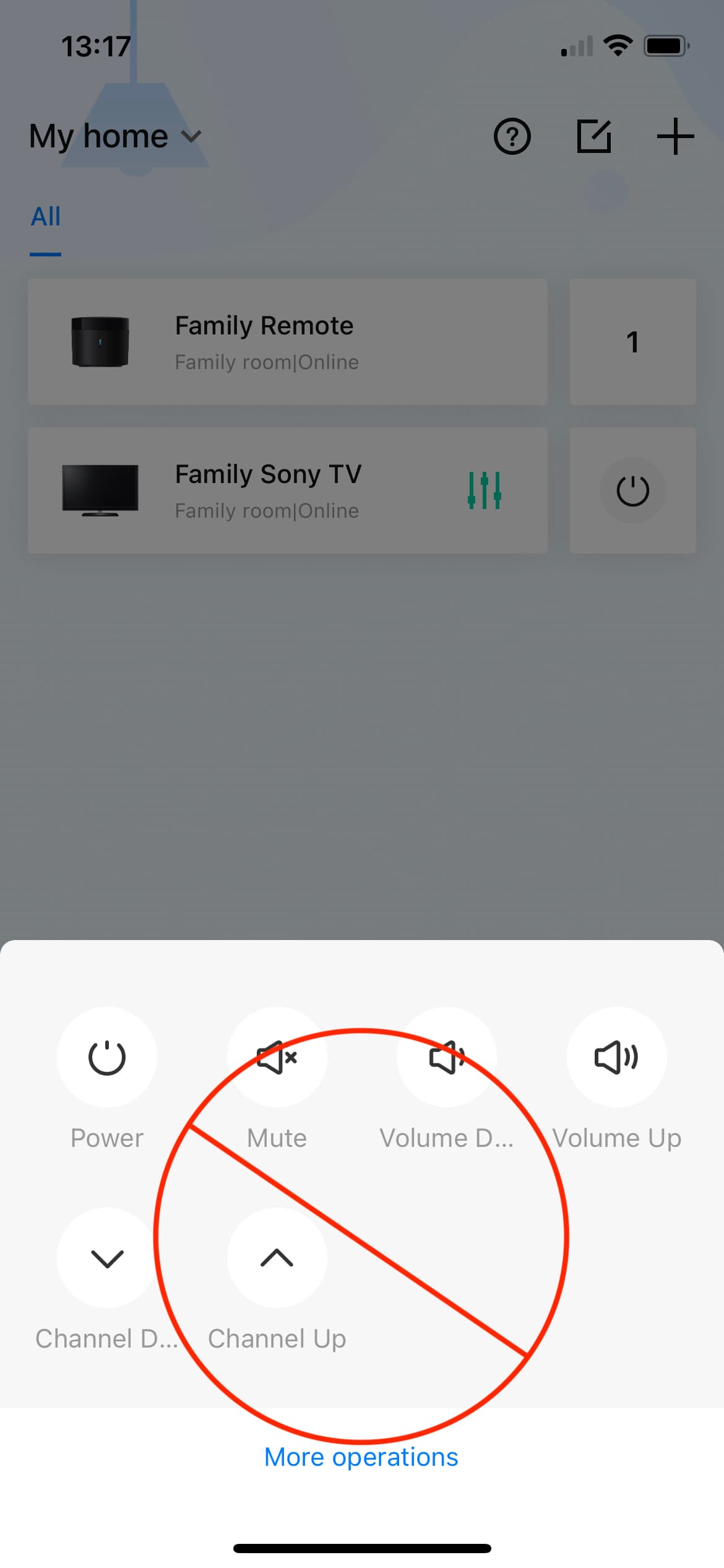

You aren't able to use devices and codes from the Broadlink mobile app once you get in to this integration in Hubitat. You'll have to re-learn the codes or import them from somewhere else once you get them in to a format that resembles a long string of hex characters starting with "2600..."
Which type of Sony device is it? My receiver is a Sony and I have learned most of its functions and could share the codes if that would help.
Thanks. This is the answer I needed to hear. I was hoping my that I could simply tell it my devices that were in the broadlink app but now I know better.
It's an older Sony Bravia TV. No worries on sharing codes as I have the remote and will do the training this evening. Or maybe I can get my kids to do it! Lol..thanks again for the quick help!

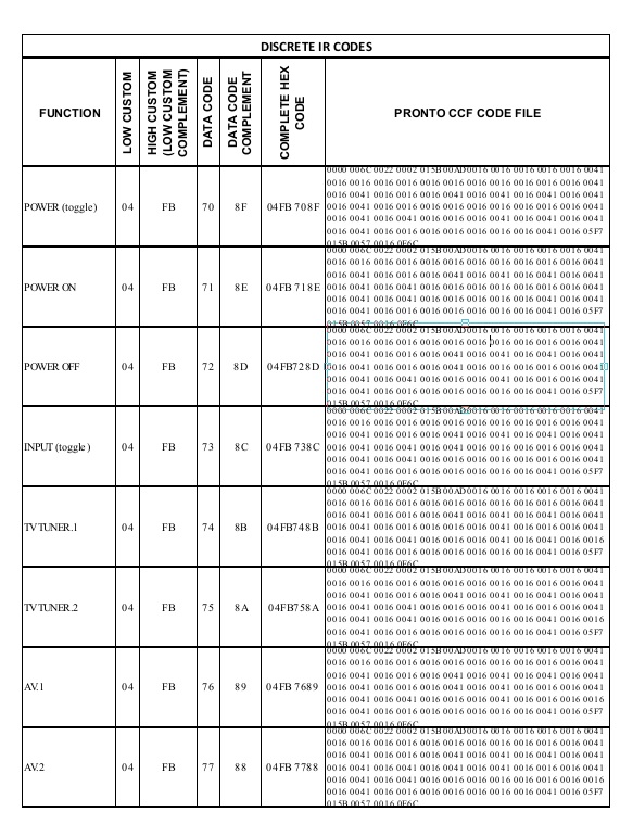

I have a pdf IR code list for my Hisense 55UG6 Roku TV. Can I convert it into a format that I can use to import the codes? If so, what does that format look like?
Those are labeled as Pronto codes, which is a standard format that my integration can support.
If you use my Broadlink System Manager app, you can import Pronto codes and it will convert them to the Broadlink format to be stored in the app. Then you can sync them out to Broadlink Remote virtual devices from the Broadlink System Manager app.
Check out the "Usage Instructions" section of the readme for the system manager app.
I saw that in System manager. It does work importing them one at a time.
Is there a way to put them in a file and import them all at once?
No, you'll have to import them individually to the app. But you can then sync them out to a virtual device in one batch operation.
