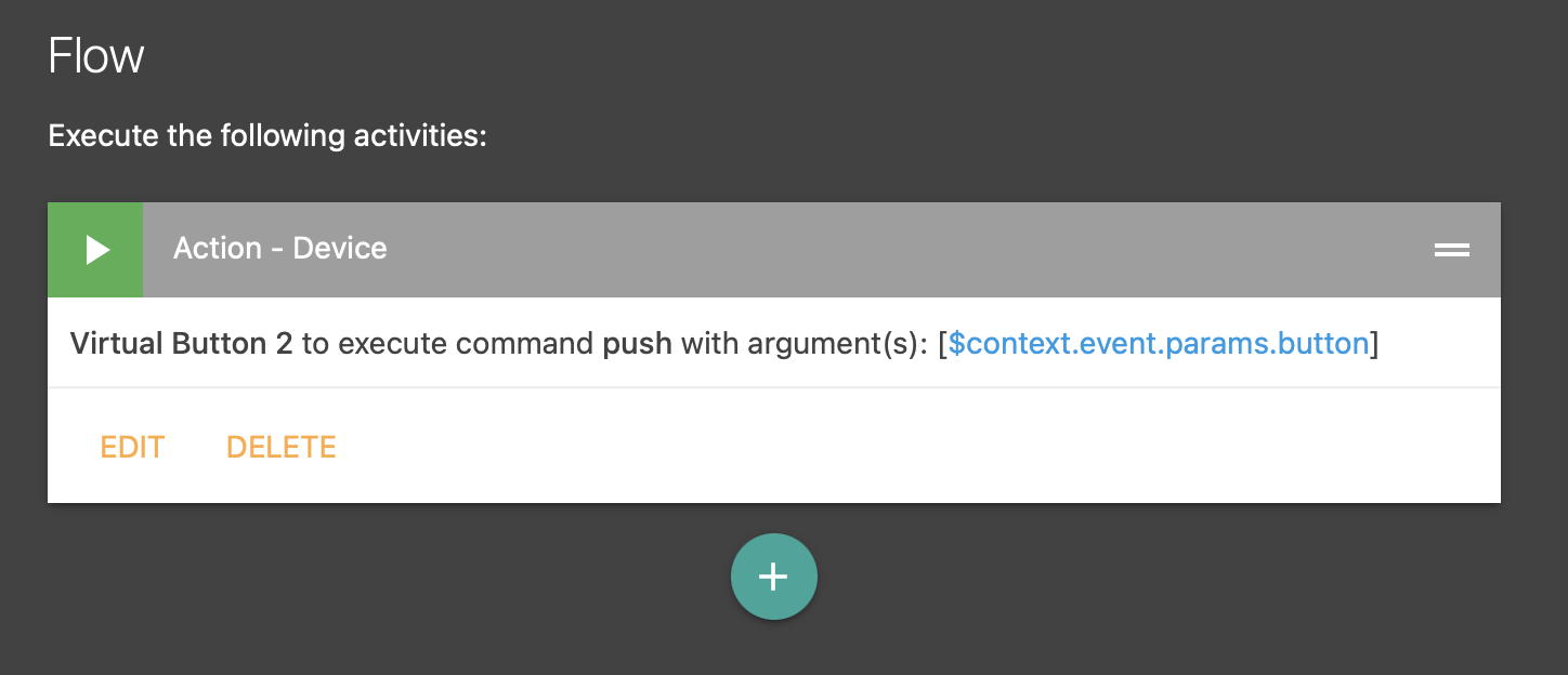

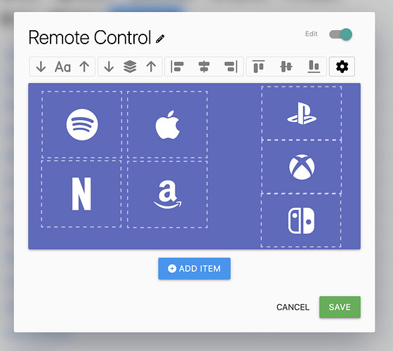

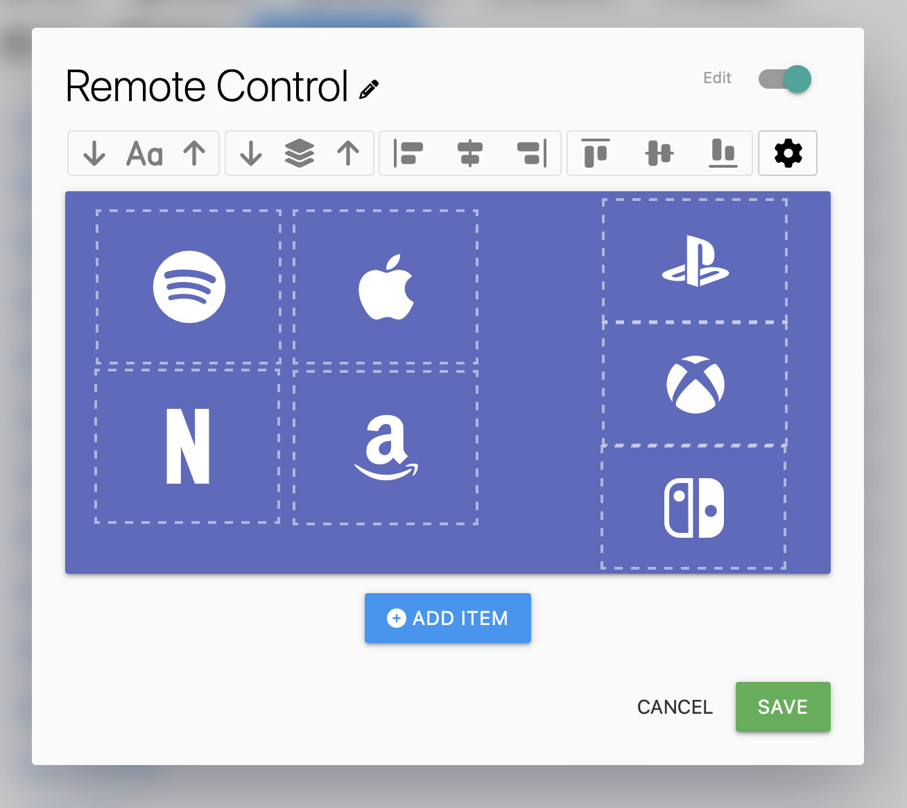

It's a bit of an advanced approach, but if you have multiple different buttons you want to be able to control (especially somewhat related to each other), I would use a Super Tile to bring all the different buttons together on a single tile.
From there, I would create a rule to make it easier to control different buttons with a parameter. If I understand how your button device works, your rule would just need a single action to call the push() command on your button and use a Context Variable (Event > HTTP > Parameter -> 'button')
You don't need any Triggers and 'button' as the parameter name is arbitrary so you can use whatever you want as long as it's consistent.
Back in the Super Tile, add a static icon or label to the Super Tile and edit it with a Hyperlink action... for the URL use a special $.runRule("RULEID", {"button": 1}) syntax where you substitute "RULEID" accordingly and the number in the 'button' field accordingly. This enables you to use the single rule we created above to change which button is 'pressed'.

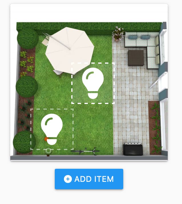

I have 8 independent circuits in my garden. I would like to have each of them on a separate button. As i did in hubitat dashboard (8 buttons from one virtual device via the corresponding "button number").
In the example I provided, each of the icons (or labels) on the Super Tile acts like its own button controlling its own circuit in your garden.

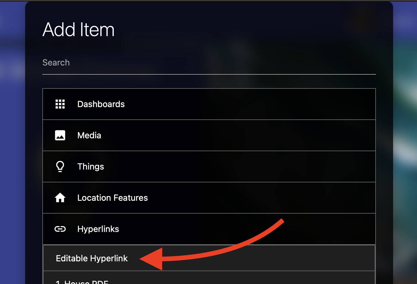

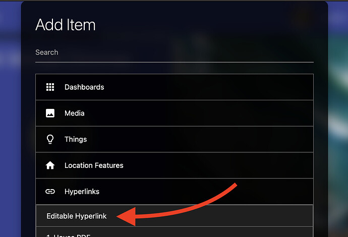

That being said, you can use the same rule concept I mentioned above and if you want individual tiles rather than a Super Tile (with multiple garden circuits individually controllable on a single tile), you can use the Hyperlink Tile with the same $.runRule() syntax mentioned above.
You can use the Editable Hyperlink so you don't have to create a Hyperlink resource in advance and you can just edit the URL to modify the $.runRule() syntax directly.
One of the really neat features of the Super Tile is you can control multiple devices (even different devices) from a single tile. And you could even upload an image of your garden as an 'icon' and move it to the lowest layer of the tile like a background and then add icons/labels on top of that so you have a nice visual layout of your garden.
