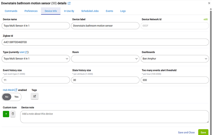

Hey there @kkossev I'm hoping you can assist me please.
I'm trying to get this wretched device to work...
It pairs almost instantly, using your 4-in-1 driver. I was happy!!! :slight_smile:
However, I'm not getting any motion activity.
Trawling the threads here I saw reference to your mmWave driver so I'm also tried that, unfortunately also without success.
I am sad!!! :frowning:
Any ideas what I can try next? Unfortunately I was stupid and bought a whole bunch of these duh :frowning:
Here's some screenshots of the device pages, in case they help shed some light on the problem...
Hi Angus,
First, make sure you are on the development branch version of the Tuya mmWave Sensors driver :
https://raw.githubusercontent.com/kkossev/Hubitat/development/Drivers/Tuya%20Zigbee%20mmWave%20Sensor/Tuya_Zigbee_mmWave_Sensor_lib_included.groovy
You can use this procedure for a quick manual update of the driver.

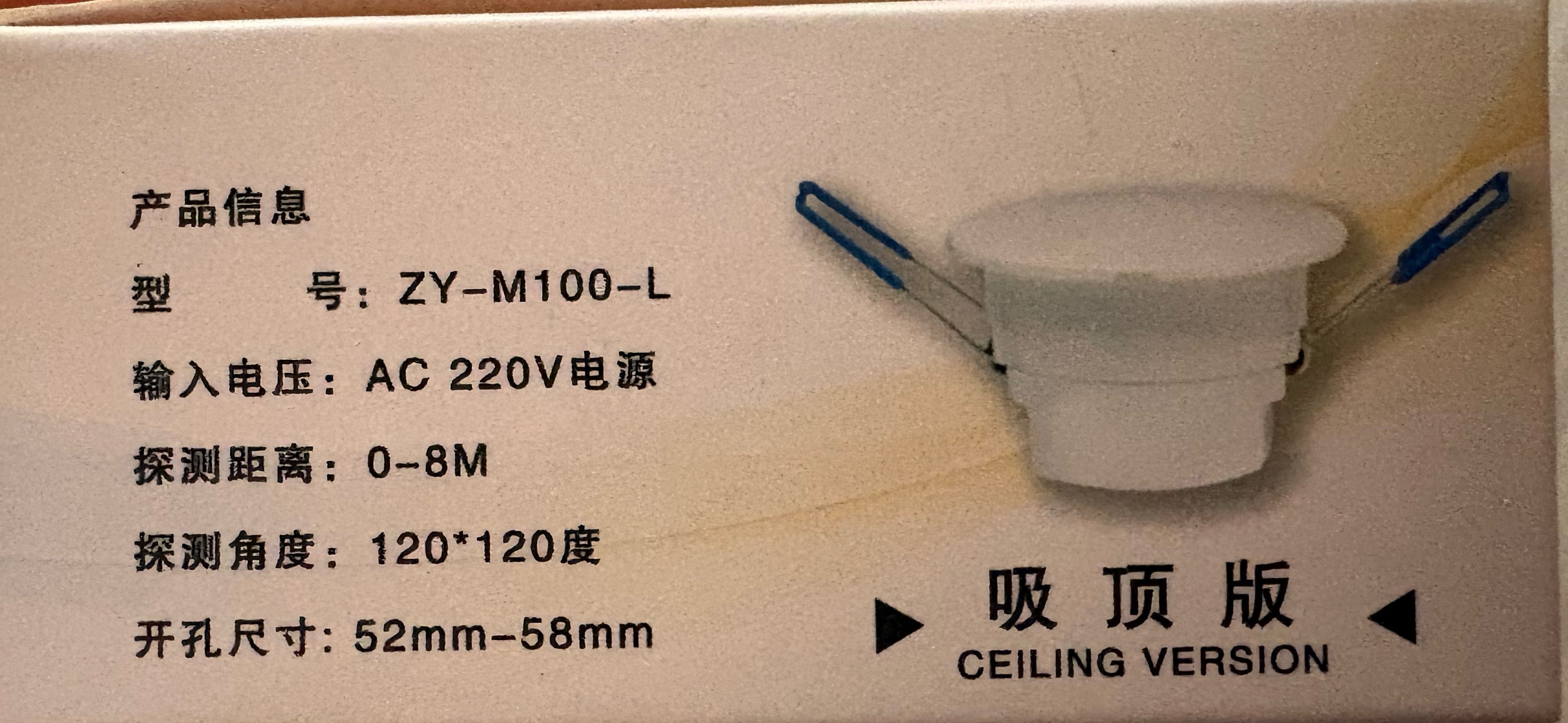

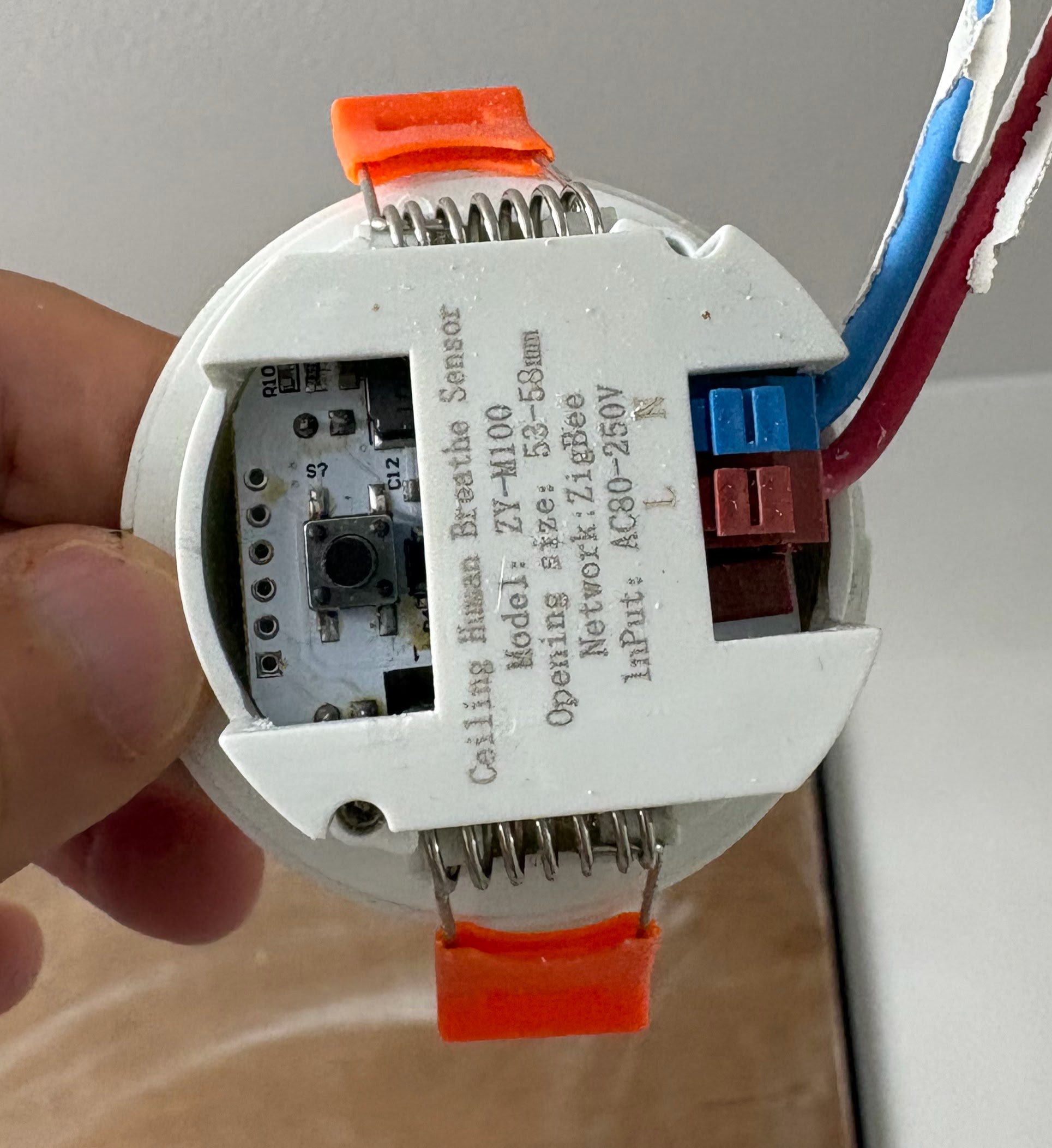

Box refers to ZY-M100-L in case it helps.
ok, thank you i will try it.
No Angus, this is a picture, just pixels... "ZY-M100-L" are just letters, numbers and dashes printed on the box... A device built on the Tuya platform can not be identified by this.
:slight_smile: ok :+1:
OMG it works!!!
You are a star :+1: :+1: :+1:
Thank you so much for all your hard work.
