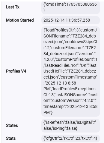

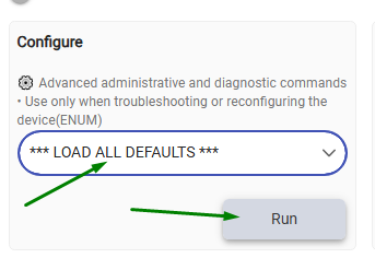

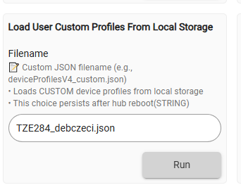

  • Save the JSON on your PC, name it as an example "TZE284_debczeci.json"
  • Use HE File Manager to upload it to HE local storage
  • Load the Custom Profile :

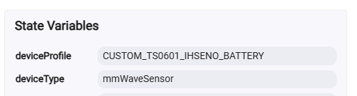

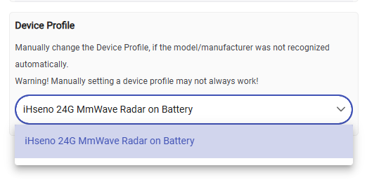

  • Select it as an active Device Profile :

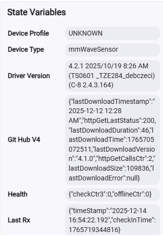

  • refresh the browser page and check whether the deviceProfile in the State Variables is the correct one :
Let me know whether it works, including changing the radarSensitivity and the fadingTime.
P.S. It was a fun time reading the AliExpress seller warnings ... :slight_smile:
:slight_smile:

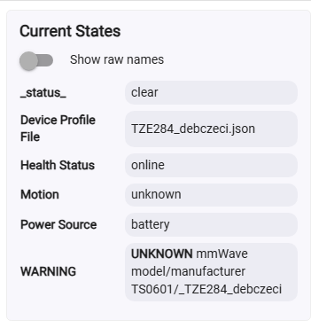

Did you go through these steps?
Selected again and now it looks better. Motion inactive but motion started shows correct time/date
Forced to active and now it works, thanks a lot

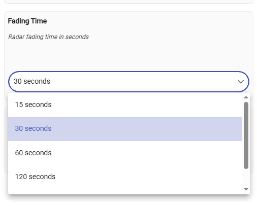

Please test whether the Preferences are working (changing the radarSensitivity and the fadingTime). If all is working OK, I will move this custom JSON 'device profile' into the standard profiles JSON.
Fading time has no effect I believe. If sensitivity is changed Motion stays for like 25 seconds, no matter the fading setting. Isn't this a presense sensor? It should stay active as long as don't leave the room. Have I understood things wrong?
What it is supposed to do and what it actually does can be very different things, especially with Tuya devices :sweat_smile:
Assuming it's not defective or has some kind of bad design issue, it will likely just take some patience and some trial-&-error with the various settings to get it performing like you want it to.
Medium and 15seconds. States say 0 for both.

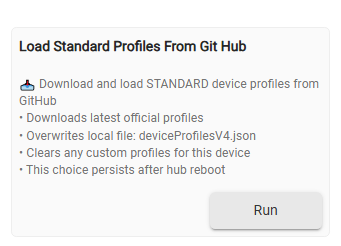

No, it shouldn't work this way - the local copy of the "deviceProfilesV4_mmWave.json" on Hubitat Storage should not be automatically overwritten on the hub restart. The driver shoud only read the JSON file from the local storage on every hub reboot.
However, accidentaly clicking on this button will owerwrite your local copy :
As an emergency restore option - the latest 'hardcoded' device profiles V3 version is 3.5.2, it can be installed from this Google Drive archive link: (old version 3.5.2 link).

Load the Standard Profiles from GitHub again :

Driver version 4.2.1
Thanks.
TS0601 _TZE204_fwondbzy should be recognized automatically when paired as a new device.... Did you have this driver already installed when you paired the device for the first time?
Select 'Load All Defaults' from the Configure drop-down menu and click on the Run button :
I had older version.
I just updated to the new version.
