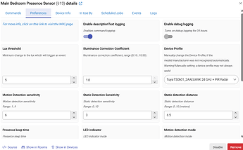

Can you use the setPar() command to test changing the fadingTime and the two different sensitivity settings individually? These are the most important settings (together with the maximumDistance).

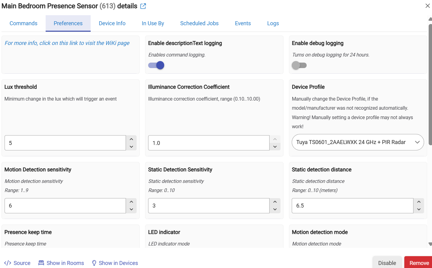

Hi Krassimir,
I continue to test in ''manual' mode ('Switch On Time' value should be irrelevant in this mode) but this appears to stop some operation of the sensor, or the sensors reporting.
If I use the [setPar() command] to change a parameter like 'radarSensitivity' then the changed data will not appear in 'Current State', unless the 'Manual/Auto' switch is toggled & saved.
With the mode set as 'Manual' - I have also seen random data appear in 'fadingTime' such as -264 and I saw that the sensor stopped reporting after some hours.
I really do not understand what 'fadingTime' is supposed to be doing. I thought it was a time period that was applied, once the sensor stopped detecting motion but unless the sensor is starting this 'fadingTime' before it sends 'Inactive' I don't think it's applying a fixed time period..

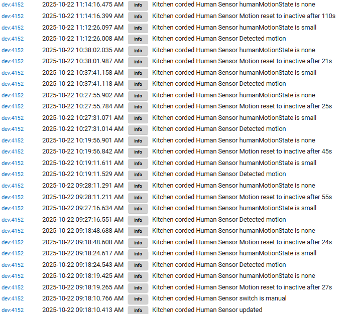

Hi,

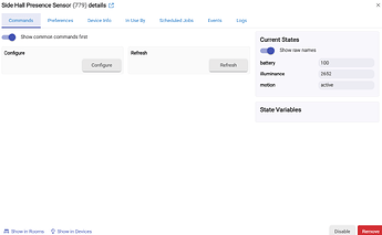

I finally had time to do some testing too, updated driver to 4.2.1 and json to 1.0.2 and i'm kinda seeing the behaviour @njanda is seeing.
Does your presence sensor behave correctly in detecting presence?

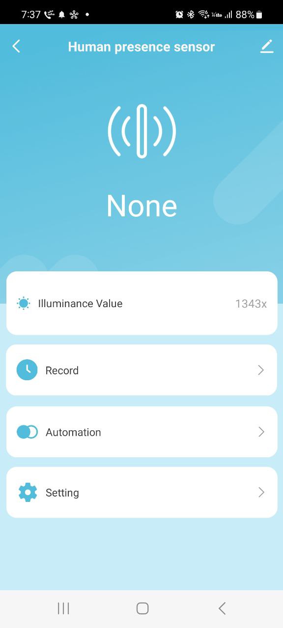

I finally had time to test the sensor in a real environment and it's barely detecting large movement (only when really close to it) and both sensitivity parameters change but it seems they do nothing. Plus, it behaves more like a movement sensor than a presence sensor: if i stand still it stops detecting me almost immediately.
Had a LINPTECH sensor in the same position and it was working flawlessly.
Unless there's some kind of magic in the parameters settings, i guess that this mmwave sensor is kinda bad.
As a last resort, i think i will try with a tuya hub and see if it starts behaving differently, plus i can sniff the datapoints in case they are not like the ones in here : zigbee-herdsman-converters/src/devices/neo.ts at master · Koenkk/zigbee-herdsman-converters · GitHub

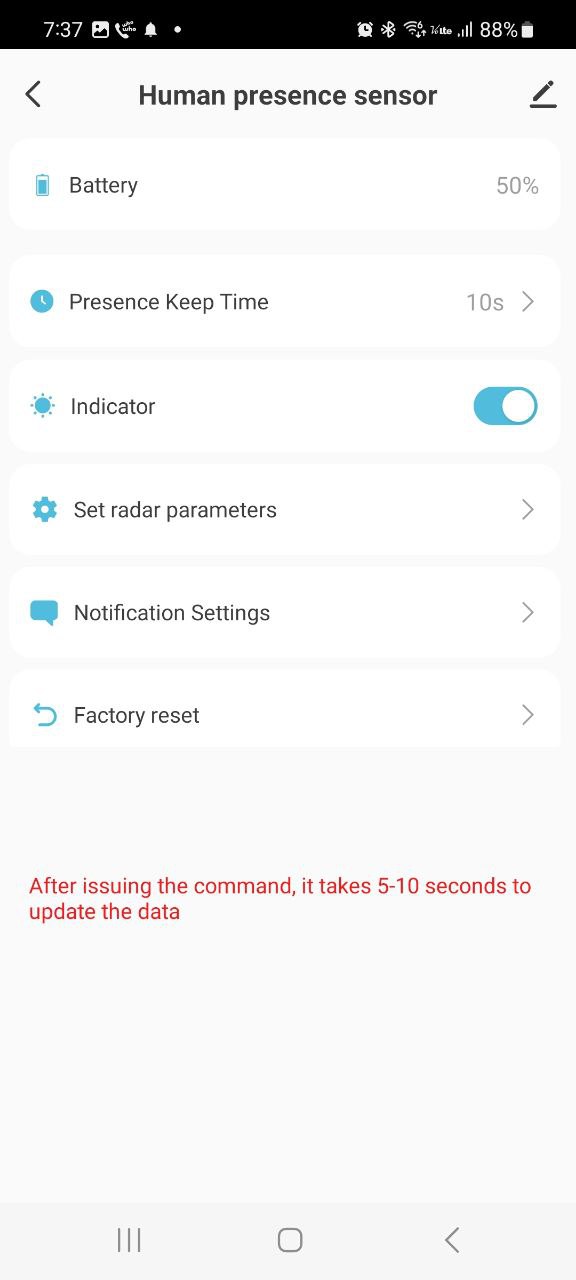

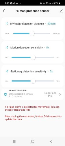

@njanda done some more testing and my device is working like it should, even illuminance is sent according to the table (in lux steps, not actual lux).
The only strange thing that got me previously was that sensitivity is working backwards, where 0 is more sensitive and 7 is very very low.
I was making the assumption that the higher the value the higher the sensitivity and got caught in a loop.

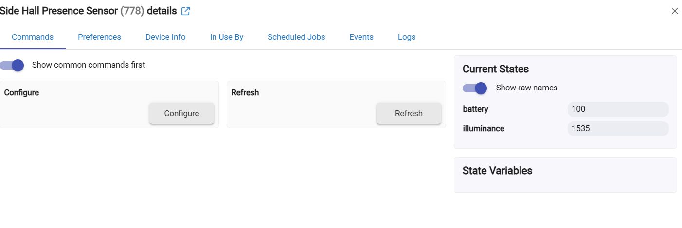

@kkossev The only issue now is that the only effective way to be sure that a parameter is actually set on the device is the setPar function, cause saving preference for some strange reason makes this device not setting all preferences.
I will collect more logs and paste in here later.
Andrea,
Yes my detector is reliable at detecting presence. Sometimes crazy sensitive ! Catching my dog yawning in his bed 5m behind me while I'm experimenting with settings.
Able to detect large movements (stand up) as well as slight finger movement on mouse but what I'm noticing is that this movement detection, seems to change with "time since last detection". I suspect it takes a large movement to 'wake' the sensor and then after that it is in a 'watch for small movement" mode, or such.
It's great that you also think the sensitivity is reversed because I've kept doubting myself but then my testing would always suggest it again.

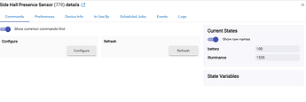

I'm not seeing luminance data coming through at all. Steps of Lux would probably work for me, otherwise I will just use 'time of night' to alter my bathroom light dimmer. (I hate 100% lights on at 3am !)

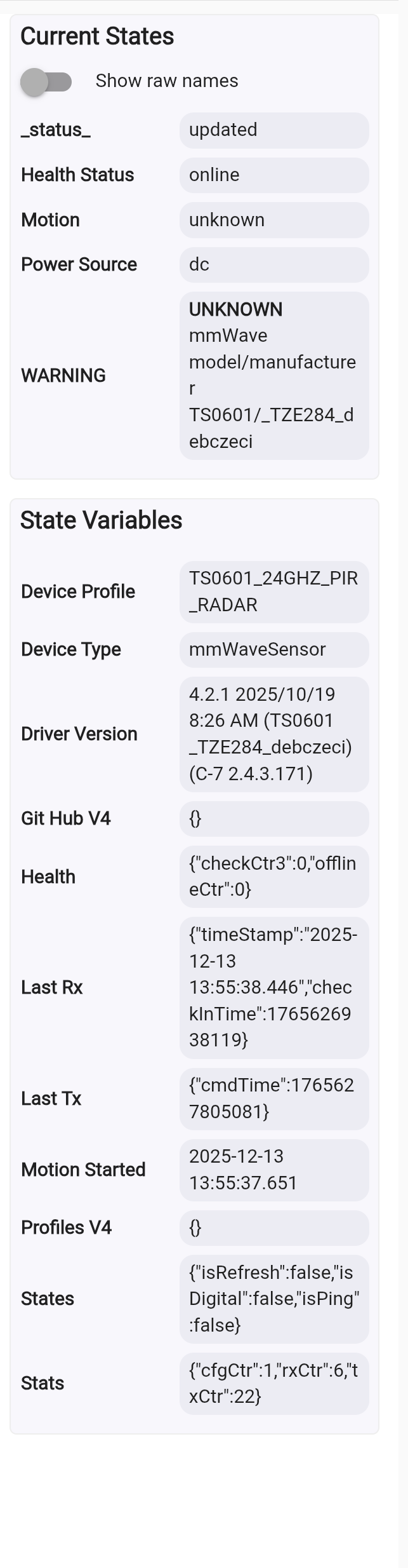

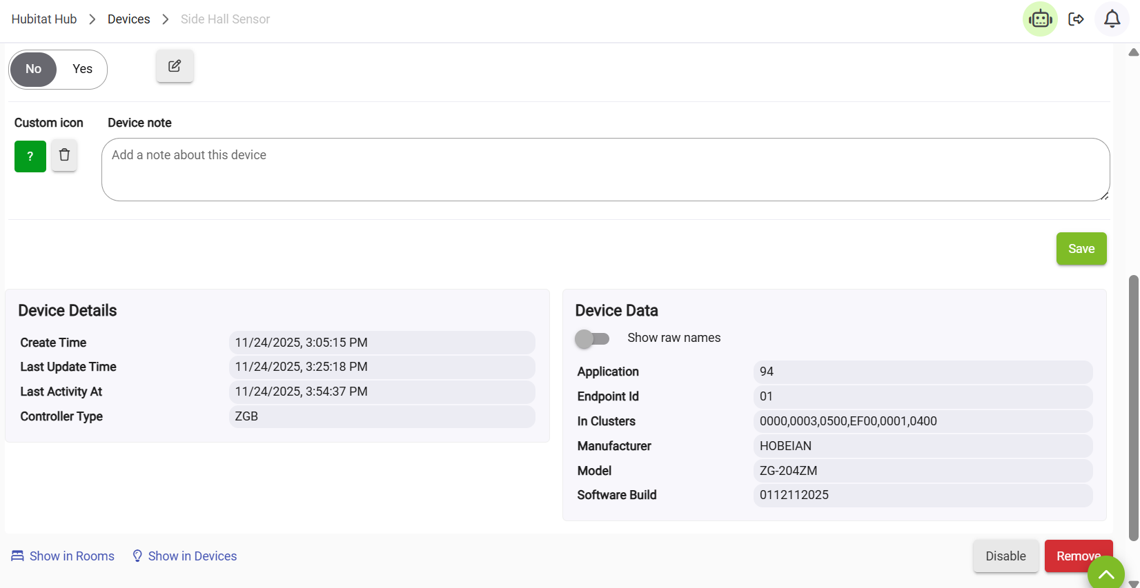

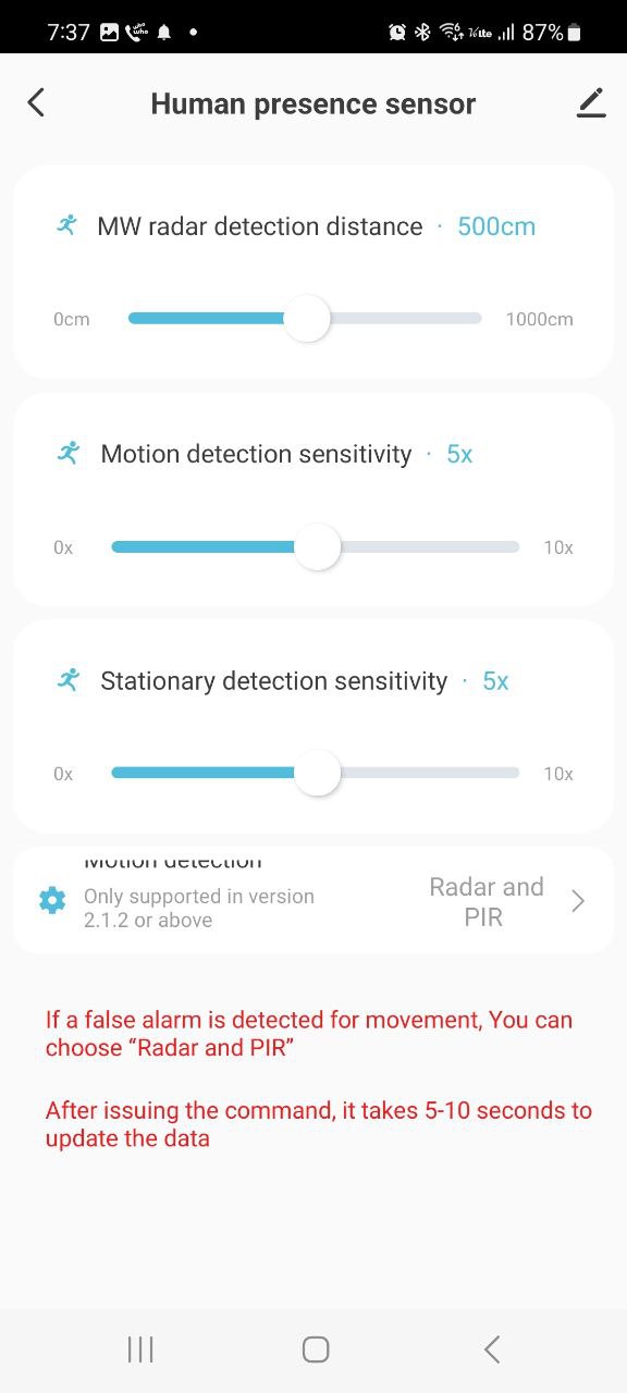

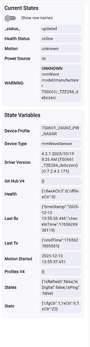

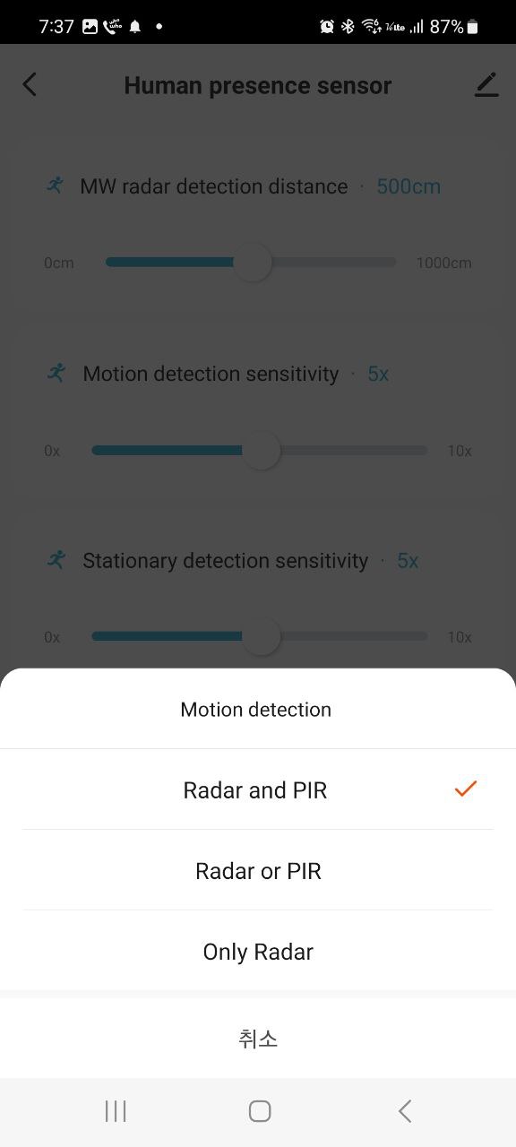

Hi, kkossev
Long time no see. Is it possible to register a new device now?
Device Data
Show raw names
Application 93
Endpoint Id 01
Manufacturer _TZE200_kb5noeto
Model TS0601
Tuya Version 2.1.3
https://ko.aliexpress.com/item/1005006755689614.html?spm=a2g0o.order_detail.order_detail_item.3.1eb05ccdk1dzE4&gatewayAdapt=glo2kor
Summary

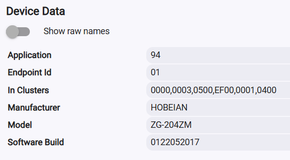

Hi @kkossev,
One of my Tuya Zigbee Human Presence Detectors recently joined the great device pile in the sky, so I purchased a new one. When I paired the new one, it didn’t pick up the correct driver—actually, it didn’t pick up any driver.
I checked my other two sensors and realized this was one of those cases where I had to manually select the correct driver (which, in classic fashion, I had completely forgotten). I switched it to Tuya Zigbee mmWave Sensor, hit Configure to load defaults, and then headed to Preferences to select the right model… only to discover it wasn’t listed.
Naturally, I assumed I must be behind on updates. I ran HPM, didn’t get an update, and that’s when it dawned on me that I had absolutely lost track of the proper steps to match this sensor to the correct driver. A quick dive into the forum and GitHub did not help—if anything, I managed to thoroughly confuse myself.
If you could kindly set me straight, I’d be very grateful. Below are my details (hopefully correct… unless I messed those up too—wouldn’t be my first time :man_facepalming:).
Driver Version (per HPM): Tuya Zigbee mmWave Sensor v3.5.1

Device Data
Application	    94
Endpoint Id	    01
In Clusters	    0000,0003,0500,EF00,0001,0400
Manufacturer    HOBEIAN
Model	        ZG-204ZM
Software Build	0112112025
I’m sure I’m missing one or two obvious steps (my specialty), so any guidance or a quick refresher on how to ensure I’m using the correct driver would be greatly appreciated.

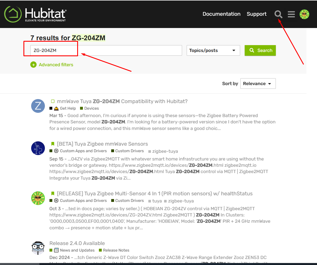

Hi David,
I’ve updated the first post in this thread so others looking for information on how to update the driver can easily find it as well :

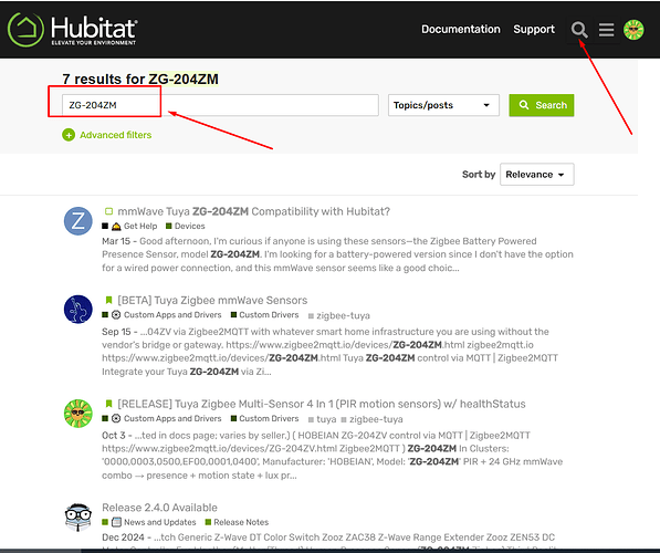

Searching the forum for "ZG-204ZM" shows some information,
and one of the links shows that your device may be natively supported in HE!

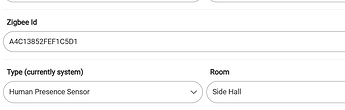

Can you please try the HE inbuilt driver and let us know whether it works OK with your device?

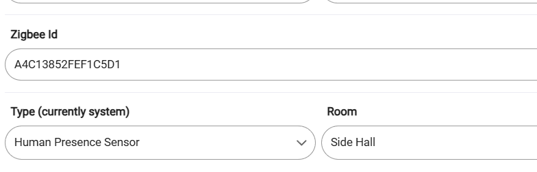

The name of the system driver is "Human Presence Sensor"

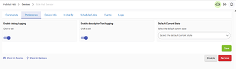

Thank you so much for the detailed response — I really appreciate you taking the time to update the thread and point me in the right direction.
I followed your steps as suggested. I first cleared out the Current States and State Variables using the "device" driver as I always do when replacing a driver. After that, I switched over to the Human Presence Sensor system driver, closed and reopened the device page, and then ran both Configure and Refresh (with another open/close cycle just to be sure everything loaded cleanly).
These were the results I saw:
Based on what I’m seeing, it doesn’t appear that the built-in driver is fully compatible with this particular device — at least not with the model I have.
One quick question for you:
Does the 4.2.x driver you’ve written include the correct fingerprint for this device, or should I be selecting a specific model/variant after updating?
Thanks again for all your work on this. Your guidance saves a lot of head-scratching on my end!

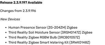

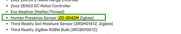

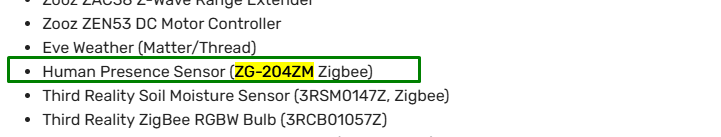

ZG-204ZM model is explicitely shown as supported in Hubitat release notes :

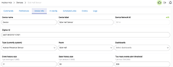

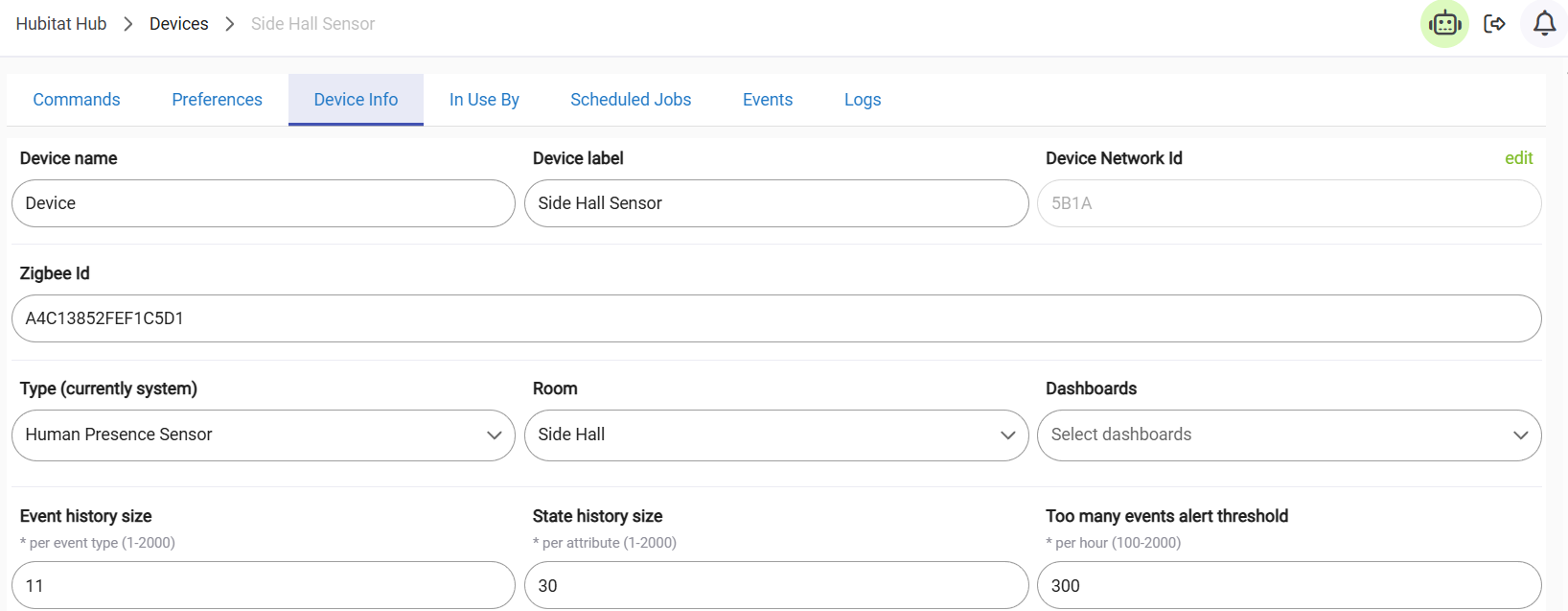

Hi @kkossev,
Thanks again for your help — and for your patience. I reached out because I’ve got two similar sensors (TS0601_24GHZ_PIR_RADAR) and I genuinely thought this one was part of the same little Tuya family reunion you’ve been supporting with some quick code changes over time. Turns out I was a bit of a noodlehead on that assumption. :sweat_smile:
Just to close the loop on my end:
I removed the device, started fresh, and paired it again. Hubitat didn’t find a matching driver, so it went straight to the generic “Device” driver — the one that lovingly wipes Current States and State Variables clean. I then switched it over to the Human Presence Sensor driver, paired (and paired it again just for fun ) as you suggested… still no luck.

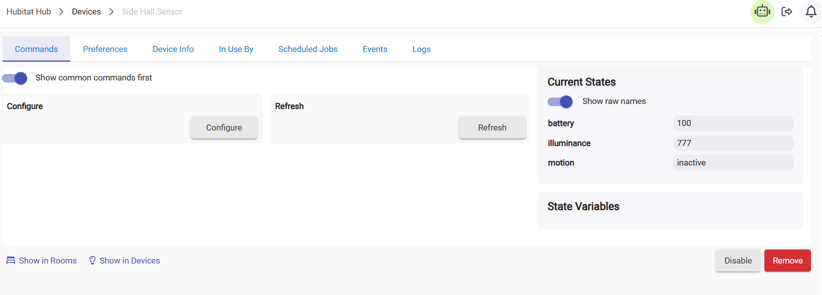

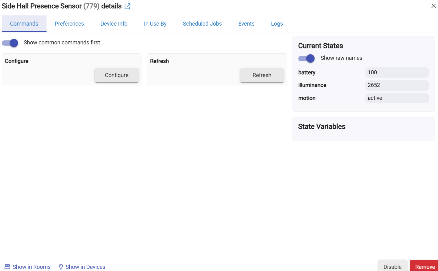

The Commands, Preferences and Defice Info look like what I posted earlier.
Current States shows only the raw basics:
  • battery: 100
  • illuminance: 1457
  • motion: active
…and no State Variables at all.
This is what debug tells me but its not clear to me what it means
[dev:779](https://192.168.1.51/device/edit/779#)2025-11-24 04:11:45.658 PM
debug
skipped:[raw:catchall: 0000 8021 00 00 0040 00 A30B 00 00 0000 00 00 0900, profileId:0000, clusterId:8021, clusterInt:32801, sourceEndpoint:00, destinationEndpoint:00, options:0040, messageType:00, dni:A30B, isClusterSpecific:false, isManufacturerSpecific:false, manufacturerId:0000, command:00, direction:00, data:[09, 00]]
[dev:779](https://192.168.1.51/device/edit/779#)2025-11-24 04:11:43.688 PM
debug
skipped:[raw:catchall: 0000 0013 00 00 0040 00 A30B 00 00 0000 00 00 180BA3D1C5F1FE5238C1A480, profileId:0000, clusterId:0013, clusterInt:19, sourceEndpoint:00, destinationEndpoint:00, options:0040, messageType:00, dni:A30B, isClusterSpecific:false, isManufacturerSpecific:false, manufacturerId:0000, command:00, direction:00, data:[18, 0B, A3, D1, C5, F1, FE, 52, 38, C1, A4, 80]]
Yes, it’s definitely a battery-powered Zigbee device.
I did see now where it does say
But I guess not all Human Presence Sensor (ZG-204ZM) Zigbee devices are created equal.
I went through the other forum threads as you recommended. Your earlier comments actually made me realize I’ve reached the “officially optionless” stage. In hindsight, I really should have noticed your very valid warning: “With Tuya sensors, you never quite know what you’ll get — even if it looks identical to another model.”
I also missed the part where you mentioned that you’ve stepped back from trying to support new Tuya mmWave devices. So now I feel extra silly for bothering you with this one!
At this point, I think I’ve acquired a very fancy, very unhelpful cat toy — because while the model matches, but it’s clearly not exposing anything meaningful.
Thank you again for the guidance, the honesty, and all the work you’ve done on these drivers. I really appreciate it.

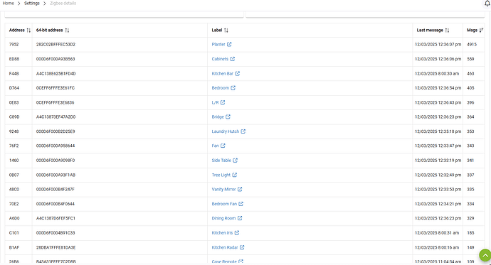

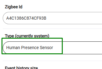

The HE inbuilt driver seems to be working - the battery, the illuminance and the motion attributes are populated in the first seconds after the pairing!
The problem is that this device does not stay connected to your hub, and leaves the Zigbee network a few seconds later. This is seen from the ZDO message (profileId:0000, clusterId:0013) - the device tries to re-join the network, most probably unsuccessfully.
If your hub is a C-7, reboot the hub and pair the ZG-204ZM at a close distance as soon as the device web page becomes available.
If your hub is C-8, use the Double Luck voodoo to pair it again.
Note, that whether a Zigbee device will stay connected or not does not depend on the device driver used (either system or custom) - the connection is handled on a Zigbee coordinator (hub system) level.
You can verify whether the device stays connected by enabling the Debug logging in the stock driver, then removing the batteries for 15-30 seconds and reinserting the batteries back. Do you see anything in the live logs?

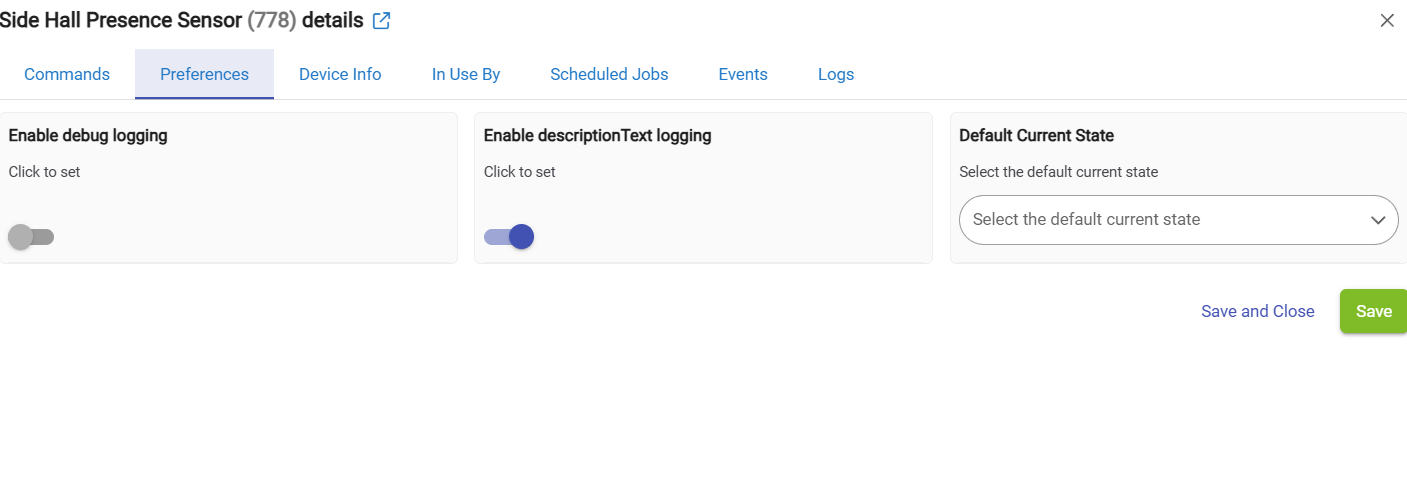

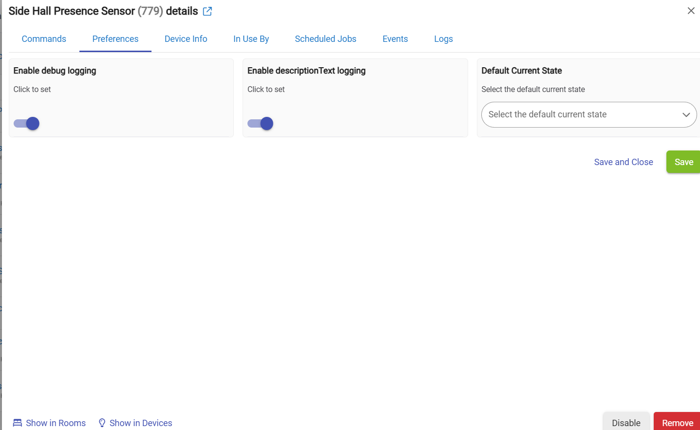

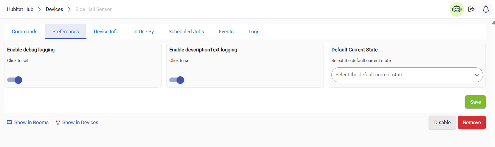

What is a bit disappointing is that the stock Human Presence Sensor driver doesn’t seem to provide any Preference options. Here’s the comparison:
Your driver’s preferences (lots of options):
Stock Human Presence Sensor driver (basically empty):
I tried pairing again this morning and got the following:

But even after re-pairing, the Preferences section is still basically devoid of options. That may simply be the full extent of what the stock driver exposes — just a slim set of attributes to work with. It is reporting motion, battery, and illuminance reliably, which is good, but I was certainly hoping for a bit more to adjust and more attributes to use in Webcore.
Stock Human Presence Sensor driver (basically limited):
