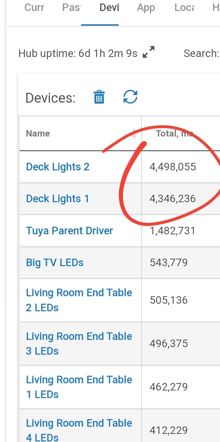

Hello Jonathan,
My deck lights are on the local connection driver and I've noticed them consistently chomping down resources:
Anything we can do to investigate this?
Even increasing the heartbeat to 60 seconds is still getting me these results. I'm wondering if something isn't unnecessarily chatting constantly.

If you turn on debug it will show exactly what it is doing. The most likely culprit are retries, if you have a recent copy of the driver there will be two attributes in it named "errors" and "retries". Command retries will definitely cause overhead.
