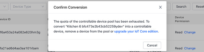

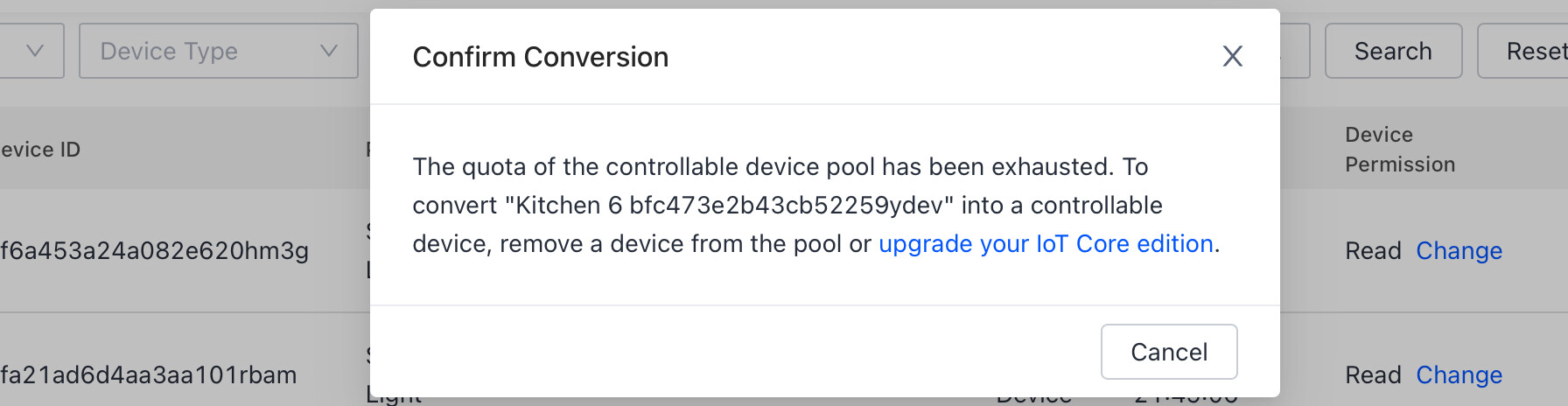

I’ve just given, this a go and it’s pretty great! Has anyone got round the 10 device limit yet?
I've been running 11 devices for over 2 years and haven't had any issues.
Interesting, mine shows more than 10 as read only, so can’t be changed, if I try and modify it, I get this message
Maybe it’s because mine are all zigbee and not WiFi?
