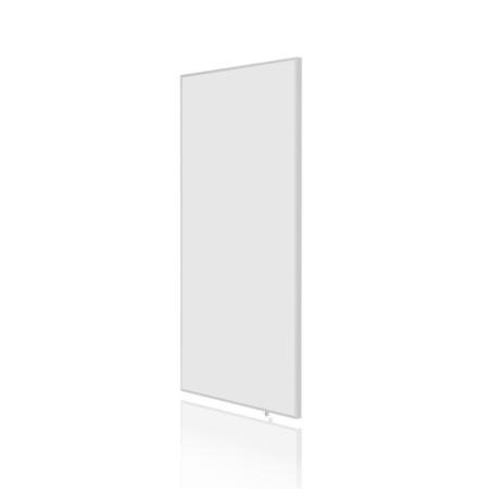

I should add here that I'm trying to get these working:
This is a slim infra-red heating panel. I didn't know it was Tuya enabled until I received the item, as an HE user I header here and searched to see if there was any integration. I'm using the panel in a holiday home so it would be awesome if I could get it working.
