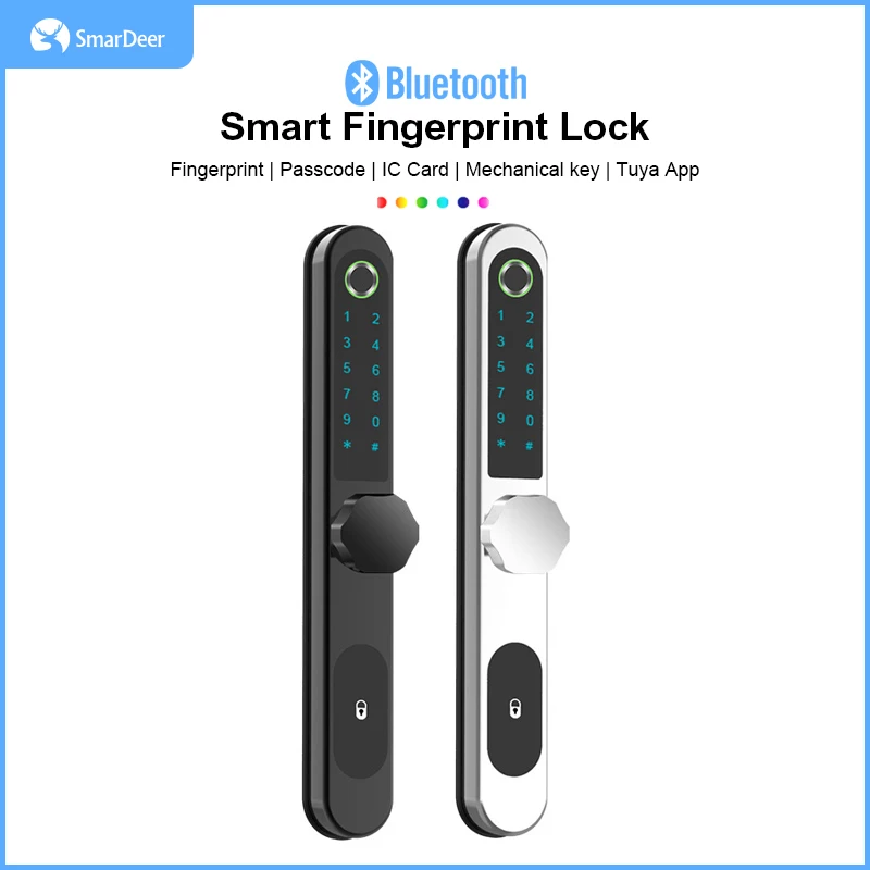

Did you manage to get your Tuya lock working with HE? I'm having some sliding doors fitted and have been struggling to find a smart lock for these. I found some Tuya options but not sure if it would be feasible to get them working with HE using this integration.
SmarDeer BT Smart lock for Tuya Broken bridge fingerprint lock Biometric Fingerprint handle for Sliding door with Bluetooth
