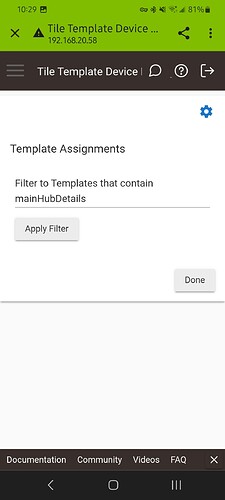

I deselect and re select device. This is what I get in the apply template page.

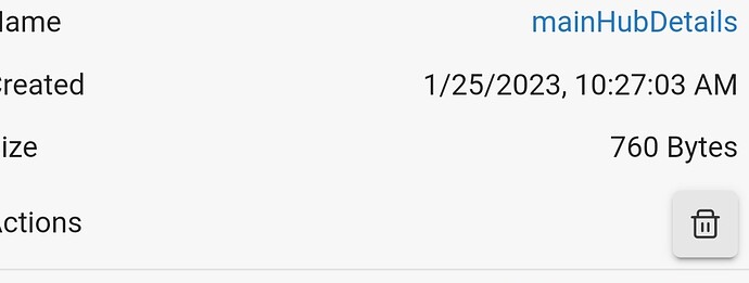

I also do indeed see it in file manager
if you click off the input and then click the Apply Filter it should populate the drop down for the slot. Try a shorter version of the name and see if the capitalization or something is the issue
Nope no change. Tried all types of versions of the name clicked off input etc.
Even if you leave that field blank it should give you the option to do a match up for the device... Let's go to the first page and click Clear Previous Settings, and then after the screen refreshes re-add the device, and see if we get different results. If not we may want to do a HPM Repair on the app.
Did all that and I still get the same problem. Also did a repair.
