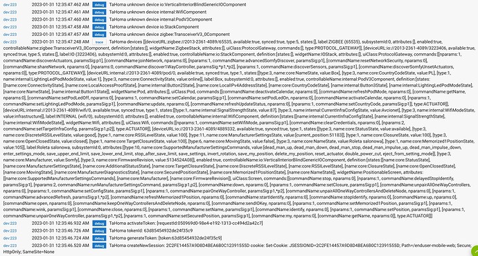

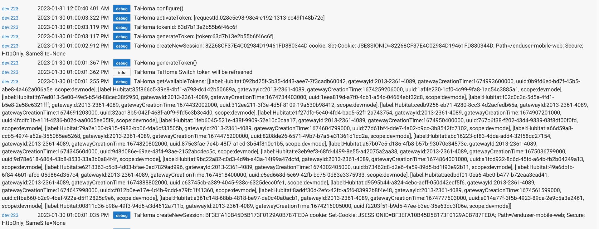

Hi there, I'm new to HE. I'm struggling with Somfy Blinds - tried to follow the guideline but finally got only the following log (and nothing more happens).
TaHoma activateToken: [requestId:e3a638ab-98e4-e192-1313-cc49b7aca393]
TaHoma tokenId: 63cfc83f89b4fc42aa2a
TaHoma generateToken: [token:63cfc83f89b4fc42aa2a]
TaHoma createNewSession: 28E76B50815504E52A831C64BA252B36 cookie: Set-Cookie: JSESSIONID=28E76B50815504E52A831C64BA252B36; Path=/enduser-mobile-web; Secure; HttpOnly; SameSite=None
TaHoma generateToken()
TaHoma TaHoma Switch token will be refreshed
TaHoma getAvailableTokens: [[label:Hubitat:372c969e-04fc-4a84-b1ed-1b2b94d40e60, gatewayId:2013-2361-4089, gatewayCreationTime:1674172798000, uuid:19bc18a6-7cf9-4510-8749-4b5abf5a291b, scope:devmode], [label:Hubitat:85f866c5-39e8-4bf1-a798-dc142b50689a, gatewayId:2013-2361-4089, gatewayCreationTime:1674259206000, uuid:1af4e230-1cf0-4c99-9fa8-1ac54c3885a1, scope:devmode], [label:Hubitat:c8d69e8f-2c58-4ed3-9999-d27510dcdbf1, gatewayId:2013-2361-4089, gatewayCreationTime:1674076473000, uuid:22cf2147-48ae-4495-a572-848880878b35, scope:devmode], [label:Hubitat:a2cc4dbe-8992-4b10-8bc4-cb51a736c6bf, gatewayId:2013-2361-4089, gatewayCreationTime:1674076471000, uuid:312cf9bb-7754-4519-b079-38ec8a6eb811, scope:devmode], [label:Hubitat:f02c0c3c-5d5a-4fd1-b5e8-2e58c6321fff, gatewayId:2013-2361-4089, gatewayCreationTime:1674432002000, uuid:312ee211-3f3e-4d5f-8109-19a630b98412, scope:devmode], [label:Hubitat:d182634f-9838-4071-97a9-d42e9b3b6533, gatewayId:2013-2361-4089, gatewayCreationTime:1674075527000, uuid:377c1c6e-54e0-4bad-a972-b829133224eb, scope:devmode], [label:Hubitat:1590aeda-f9b7-4997-95fe-69a32dc32849, gatewayId:2013-2361-4089, gatewayCreationTime:1674077140000, uuid:44793ea7-8b21-4991-a213-88b614c5f42b, scope:devmode], [label:Hubitat:a0641c25-8722-4359-897c-a74fb22da22e, gatewayId:2013-2361-4089, gatewayCreationTime:1674077287000, uuid:48f786f0-fbc4-440d-b3a5-1117099a9d4c, scope:devmode], [label:Hubitat:b2a263d0-516f-4714-aa13-15f9bcccde21, gatewayId:2013-2361-4089, gatewayCreationTime:1674075238000, uuid:50d5ca68-e353-4317-a1df-34820fa8d7d3, scope:devmode], [label:Hubitat:0aecf9dc-870d-4d49-88ee-2ec446f8d16a, gatewayId:2013-2361-4089, gatewayCreationTime:1674129598000, uuid:5d7aa9d9-76dc-4825-94c7-0dfe2c48b1a3, scope:devmode], [label:Hubitat:b09b230f-d015-46e9-8210-199d95d85e2f, gatewayId:2013-2361-4089, gatewayCreationTime:1674077139000, uuid:60206ad1-2c44-4b5a-876d-e9a7390e9b35, scope:devmode], [label:Hubitat:a66d59a8-ccb5-4974-a62e-355065ee5268, gatewayId:2013-2361-4089, gatewayCreationTime:1674475200000, uuid:8208de26-6571-49b7-b7a5-e31361d1cd2a, scope:devmode], [label:Hubitat:7ed14b51-8304-4497-9a03-d57ea4f22bf4, gatewayId:2013-2361-4089, gatewayCreationTime:1674075496000, uuid:8795e4e5-5edc-4add-b5f9-66a0d70ae08b, scope:devmode], [label:Hubitat:a67b07e5-d186-4fb8-b57b-93070e34573e, gatewayId:2013-2361-4089, gatewayCreationTime:1674345604000, uuid:948d086e-69ae-43f4-93ae-2152abc4ec5c, scope:devmode], [label:Hubitat:e6218363-c5c8-4d03-bfae-0ad7829ad996, gatewayId:2013-2361-4089, gatewayCreationTime:1674302405000, uuid:b73462c8-d2e6-4a59-89d5-bd1f93e92b11, scope:devmode], [label:Hubitat:47e01e40-472f-41cf-ba38-dd7b0463c9d2, gatewayId:2013-2361-4089, gatewayCreationTime:1674086399000, uuid:c13ab93d-32fc-4b36-b835-72a37495da70, scope:devmode], [label:Hubitat:49a6dbfb-6f84-4601-afcd-05d864d357c4, gatewayId:2013-2361-4089, gatewayCreationTime:1674518400000, uuid:c5ed668d-5c69-42fb-bc75-0d83e3375933, scope:devmode], [label:Hubitat:aedbdf01-0ea6-4bc0-b477-b72caa3cad41, gatewayId:2013-2361-4089, gatewayCreationTime:1674388802000, uuid:c63745cb-a389-4045-938c-6325decc0fe1, scope:devmode], [label:Hubitat:bef48f70-6885-40b0-8146-e3e1099397d2, gatewayId:2013-2361-4089, gatewayCreationTime:1674077302000, uuid:f060dc20-658e-4ad7-a817-d2781f31b1bc, scope:devmode], [label:Hubitat:00811d36-b98e-49f3-94d6-e3d4612a711b, gatewayId:2013-2361-4089, gatewayCreationTime:1674216005000, uuid:f2203f51-b9d5-47ee-b3ec-35e63dc3f06e, scope:devmode]]
TaHoma createNewSession: EEBF8A2737478069F6937018DD5760B6 cookie: Set-Cookie: JSESSIONID=EEBF8A2737478069F6937018DD5760B6; Path=/enduser-mobile-web; Secure; HttpOnly; SameSite=None
TaHoma activateToken: [requestId:e1130eb4-98e4-e192-1313-cc4910ab0503]
TaHoma tokenId: 63cf1f8069857a95b145
TaHoma generateToken: [token:63cf1f8069857a95b145]
TaHoma createNewSession: BE57AAD744EE2EF252E596CAD8B2A274 cookie: Set-Cookie: JSESSIONID=BE57AAD744EE2EF252E596CAD8B2A274; Path=/enduser-mobile-web; Secure; HttpOnly; SameSite=None
Roleta unknown device io:VerticalInteriorBlindGenericIOComponent
Roleta unknown device internal:WifiComponent
Roleta unknown device internal:PodV3Component
Roleta unknown device io:StackComponent
Roleta unknown device zigbee:TransceiverV3_0Component
@user4198 could you share your logs? Specifically the section with the io:VerticalInteriorBlindGenericIOComponent in it? You'll need to turn on Trace in the log settings.
If I can see how the io component is described I might be able to get it working. I can't really test it locally as I only have RTS components.
Thank you for your answer.
I did as you suggested (I hope...).
@user4198 thanks, will take a look. I think it will be easy to get open/close working.

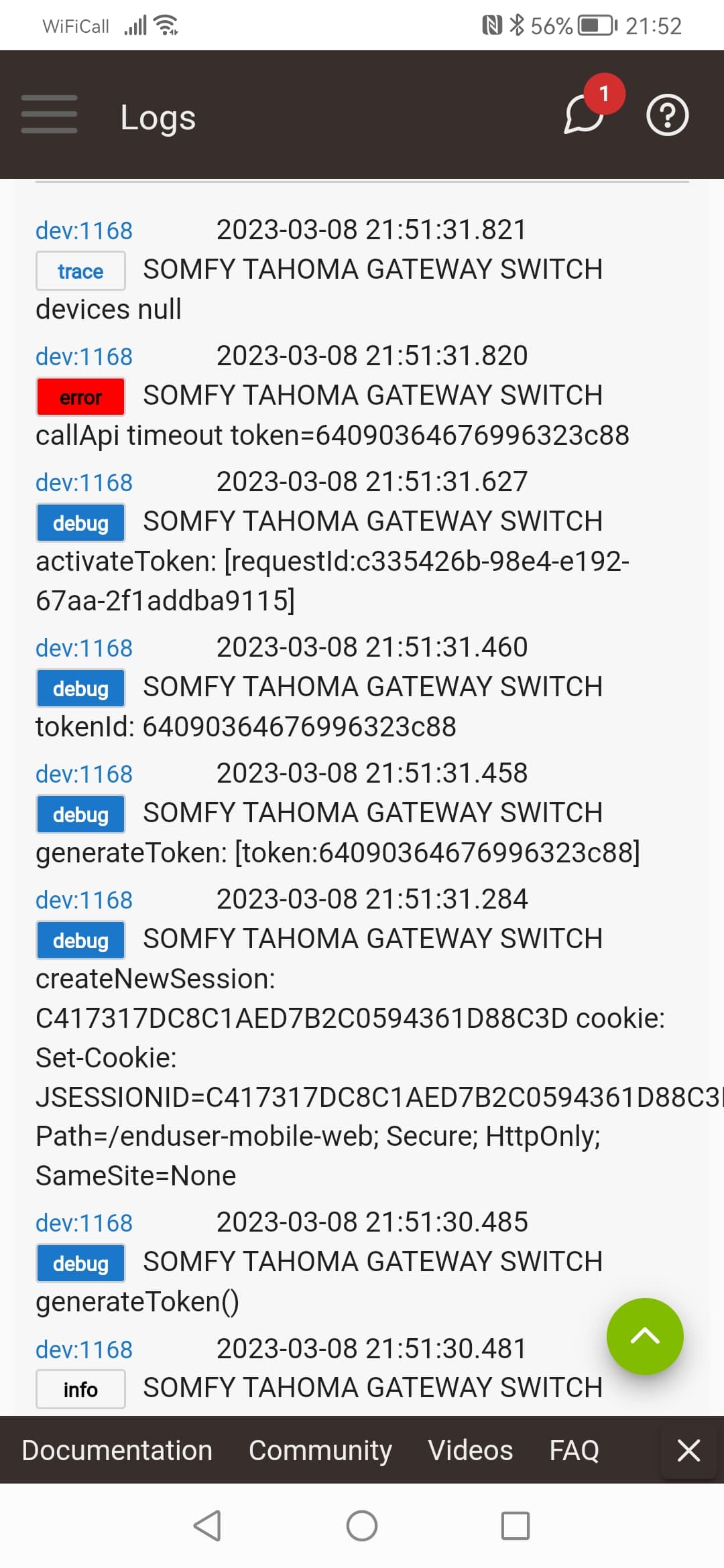

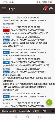

Hi @keithw. I was wondering if you could offer another spot of help. My blinds have been working great until today. I don't know if it's a coincidence but upon them not working, I also noticed a TAHOMA app update was available, so I've since downloaded the update but that's not resolved the issue. I've also registered and refreshed device but to no avail. See logs below which are a bit lengthy but I'm sure it will mean something to you. Thanks in advance...Stu

@stueyhughes I just updated my Tahoma switch to see if I get the problem... and I did! I clicked "Register" in the TaHoma device and that fixed it.
I can't be sure, but clicking "Refresh Devices" might break automation in some circumstances, so might be worth clicking Open/Close on an RTS child device to test if it starts working.
I also fixed a big in the error logging to provide more info.
Thanks Keith, Im now away from home. Do you think this is linked to the latest Tahome update or something different. Very frustrating either way. In any event, thanks for you help and swift response. I'll keep you posted when Im home to test my blinds..... Stu
Spot on Keith. All working brilliantly yet againπ Appreciated your help
