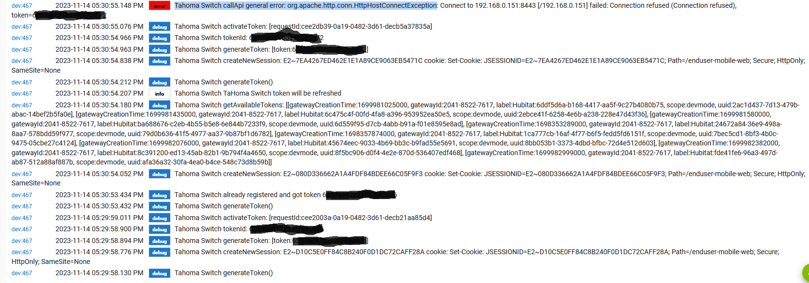

I've been successfully using this integration for some time but it has now stopped working. I wonder whether someone could point me in the right direction to debug and get it working again? Below are the logs.

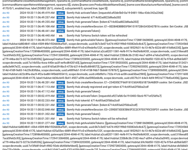

Hi Keith and User4198 ... i was reading your exchanges with interest, as I seem to be in the exact same situation.
Latest driver installed, virtual device added, login/passowrd/PIN working, registered and token generated with success. But after "refresh devices", the blinders aren't added in Hubitat.

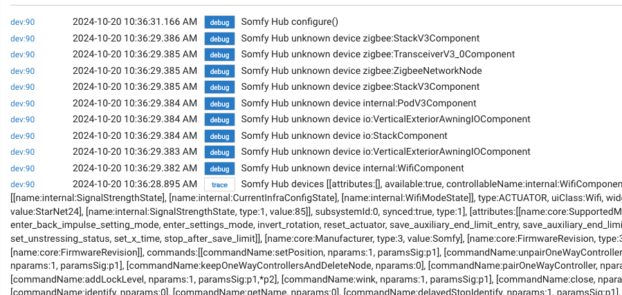

The driver only supports RTS devices (as I that is what I have and I can only test what I have). Are your blinds RTS? Based on the last screenshot, I'm guessing not? Someone will have to contribute to this driver that has other types of Somfy devices other than RTS...
Wow! You're still on! Thanks for responding this fast - much appreciated!

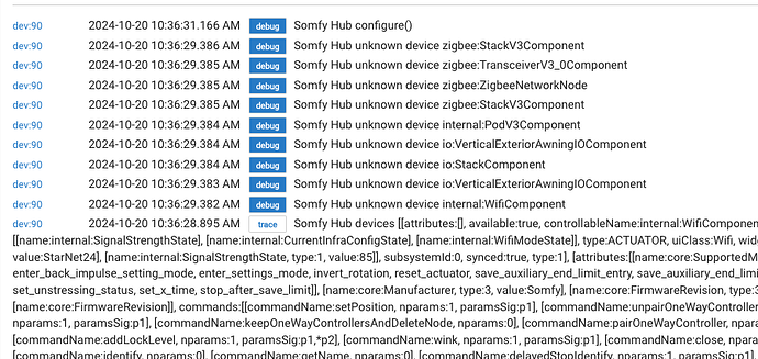

Well, yes, for now I have 2 RTS Somfy blinds installed. They work perfect on Somfy Tahoma appli (iphone) and the log above is what I get after giving it several rounds (I mean, quite several!) to get it working...
It's beyong my level to understand why I get "unkown device zigbee" but it is not necessarily the somfy blinds - I have many zigbee devices around the house (and z-wave). unrelated and not registered on the Tahoma.
I'm quite lost... hope i can join Tahoma on Hubitat, but seems a notch in jeopardy....

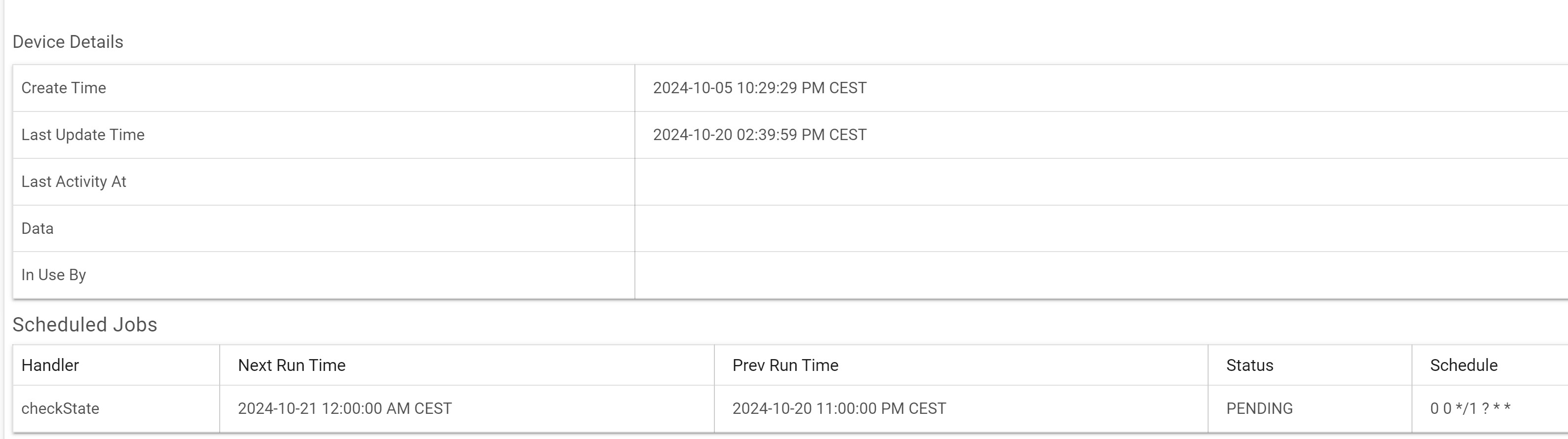

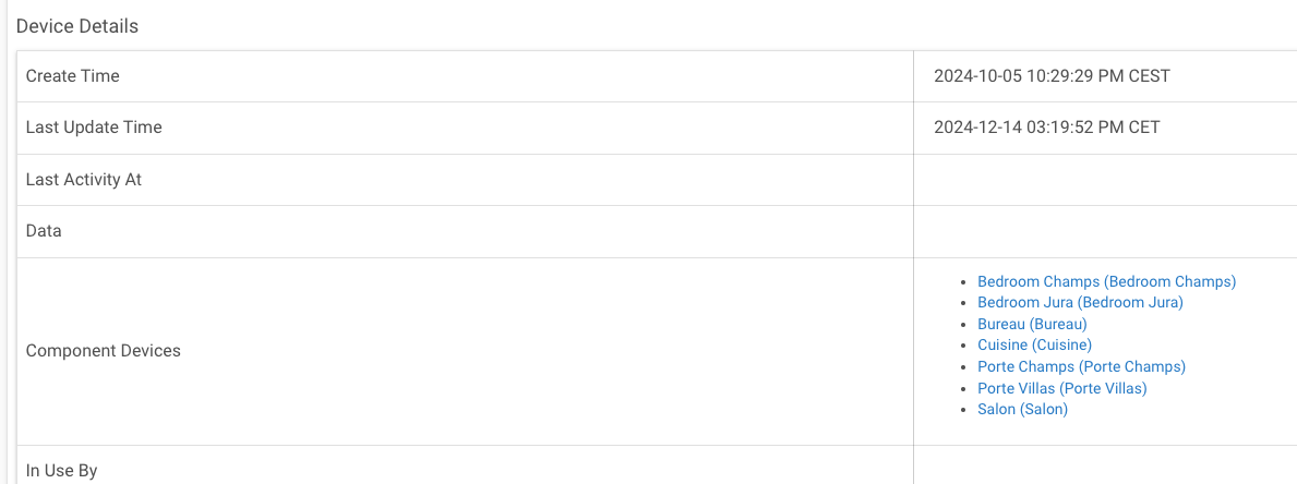

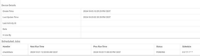

If you open the TaHoma device you've added in Hubitat, do you see any child devices? They show up in the "Device Details / Component Devices" section.
Apparently, no. Here is what I get....

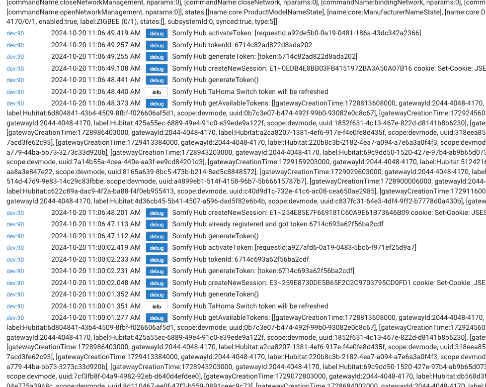

When you click "Refresh Devices", in the logs you should see two entries like "[debug] Somfy Hub rts:BlindRTSComponent". If you don't, then the TaHoma hub isn't sharing that it has any RTS blinds.
A text based version of the log would be useful that starts with "[trace] Somfy Hub devices [[attributes...".

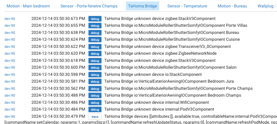

So.... with an afternoon to kill, I started playing with someting I don't understand. Building on your Tahoma driver, I simply tried to include recognition for IO devices ... hoping to register and command them using the same routines you've developped for the RTS components.

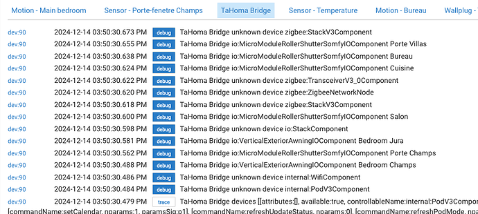

Well, it doesn't work .... no child device registered (red underline), but but there is progress as the log now shows the communication with my Somfy Hub is working, it recognizes my (two) types of IO devices & receovers their names too (blue underline).
I'll experiment pragmatically some more, but any indications you might have would be most appreciated. Notably, what needs to be different to send commmands to IO instead of RTS (as i do suspect the protocol must be very close if not similar....). Any hints / ideas ?
Wait .. what ... success ? YES it works beautifully !!! :smiley:
