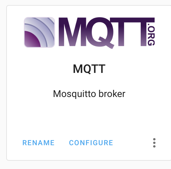

Hello. I've been trying to set up MQTT for HE and HA to talk to each other. I've gotten the point where HA is at least publishing some data and I can see it with MQTT Explorer, but I can't get the MQTT app in HE to connect to the broker.
It's the same null broker config messages as mentioned above, but I am not sure what you mean by "re-running the app" after deleting the child device.
I did try yesterday to delete the child and remove the app, then re-add the app. It didn't change anything.
Okay, I think I got the child app communicating correctly. I deleted the child device, rebooted the hub, then loaded the MQTT app again. Checked the child device and it seems to see the broker now.
Now on to figuring out how to get HA devices to be discovered. I'll head to the other topic for that.
