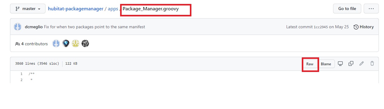

So in Github, there is a button in the upper corner "RAW". Click on that, and a new page will come up. Copy and paste the URL for the RAW page into Apps Code tab in Hubitat (Import, paste URL) and save.
You don't want a ZIP or package JSON or anything else.
The other option would be to copy and paste all the RAW code, but just the URL is much easier.

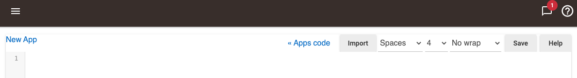

The Alternative mentioned is to do your steps 1-4 but at Step 5 do...
Step 5. Copy the URL of the page (The RAW page)
Step 6. Copy the URL into the Import field...

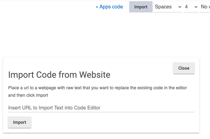

See the Import button there in the middle? When you click on it it becomes:
And you paste in the URL of the RAW code into that field. Then click the Import button. The hub itself will go out and copy the code... and then you click save, and carry on per the tutorial.
