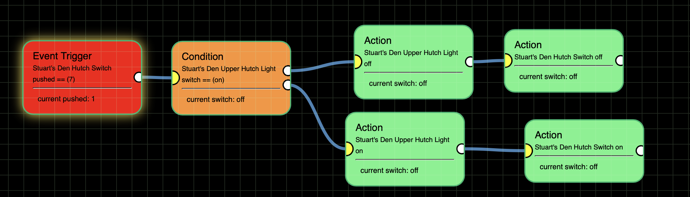

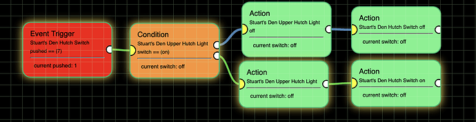

I got a basic toggle flow working:
The logic is
Event: Stuart's Den Hutch Switch button 7 is pushed.
Condition: Is Stuart's Den Upper Hutch Light on
If True:
Action: Turn Stuart's Den Upper Hutch Light off
Action: Turn Stuart's Den Hutch Switch off
If False (i.e. Stuart's Den Upper Hutch Light is off):
Action: Turn Stuart's Den Upper Hutch Light on
Action: Turn Stuart's Den Hutch Switch on
So far so good. What I want to do is now add in an OR such that when Stuart's Den Hutch Switch button 7 is pushed if either Stuart's Den Upper Hutch Light is on or Stuart's Den Lower Hutch Light is on then to turn both of those off and to also turn Stuart's Den Hutch Switch off.
Otherwise (i.e. both Stuart's Den Upper and Lower Hutch lights are off) then turn them both on and also turn on Stuart's Den Hutch Switch.
I tried a flow with an OR but it didn't seem to be working. I'm not sure how to use the OR tile. On the input side there are 2 inputs. Does that mean there can only be 2 "OR"s? What if we want to test 3 things: e.g. Switch A is pushed, Switch B is pushed or Switch C is pushed?

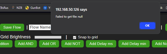

  • Took another shot at fixing the 'null' error on page load
Just need to do another 'Repair'
Still there .. Love the grid brightness !
you are rocking this app :slight_smile:
Same fix works ...

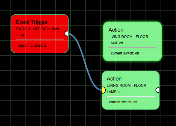

Just a thought .. would be nice if the action tile or someway
to have a toggle switch for lights ect.
( Press switch 1 = turn on light / then press switch 1 = turn off light )

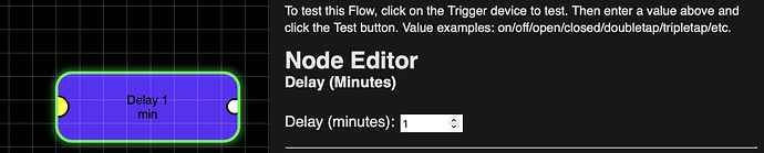

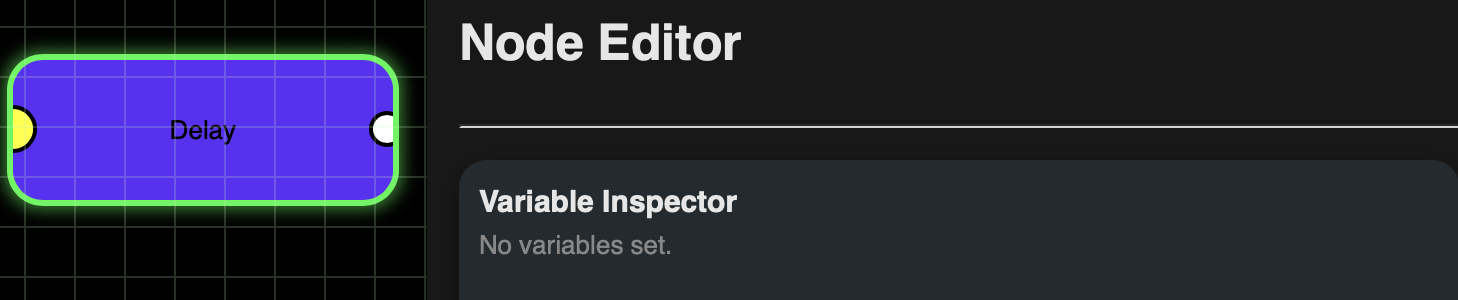

Also, while Delay Minutes asks for an input:
No input comes up for Delay Milliseconds:
This is why I said to 'Hold on'.. There is some serious issues with that download. I had already uploaded everything so I wasn't about to try and reverse it. Working on the fixes now. Might be a day or two before the next update though.

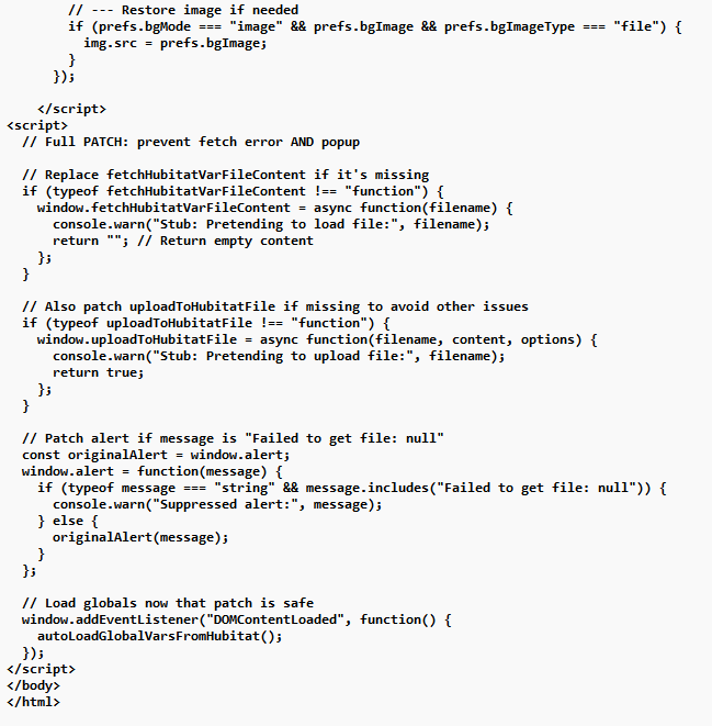

Paste the code here using the '</>' from above. Thanks
I'll add it to the list!
Nice catch. Added to the list. Thanks
I got the basic toggle to work and edited post 140 to reflect that. No rush on the "OR" question I put in there as I know you are working on more serious bugs.

<script>
  // Full PATCH: prevent fetch error AND popup
  // Replace fetchHubitatVarFileContent if it's missing
  if (typeof fetchHubitatVarFileContent !== "function") {
    window.fetchHubitatVarFileContent = async function(filename) {
      console.warn("Stub: Pretending to load file:", filename);
      return ""; // Return empty content
  // Also patch uploadToHubitatFile if missing to avoid other issues
  if (typeof uploadToHubitatFile !== "function") {
    window.uploadToHubitatFile = async function(filename, content, options) {
      console.warn("Stub: Pretending to upload file:", filename);
      return true;
  // Patch alert if message is "Failed to get file: null"
  const originalAlert = window.alert;
  window.alert = function(message) {
    if (typeof message === "string" && message.includes("Failed to get file: null")) {
      console.warn("Suppressed alert:", message);
    } else {
      originalAlert(message);
  // Load globals now that patch is safe
  window.addEventListener("DOMContentLoaded", function() {
    autoLoadGlobalVarsFromHubitat();
</script>
</body>
</html>

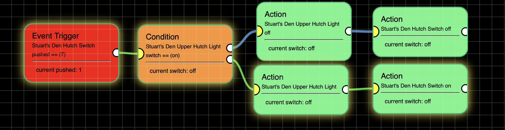

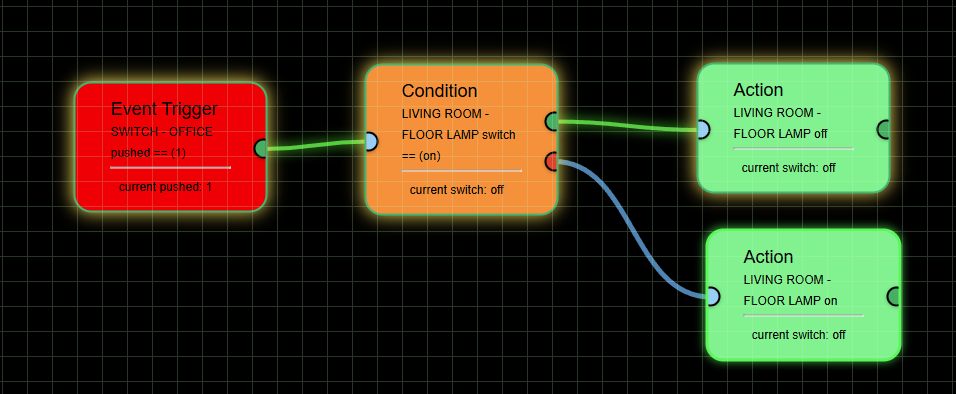

The highlight around the tiles in the flow path is kind of light and fuzzy. Could you make them brighter and a solid color? (Or better yet, if it is possible and there would be room for it, a slider to make it more or less intense like for the grid.) Here is what mine looks like currently:
Speaking about the grid, I keep going back and forth between whether it should show through the tiles if bright enough. One the one hand it could make it easier to line up the tiles in a particular way, on the other hand, it does make a lot of the text harder to read. Would it be possible to have a toggle to bring the grid into the foreground or background?

  • Used @WarlockWeary fix for the 'null' error on page load. Thanks!

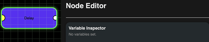

  • Fixed 'Delay ms'. Input field now shows up.

no more error when loading :slight_smile:

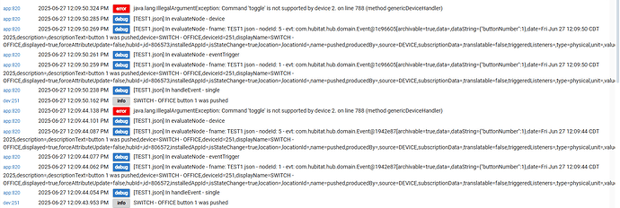

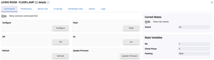

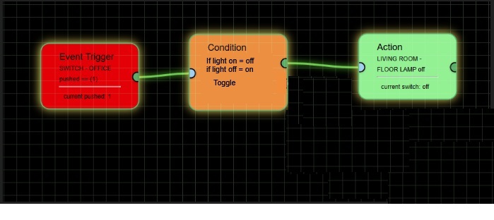

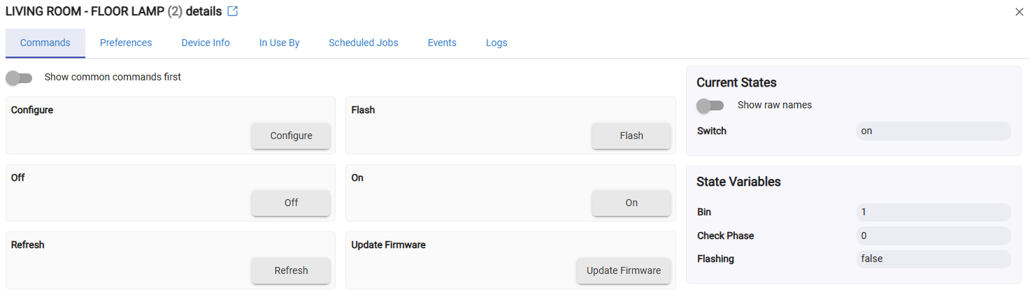

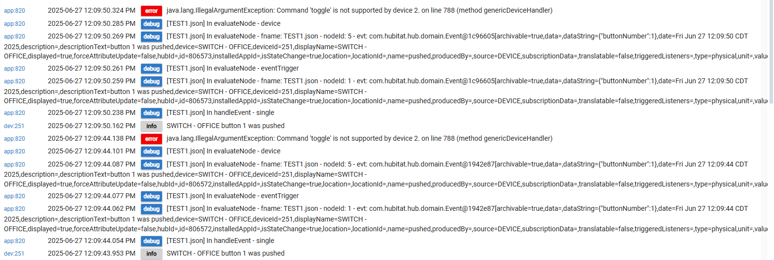

Not sure any lights really support " toggle " well non of mine anyway.
I think this would have to be a [Flow Engine] drag-and-drop button ..
if light on turn off - if light off turn on ?
I would just need to add logic in the FE app, to handle the Toggle command. Easy to do. Added to the List!
I don't have time to test right now but I put an updated app in github. 'Repair' and let me know how it goes!" :upside_down_face:
