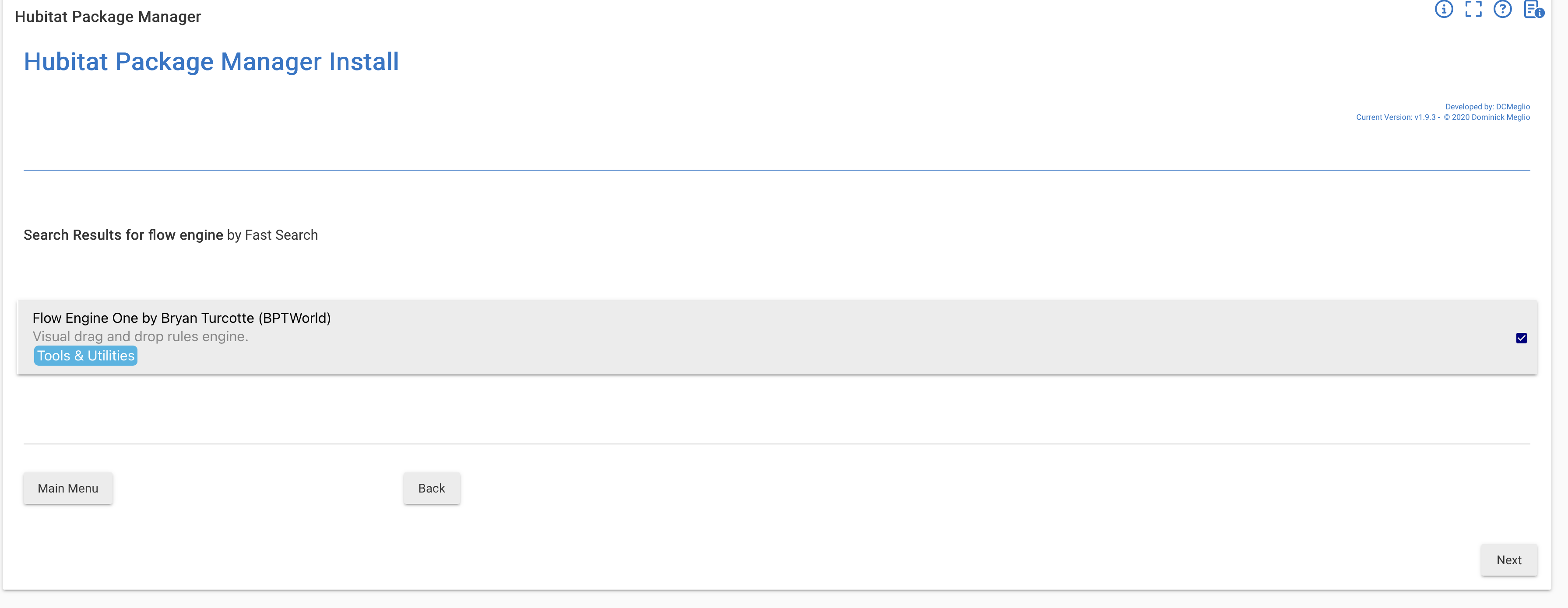

For some reason I can't install FE1 via HPM. It certainly found it and there is a check in the box at the right, but when I click "Next" does nothing happens.

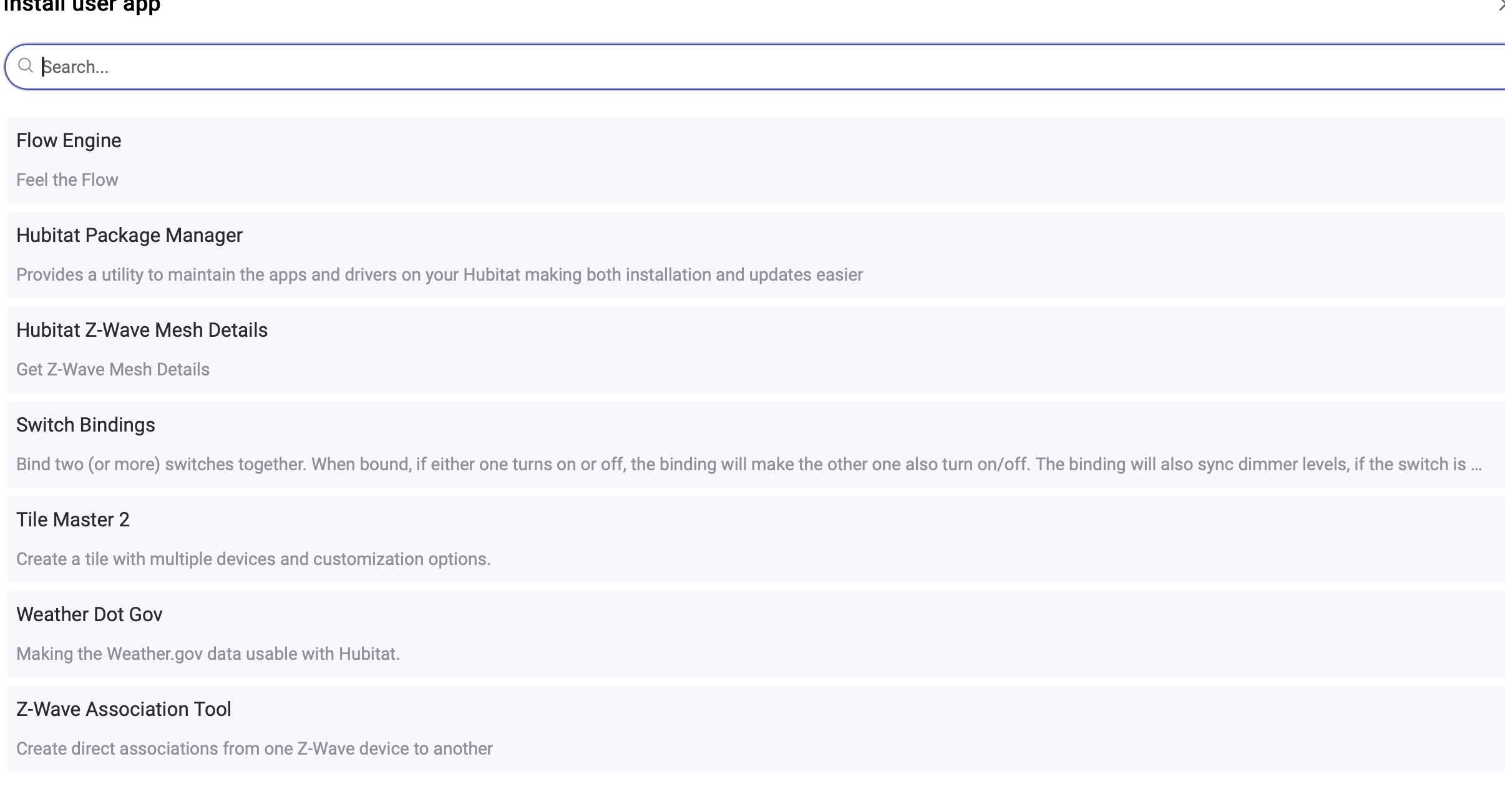

That check means that HPM thinks you already installed it. Now go to apps and 'Add User App'

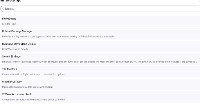

Only Flow Engine is there, not Flow Engine One. There was nothing in the instructions about removing FE first. (In fact, it seemed kind of implied not to as it said it would find my existing flows).
When I tried to do a "Repair" it said it did it, and now in the list of Apps in Hubitat it says Flow Engine One. So I'm hoping that did it.
Whether you uninstall it first, last or not at all, it doesn't matter. It's a completely different app. Just be sure to update the appId and token in the Editor to point at the One app.
I just couldn't get it to install the new one. As I showed in my two previous posts when I went to install it as a new one in HPM I got the check mark for it thinking it was installed, and when I went to Install User App it wasn't there. When I went back into it, it now after doing a Repair in HPM it shows as Flow Engine One. I did click Done then.

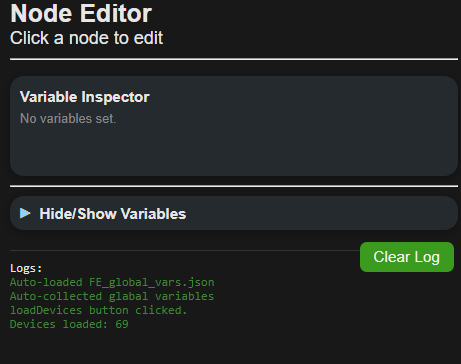

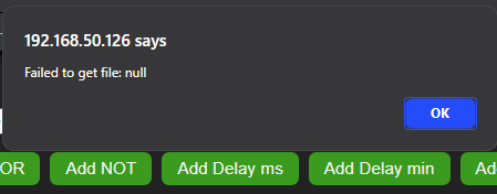

Just a hint ? when you open flow I get a error.
Error "pops up " during the > LoadDevices Button Clicked )
After I close the window ( press ok )
Then the > Devices Loaded:69 comes up in the side log area.

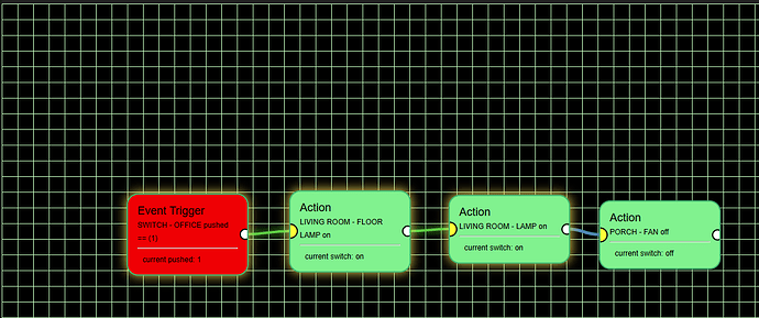

I also noticed that the tiles don't quite match the grid size so it is hard for OCD types, like me, to make the connectors perfectly horizontal. I would like to see all the tiles be the same size and that the size be 100% of a multiple of a grid size (right now Event Trigger tiles seem to be 5 squares tall while Action tiles can vary - for example see the screen shot posted by WarlockWeary at post 128).
Same error here when opening the flow editor...
@thebearmay , may have solved the problem. I've pushed his change to Github. Go ahead and do a 'Repair'. If it works, he gets all the credit. If you still get the box, it's my fault! lol
The centering stays, it just looks better when opening a Flow. As for zoom in/out that's been in there since the beginning. Just hold the ctrl key and use your mouse button.
Again, the tile size is dependent as the data within the tile. I'm not going to make a tile that has 1 device selected the same size as a tile that has 10 devices selected. That just doesn't make sense. More devices, longer tiles - less devices, shorter tiles. It's just the way it works.

Sorry to inform you but error on load is still there :frowning:

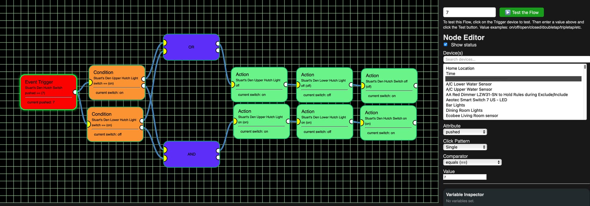

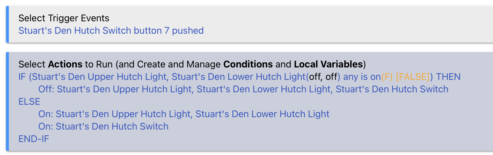

As to sizing tiles based on the number of devices in a tile I'm not sure how to select multiple devices per tile. For example, in the screenshot at the very bottom below I am trying to have it say that if I push button 7 of my Den Hutch Switch and either the Upper hutch light or the Lower hutch light is on I want to turn the Upper hutch light, the Lower hutch light and the Den Hutch Switch off. I did this in 3 tiles. Otherwise (i.e. both the Upper and Lower hutch lights are off) I want them both on as well as Stuart's Den Hutch Switch. Could I have put all 3 actions into an 1 action tile and say to turn them all off or on? If so, how? If not, I'm not really sure what you mean by having more than one device per tile.
Also I'm not building this correctly as it isn't working. Here is the RM 5.1 rule that I was trying to duplicate (BTW, I both Stopped and Disabled the RM rule so only the FE1 flow is active and I have the json listed as being active).

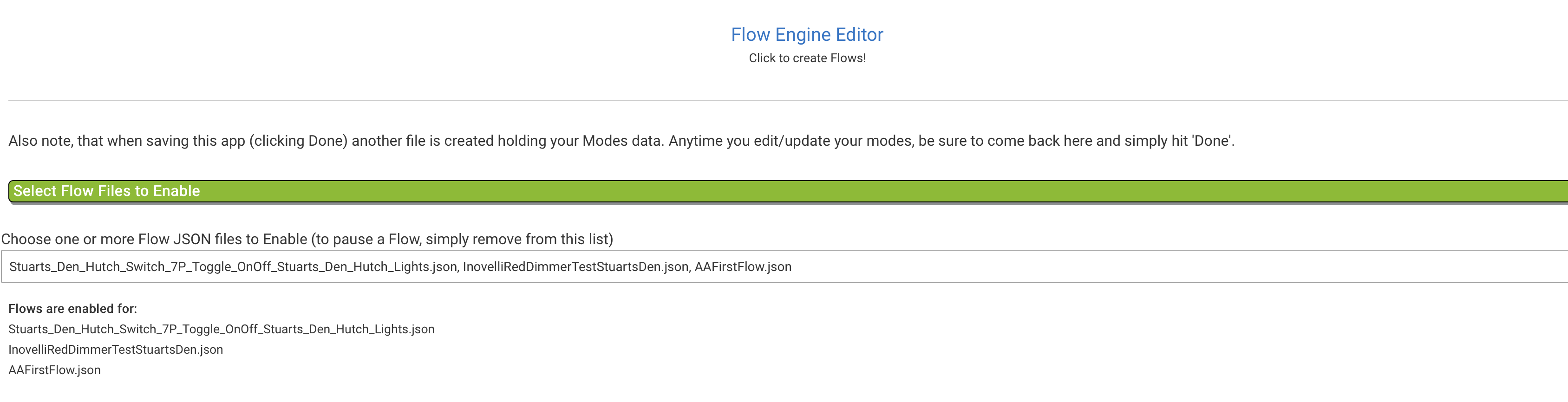

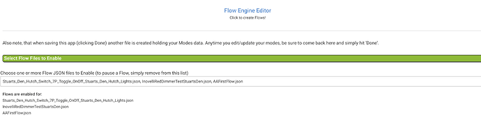

Here is Stuart's Den Lights toggle showing the json is active:
Here is the RM rule before I stopped and deactivated it:

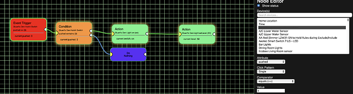

Here is the flow I created to try to duplicate that:
What I was trying to say with this flow is:
  1. The Event Trigger is Stuart's Den Hutch Switch button 7 is pushed
  2. Send that trigger to the 2 conditions.
  3. For the top Condition if Stuart's Upper Hutch Light is On send it out the True port to the OR.
  4. If Stuart's Upper Hutch Light is Off then the top Condition sends it out the False port to the AND.
  5. For the bottom Condition if Stuart's Lower Hutch Light is On send it out the True port to the OR.
  6. If Stuart's Lower Hutch Light is Off then the top Condition sends it out the False port to the AND.
  7. At the OR if either was sent to it, the 3 Actions turning off the Upper Hutch Light, Lower Hutch Light and Hutch Light would be executed in sequence, turning them all off.
  8. At the AND if they were both true (i.e. that both the Upper and Lower Hutch lights were off) then the Upper Hutch Light, Lower Hutch Light and the Hutch Switch would all be turned on.
As you'll also see in the screenshot, even though I put the value of 7 to Test the Flow it appears the flow never goes to either of the 2 Conditions as neither one is highlighted.

Could you please tell me/show me how I should have built this flow?

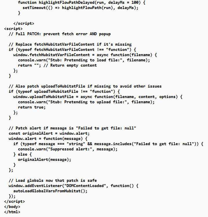

@bptworld ok I narrowed down the error and it's coming from the "FE_flowvars.js" file at line 38, but now need to get back to my regular job, I'll let you check in to it.
For the centering the tiles, have seen a solution in other apps that center the tiles on the tile center, not the edges. Both horizontal and vertical. Then size is immaterial for creating horizontal and vertical lines throughout the Flow.
That's where I was seeing it too. Call to that function is at line 260 but line 259 has an if that should keep that from being a null value:
259          if (!pick || pick == 'null') return;
260          let txt = await fetchHubitatVarFileContent(pick);
Add this to bottom of flowengineeditor.html
Fixed the error for me.
