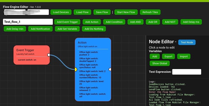

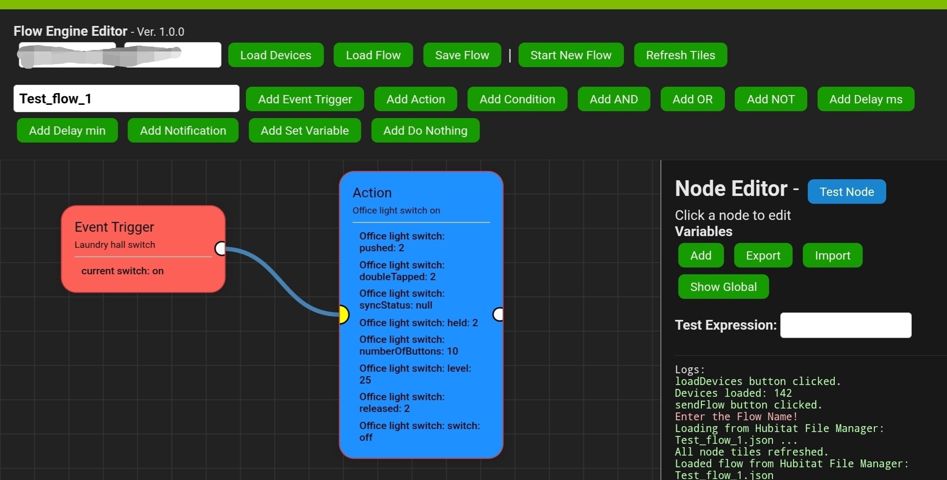

Having trouble getting this logic to work.
When I turn on the trigger the action does not happen.
Also; Refresh Tiles doesn't seem to do anything, the tiles do not update unless I back out of the editor and re-open the flow.
Just an observation, though I haven't played with this yet, your actions seem to contain events. Shouldn't those be Hold, DoubleTap, and Push, instead of Held, DoubleTapped, and Pushed?
The blue tile is;
Type [Action], and the action is,
Office Light Switch [On],
(top two lines).
The rest of the blue tile is populated by the system.
What I expected was with the Trigger being [On] "current switch on", that the Action would also be [On]. What I have is the Action tile says off, (the last line in the blue tile). Obviously I'm doing something wrong I just dont know what. I know Brian is working on it and I'm just posting to learn, so, no hurry, no worry.

No. The Refresh Tiles button doesn't seem to do anything. I have to exit the editor and reload the flow.

@tmpullen , Refresh Tiles button does a lot of things behind the scenes - adjusts the tiles so the connector lines are correct, reloads the devices so the currents are correct and more. It almost isn't needed anymore but if things just don't look right, hit the Refresh button. :wink:
