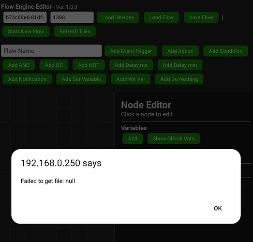

When I open the editor I get this message:

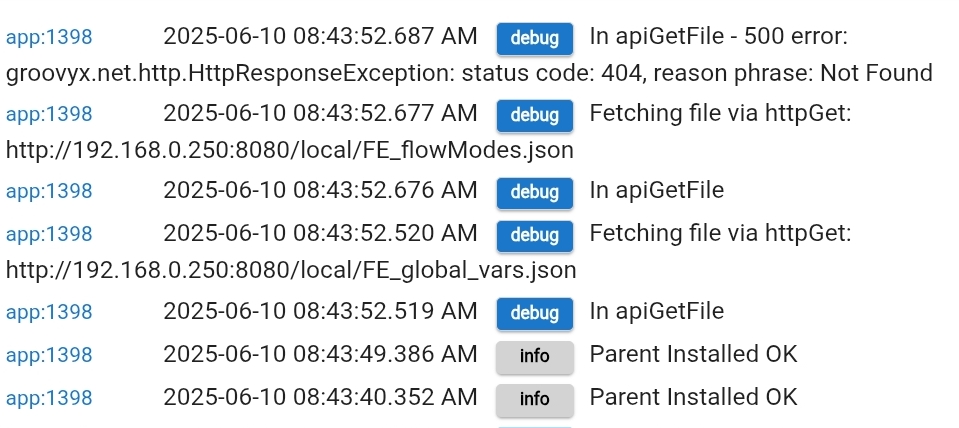

Here is the log:
The file "FE_flowModes.json" is not in HE filemanager.

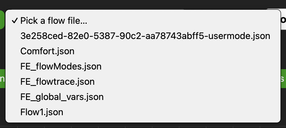

One more related request: filter out non-flow .json files. Out of these, there is only one valid flow file - Flow1.json.
All set. It won't pickup 'FE_' files or 'var_' files. But if other apps dump json files into the file manager, there isn't much I can do about that.
