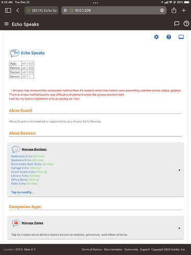

Is the change by Amazon affecting more than the real time status updates that is being worked on?

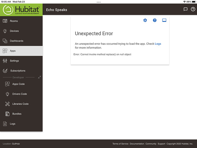

Starting this AM, I'm seeing this in my log. I can not access Echo Speaks off the app menu. Anyone have any ideas?

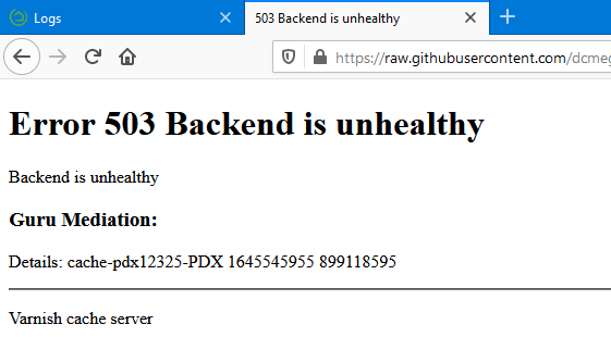

Wow... not even sure where to begin on this one - seems it's a bigger problem in my little world:
Well, I sure am glad that my Backend appears healthy.
