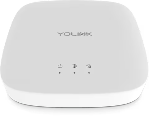

The YoLink Hub is the gateway device that connects all your YoLink devices to the Internet and to the user-friendly YoLink app.. It supports Ethernet and/or WiFi internet connectivity. The YoLink devices do not rely on WiFi, they instead communicate using the LoRa-based (long-range & low-power) wireless network generated by your Hub. The YoLink devices do not need WiFi, which may have a weak signal or may not be available where it is needed. Typical WiFi-based smart devices can bog down one's WiFi, creating traffic jams and poor performance, There is no monthly subscription fees with using any of the YoLink hubs and YoLink devices.
The 'YoLink Hub' provides the sensor data to Hubitat for automation routines.
I also have the YoLink water leak detectors and they work perfectly for my water heater, washer and water main areas of detection.

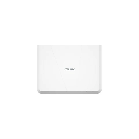

YoLink 3 (a 4G LTE Cellular Backup)
For those, who need sensors where there isn't any internet, YoLink makes a YoLink Hub 3. This hub is the third in YoLink's family of Hubs, the YoLink Hub 3 is the smart home gateway device that supports a 4G LTE Cellular Backup, ideal for remote & urban residences, and has a 1/4 mile extended range. The cellular subscription is $6.99 per Month, and automatically chooses AT&T, T-Mobile, and other major cellular data providers.

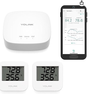

I agree with your statement for traditional indoor battery temperature sensors, but the YoLink temperature sensors and batteries work perfectly inside refrigerators and freezers at very low temperatures (Freezer temps below 0°F) and report accurate temperature and humidity for my use. YoLink sensors use a long-range radio frequency (LoRa) to send data to the Hub, allowing for wide coverage within a home.
Here are some of their features....
Environmental:
Operating Temperature Range: -22°F - 140°F (-30°C - 60°C)
Operating Humidity Range: ≤95% (non-condensing)
Other Features:
Temperature and humidity displayed on the YoLink app
LCD display shows current temperature (Celsius or Fahrenheit) and current humidity (%)
Extremely accurate temperature and humidity figures (+/- .3 degrees Celsius and +/- 3 percent humidity)
Self-calibration available via the YoLink app
Portable; may be placed anywhere in your home or wall-mounted
High/low temperature alerts
High/low humidity alerts
Historical temperature and humidity graphs displayed in hourly and daily figures
Wireless operation; no 120V outlet or wiring required
Battery-powered (two standard alkaline AAA batteries, included)
Up to 2 years of battery life, compared to 1 year for other brands
IFTTT, Home Assistant, Alexa (limited to voice queries of status) integration
YoLink’s industry-leading long range communication and low-power operation
Exceptional value; accurate temperature and humidity sensor in one smart device at a great price
Works with the convenient and user-friendly YoLink app
Know the current temperature and humidity level at the sensor’s location. Check remotely using the YoLink app, anytime and from anywhere
Create customized alerts, to be informed of high or low temperature and/or humidity levels via emails or phone notifications
Create custom automation using the YoLink app, to trigger responses from other YoLink devices, such as the Siren Alarm
Use the IFTTT service (www.ifttt.com) to create custom automation with YoLink and third-party devices, tailored to your particular needs and your IoT devices (IFTTT is a paid service for more than 3 custom automation)
Compact design allows for placing the sensor where others may not fit
Easy to install and portable; move to other locations as needed
Lower cost of ownership than other technologies; low-power operation means batteries may last over 2 years, compared to 1 or less from other brands
Carefree maintenance, with more years between battery replacement
Low-battery alerts give you advanced warning that it is almost time to replace the batteries
Uses standard alkaline batteries (2 AAA batteries); no Lithium or special batteries required
Extremely easy and fast installation using the YoLink app with Scan & Play

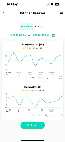

Here is one of my temperature sensors history in my Kitchen Freezer where the YoLink Hub is far away in the basement.
I suspect the humidity sensor is calibrated for typical house temperatures. I would not trust the humidity reading in a refrigerator. In a freezer, the humidity is essentially zero. Placing the sensor in a plastic bag would definitely render the humidity sensor useless.
