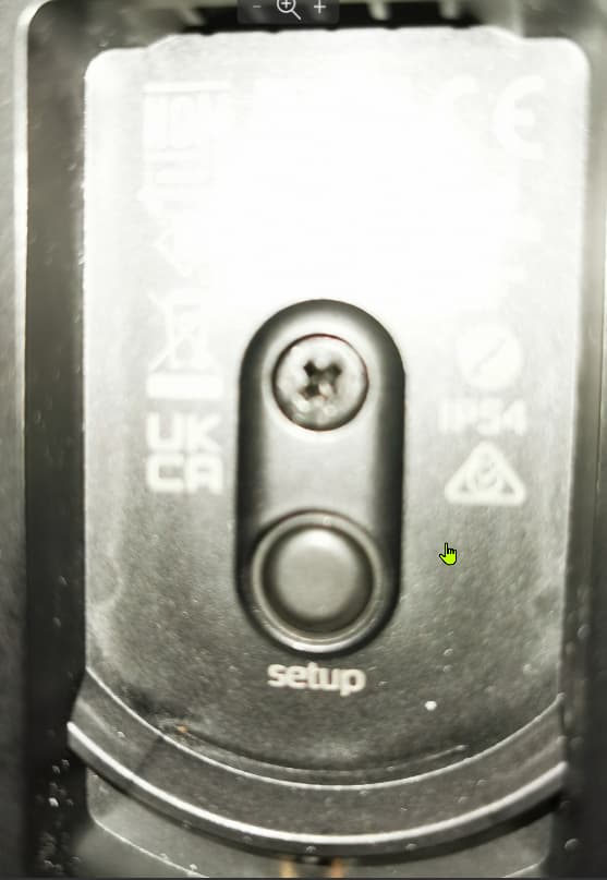

And that does not need to be replaced. I had one rust and seize to where I could barely remove it after using WD-40 and pliers. I guess that makes them easier to take, but that is what the cameras are for.
I think that screw has to be removed before you can replace the batteries though. You'd think they'd splurge on stainless.
I had mine strapped to a tree with Velcro. :slight_smile:
there is a v2 version?
looks like the hue is the clear winner!
is there V1 and V2?
Yes, there are hardware revisions of the Hue motion sensors.
First gen(s?) had 4 super thin & very futzy screws holding the back plate on - they made battery changes quite a tedious and curse-inducing adventure.
The latest gen has a single well-proportioned screw holding that plate on -- a much saner design.
this is the sane one?

I can't tell from that pic since it doesn't show the full back. Mine's inaccessible right now, and I don't recall if all versions had some variation of the center screw or not.
The old version(s) have a small screw in each outside corner of the backing.
