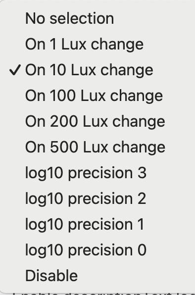

I use the Philips Hue Outdoor Motion sensors. They only report when the lux changes by an adjustable amount (seen below). Batteries are 2 AA batteries and last a very long time.

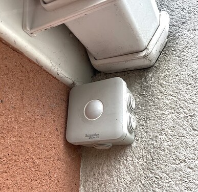

I'm just using the standard internal Fibaro Motion sensor. I've installed them with just the lens visible through a sealed weatherproof box. I'm not using batteries - I've just soldered wires to the battery terminals and connected up to a 5V USB charger. No issues at all with that. This one at the rear I use for garden lighting (it must be positioned so the lights don't affect the luminance) and temperature (must be positioned so the sun can never shine directly on it):
That circle in the middle is front face of the Fibaro sensor.

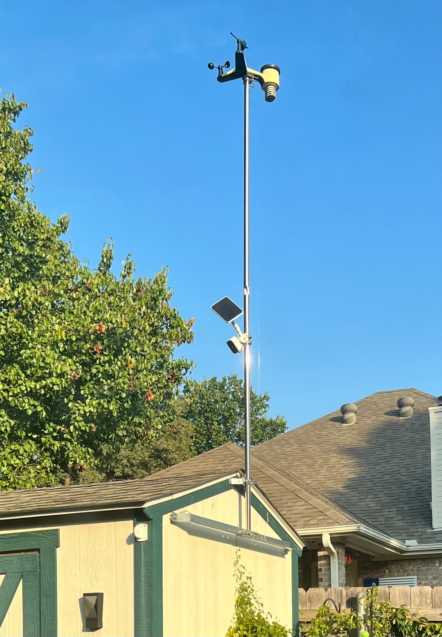

I use the illuminance data from my weather station to calculate opening and closing blinds.

How do you maintain that thing?
(I have a similar weather station mounted on a much shorter pole.)
Puts my rusted vacuum cleaner pipe attached to the fence with ockey straps to shame... :slight_smile:
PVC pipe attached to a garden bench with zip ties for me.
I also have Hue outdoor sensors at each end of my home to detect changes in lux, mainly used transition to "Evening" mode, which changes both the lighting (Hue) scenes as well as closing the blinds not already closed on the west-facing windows (I face East / West).
I monitor the lux for both sensors on the East and West sides and once one reaches the desired level the transition is made and a Private Boolean used to make sure there's no chopping and changing. From memory I do a similar thing for transitioning from Night to Day each morning.
The weather station is primarily solar powered. It does have batteries (alkaline) for nighttime operation, but I only have to change them every two or three years. When I need to change them I get a ladder and unbolt the pole and bring it down. It isn’t much trouble since it isn’t a common activity.
That will work for short lengths. Mine is a TV antenna pole (~10ft) and mount.
Last time I looked there were bugs and stuff in the rain gauge, and it wasn't too long.
