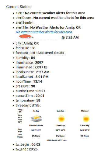

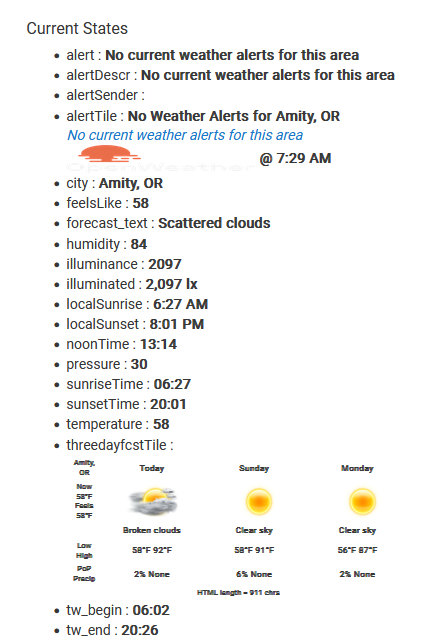

If you're built to not rely on internet, an outdoor motion sensor with Luminance or Lux is your solve. I personally am comfortable with internet connectivity - I use OpenWeatherMap. You sort of get the best of all worlds here and it is astoundingly accurate. Note below - Local Sunrise (which is slightly more accurate than HE) and Illuminance and illuminated which give a numerical value for lux you can set as a comparator. I use this in a nice tile on my dashboards to have realtime weather as well as a source for running my LUX related rules - (see below)

jshimota that looks great! online service that shows local lux levels. Does OpenWeatherMap support for Australia?

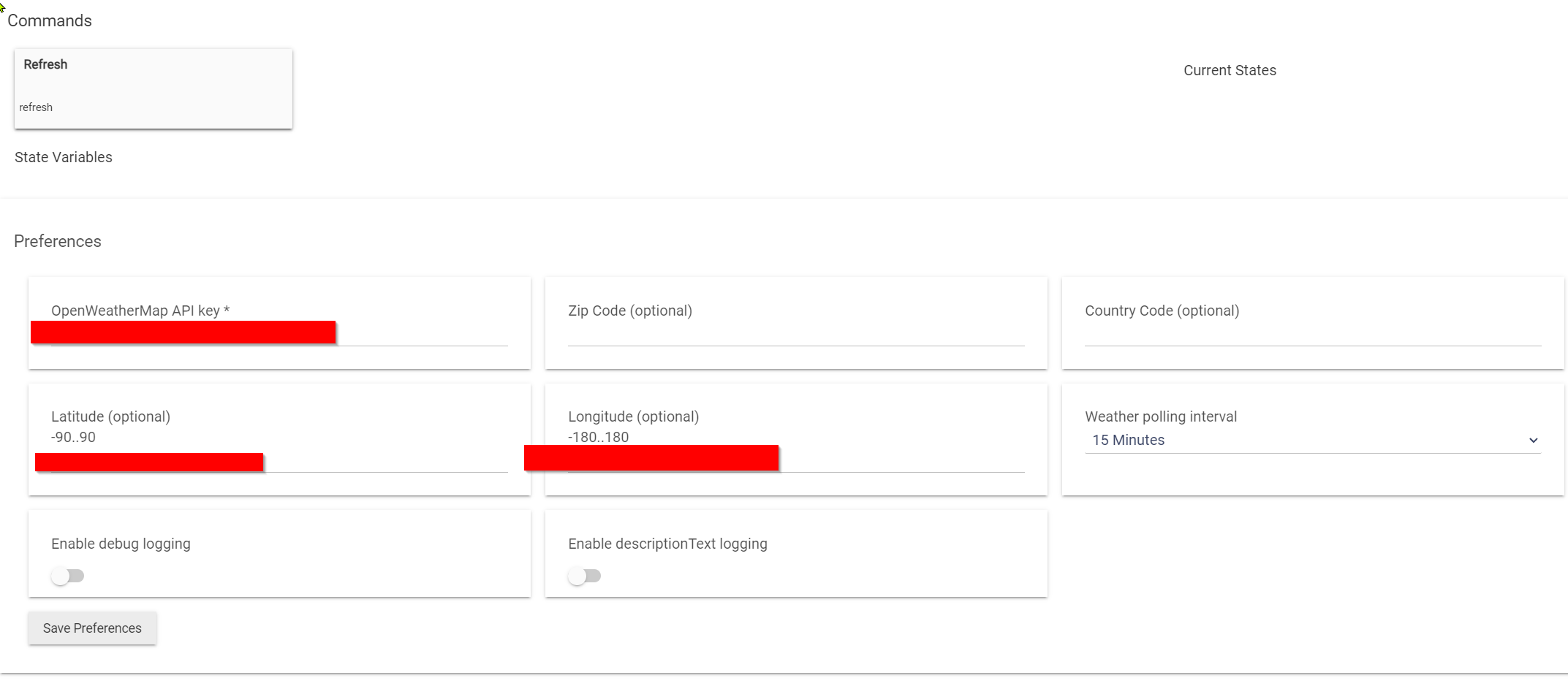

i added OpenWeatherMap virtual device. Got API key from https://home.openweathermap.org/.
I dont see the data you see. jshimota

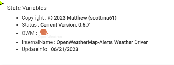

Tried the user driver https://raw.githubusercontent.com/HubitatCommunity/OpenWeatherMap-Alerts-Weather-Driver/master/OpenWeatherMap-Alerts%20Weather%20Driver.groovy
with the same API key, still no data shown...

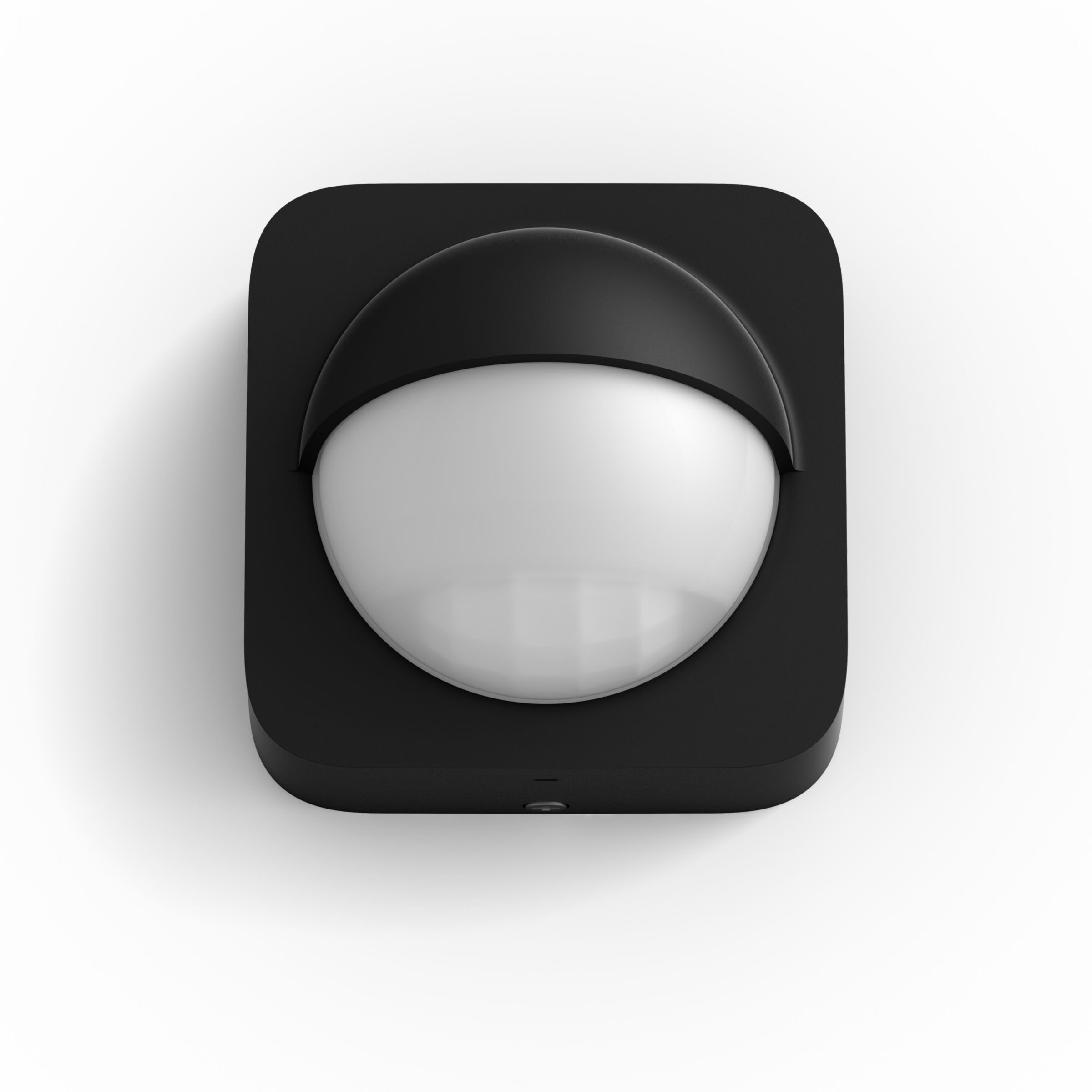

Same. The Philips Hue Outdoor Motion sensor is awesome.
which sensor?
Edited. Good catch. These threads get confusing and I should have included "Philips Hue Outdoor Motion"
says requires phillips hue bridge?
can work directly with hubitat?

Yes, works directly with Hubitat using built-in driver. No need for a Hue bridge.
Yes, built-in driver works very well
Two AA batteries, which last a very long time. I have never replaced my Hue Outdoor motion sensor's batteries, and it has been running for well over a year.

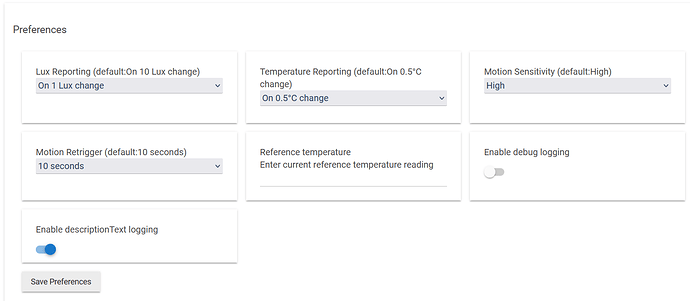

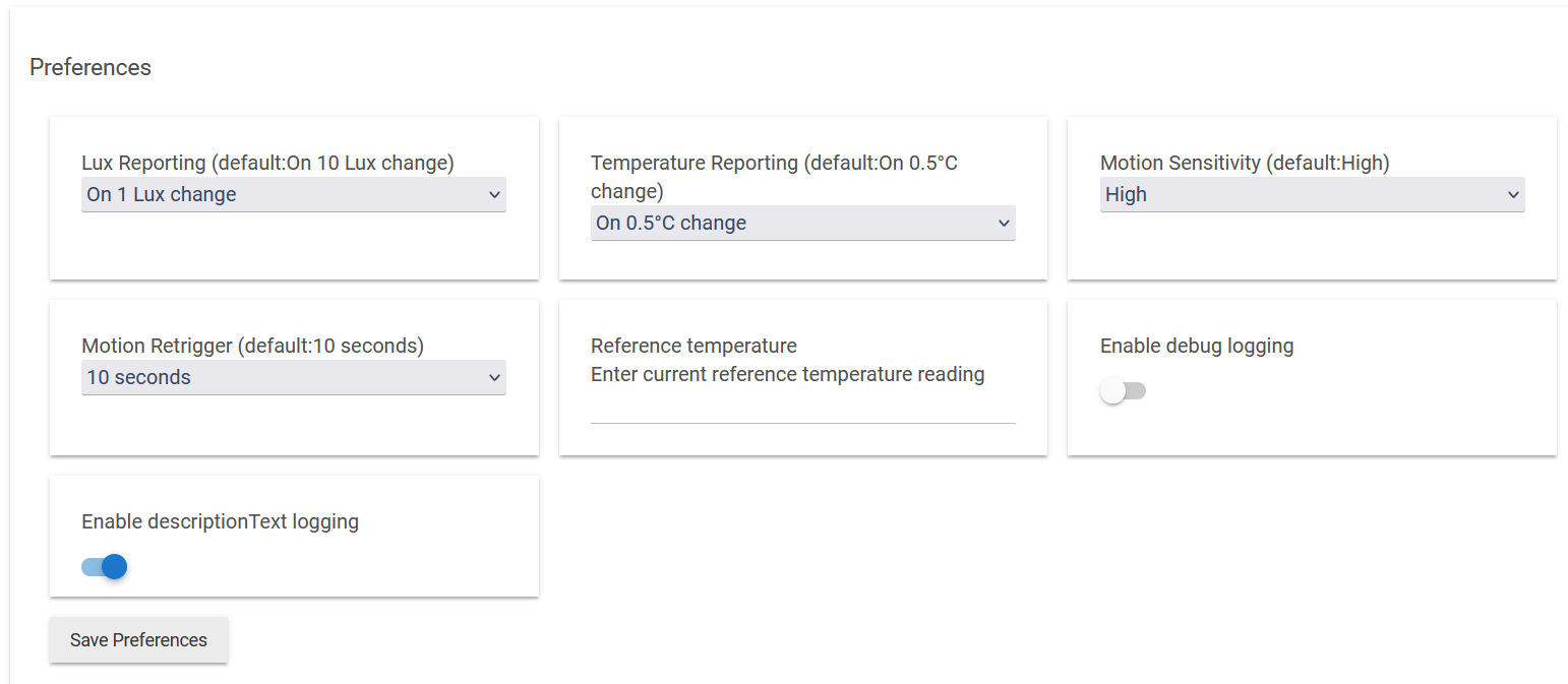

Polling is not required. Lux changes will automatically send status updates. The driver provides many settings to control when these updates are sent as a function of how much the lux value has changed.
See above - polling is not required. Let the device decide when to send the updates.

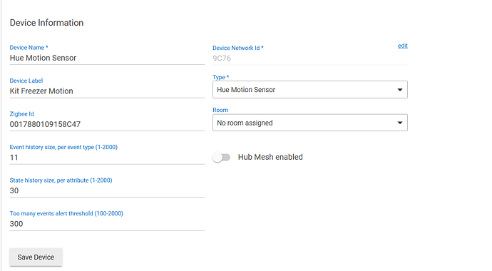

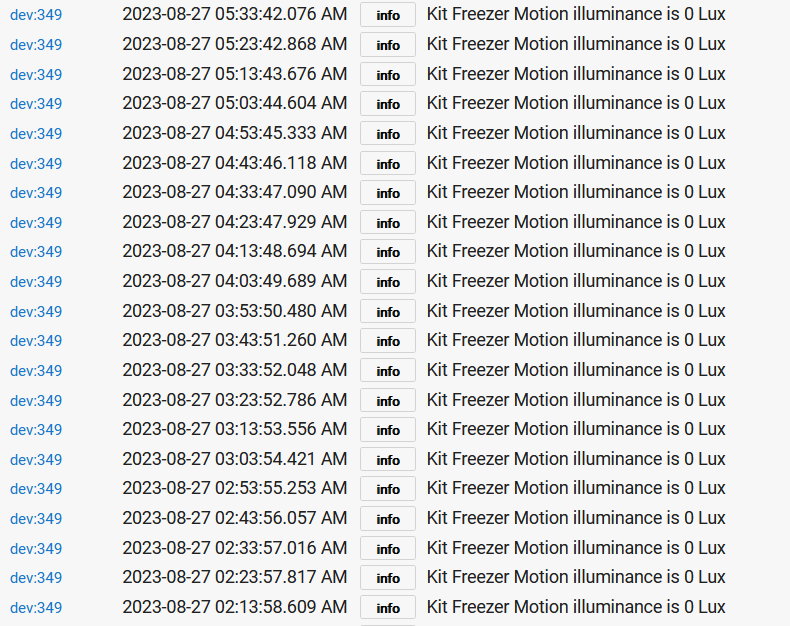

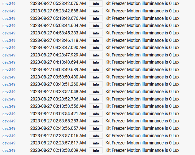

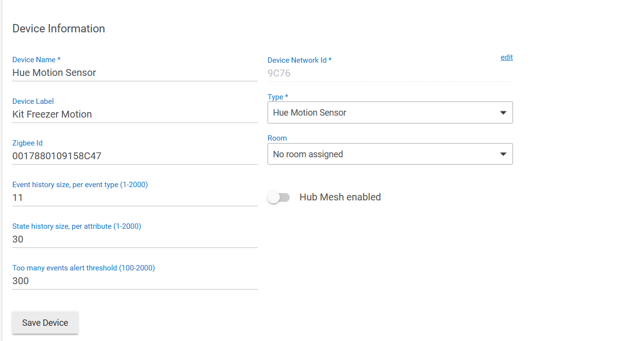

The Hue indoor version has been in my fridge freezer since 12/19/20 with the settings below. The batteries, 2 AAA alkilines, are at 48%. When there is no lux change, it reports every 10 minutes.
Nah, it's Zigbee and does NOT require a bridge. Native direct driver support. I have never replaced the batteries - people have said 1-2 years. I let it report all the time and use the motion support to turn on flood lights if someone "wanders" into the backyard.
