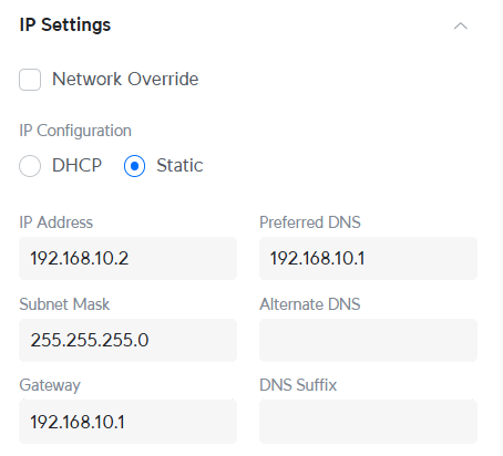

As w/the connected devices on the Client Device tab, looks like setting a DHCP reservation for APs and switches is also only done from the Unifi Device page, and also uses the same Static IP setting:
Before I hit apply on above settings, wanted to make sure that this is the best/only way to set an IP for APs & switches. Using "Static" just feels weird to me after using DHCP reservations on every other router I've owned up to and including the ER12.
Settings question: For my static IP DNS settings above, should I just point at the UCG Ultra for DNS? Or better to put something like 1.1.1.1 in DNS and 8.8.8.8 in Alternate DNS?

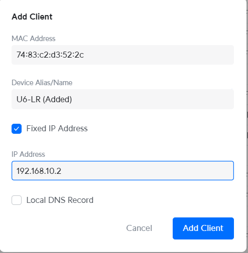

And...update, just found this, but it's from an older post on the UI board...has anyone set a DHCP reservation for a Unifi device this way?
  • Alternatively you can copy the AP's MAC, go to the clients section -> add client and add it there. This will tell USG to provide a stable IP to your AP via DHCP.

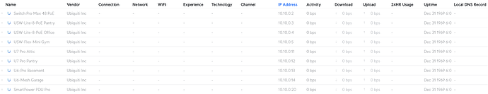

You can set up DHCP for the UniFi devices. Go to client devices, make sure all are showing (you may need to refresh the page). Sort by IP address. Any without an address should be there at the end of the list. The 'add client' with MAC address should work too.
Thanks...my Unifi APs and switches don't show up on the Client Devices page, that's normal as I understand it, as they do appear on the Unifi Devices page. Sorting by IP on the Client Devices page, I have one Ubiquiti device at the bottom but it's MAC doesn't match any of my Unifi Devices listed on my Unifi Device page...and when I searched for the MAC addresses of several of my Unifi Devices on the Client Devices page, they are not found (as expected).
So I don't see any way to set a DHCP reservation for the Unifi on the CLient Devices page other than via Add Device, but that feels odd to add a new device using one of my AP's MAC address when the AP already exists in the Unifi Devices page. Below is the Add Device dialog:
Sorry, but I feel like I'm misunderstanding your point...it sounded like you were saying there are two ways to set an IP reservation on the Client Devices page, the "Add Device" method and another way. Can you elaborate a little more about the option to set a DHCP reservation for my Unifi devices on the Client Devices page, without using the Add Device option?
Sorry, mine was in my list as it was still in a previously connected state. I removed it from that list and it didn't come back. So, the way to do it is just via the 'add client' functionality on the client device page. Once you do it the devices will be in the list, but they'll be in light gray font with no useful stats other than IP address.
Thanks for confirming...I just completed this for one "test" switch in case it blew anything up, did not cause problems of course as you note.
Client Device page "Ghost" (dare I call it that here?!) :wink: w/reservation setting:
Unifi Device page w/actual device - rebooted the switch and it picked up the reserved IP perfectly.
This is an odd user experience, but if that's how Unifi wants it, I'm fine. It does provide a way to have a nice quick list of my Unifi DHCP reservations.

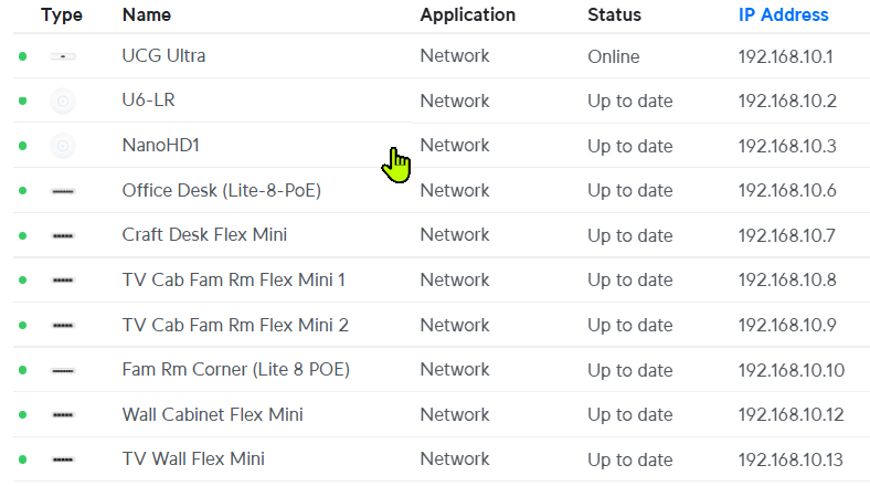

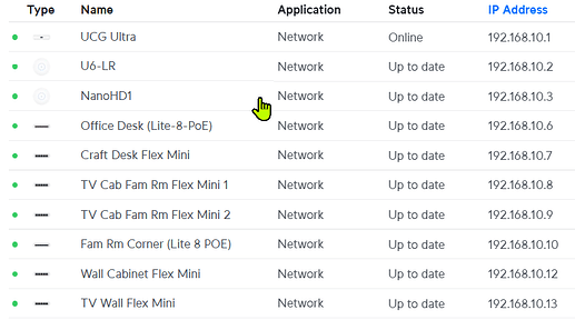

IP address OCD sorted!! IPs 4 & 5 are held by NAS devices, too many dependencies on those IPs to mess with so they always get to keep those and sit in the middle of my Unifi gear. I kept a "spare" IP at 192.168.10.11 where I may be adding/changing something later.
Only one spare IP for more gear? Oh... you are definitely underestimating the addiction...
One spare in that range. I set aside 50 reserved spaces out of my DHCP range.
