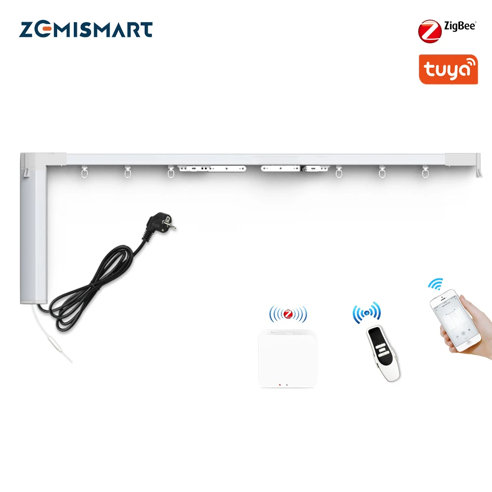

I'd really like automated curtains, and it seems like Zemismart is the only realistic game in town. I just have concerns about the appearance of the silver mounting brackets, and the little couplers that hold different segments of the track together.
The brackets are pretty big and conspicuous. Does anyone who has these think it would be realistic to drill a hole through the top of the track and mount them to a ceiling that way, and avoid the brackets altogether?
Similarly, those couplers are a bummer and kind of stick out like a sore thumb. Any ideas on how to avoid them? Is there any way to order these such that you can get a large enough contiguous piece of track to cover the area you want (about 82" in my case)? Or perhaps mount them well enough that the tracks are sufficiently adjacent without the brackets? Or maybe only put some kind of coupler on the back side where it's mostly hidden? Or maybe order a few sizes up such that the tracks are larger than I need, then I can cut them to size?
Hard to figure these things out without looking at them in person. And doesn't seem many people have gotten or reviewed them, so trying to piece together via the few YouTube videos I've seen.
Thanks in advance.
Are you looking at this product?
You wouldn't have to do this. You could skip the side brackets altogether. The "ceiling bracket" attaches to the "side bracket". It's hard to see but the little tabs on the ceiling bracket lock into the top of the track when it turns. You could skip the the side bracket and screw the ceiling brackets to the ceiling. You would probably want to use a washer or something so that you can still turn the ceiling bracket.
I don't think there is anyway to avoid these. The largest piece is a little over 3 feet, due to packaging and shipping constraints.
I have four of these curtain motors setup in my home. Two of the window coverings had valiances that hide the Installation of the curtain rails. The other two, I built wooden valiances for. I can PM you some photos if you would like.
