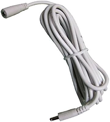

Does anyone know exactly how long the power adapter is on the Aeotec Siren 6? I asked on Amazon and got a super vague "at least 2 feet" answer.
58" or 148 cm (I just measured for you). But if you need longer (like I did) this extension works perfectly. The size of the plug is 1.35x3.5 mm.
Thanks @Ryan780, That's much longer than 2 feet! I have an outlet above my kitchen pantry, so I'm trying to figure out if I can mount it on the ceiling. Don't think I'll need that long of an extension, but that could come in handy for other things.
