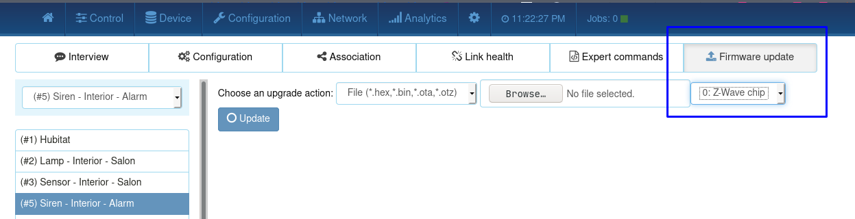

Some screenshots:
I am still investigating all the possibilities but this has already been very helpful in identifying and removing ghost nodes that were still present in HE event after numerous network repairs / restarts.....

Just added an additional screenshot (last one) were you can see the options that help me remove dead my nodes.
