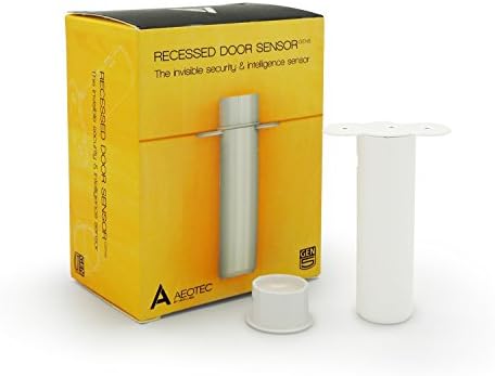

For Zigbee hidden sensors, or can look at NYCE (Zigbee) and Sensitive strips (Z-Wave). If you’re handy with a chisel like I am you can also embed small sensors in a mortise with a plastic plate over the opening, then put the magnet in the door by drilling a hole in the door, and putting some calking over the hole.

I’m using Xiaomi, but originally I did this with a Insteon sensor. THAT was a very big mortise. I also have my alarm system sensors installed this way. Battery changes are kind of a pain, but it’s otherwise fine.
Thanks. I will give it a try with the Samsung multi on an inconspicuous door. I have had the Samsung devices get knocked off occasionally. Having them embedded in the door frame would clean that up.
Yep, that was going to be my other suggestion. Play around with the idea of embedding the magnet far off center from the sensor. Do some tests with the extracted magnet in your hand first. Play with the two poles to see if one is more sensitive than the other. I took a leap of faith, but you might try embedding the magnet in a piece of scrap wood to simulate the final door installation in your tests. The 2018 Samsung Multisensors use a hall sensor instead if a reed switch, so the sensitivity to the magnet makes for a very large activation zone.
I often replace the magnets that came with a contact sensor with a rare earth magnet and intentionally place it off center. I can often get a much more sensitive open / close where the slightest open triggers the sensor. Great for doors where the slightest deviation from closed can cause the lock to fail. So far it hasn't caused issues over several years.
