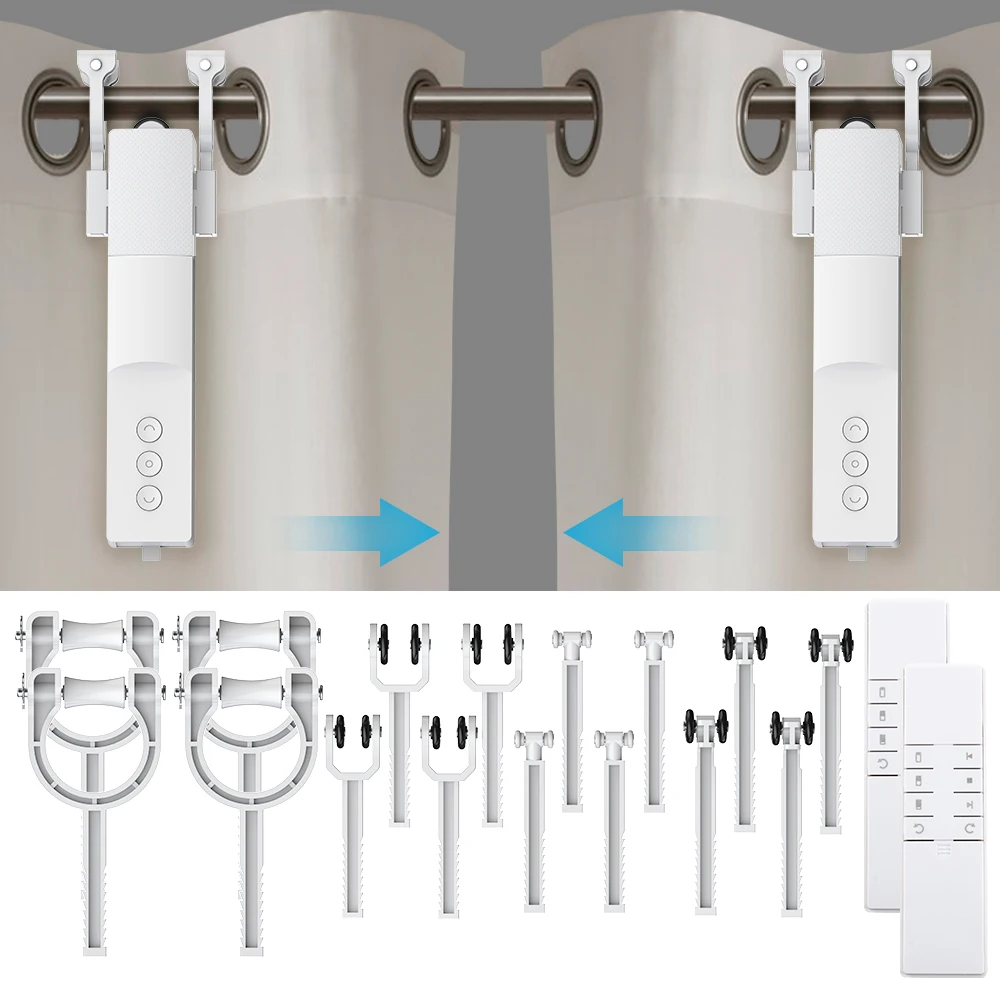

Has anyone had any luck with this:
BENEXMART Tuya Zigbee Electric Curtain Robot Rechargeable Motor for Roman Rod I Type U Type Tracks Alexa Google Home Control (Robot one set) https://www.amazon.co.uk/dp/B09S5V6YSN/ref=cm_sw_r_apan_i_EMNV8CHZKWDVYKQNGJCJ?psc=1

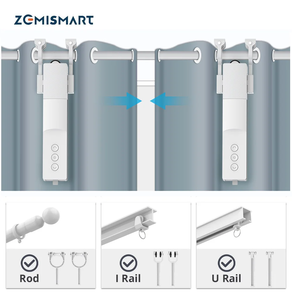

Yes I have 2 of these and AFAIK it is the best curtain retrofit robot out there. Switchbot is let down by their communication protocol IMO. The only thing you have to take into account is that it needs very particular rod dimensions (20mm-28mm) and in my experience, it cannot traverse the rod extension portion, so you may need to rebuy rods to be solid or get creative. Overall I love mine.
This is the actual one I got (much cheaper than amazon's listings):
or
That's great. Thanks so much. Which driver did you use? Luckily I haven't put the rods up yet, so again, great to know.
With a few of my own modifications (robots report battery for instance that is unhandled). If you want I can send my driver over and you can compare and merge whatever changes you want. Technically the battery report is not "unhandled" it just reports as a warning iirc in the logs, and I wanted to use that data, so I added it modeling the other parameters.
