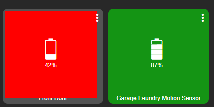

Hello,
Is there a way to have the battery tile colors turn to red when below 20%?
Thank You
Hello,
Thank You
You'd have to create 100 CSS entries (or at least entries for 0-20) in the general format of:
.battery-999 {background-color:red}
where 999 is the battery%
Thanks, I am surprised there is not a "less than" command that can be used.
Also, how can I get the tile text to be over the tile color and have the tile color fill the entire tile?
Now you're rapidly approaching the limit of my CSS expertise.

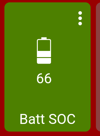

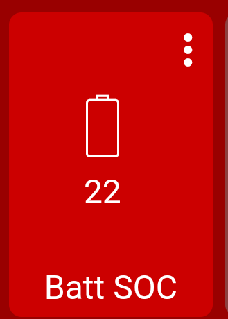

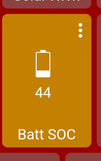

I was searching for a way to do this and ran across this thread. Here's what I came up with..
#tile-19:has(.battery-60,.battery-59,.battery-58,.battery-57,.battery-56,.battery-55,.battery-54,.battery-53,.battery-52,.battery-51,.battery-50,.battery-49,.battery-48,.battery-47,.battery-46,.battery-45,.battery-44,.battery-43,.battery-42,.battery-41,.battery-40,.battery-39,.battery-38,.battery-37,.battery-36,.battery-35,.battery-34,.battery-33,.battery-32,.battery-31) { background-color: rgba(240,255,0,.5)!important; }
#tile-19:has(.battery-30,.battery-29,.battery-28,.battery-27,.battery-26,.battery-25,.battery-24,.battery-23,.battery-22,.battery-21,.battery-20,.battery-19,.battery-18,.battery-17,.battery-16,.battery-15,.battery-14,.battery-13,.battery-12,.battery-11,.battery-10,.battery-9,.battery-8,.battery-7,.battery-6,.battery-5,.battery-4,.battery-3,.battery-2,.battery-1,.battery-0) { background-color: rgba(255,0,0,0.5)!important; }
just what I've been looking for. Where do you put that code?
if you dont want to set of every tile but on every color you can do this.. it goes in the layout section of the legacy dashboard.. not sure if you are asking there or the newer dashboard.
