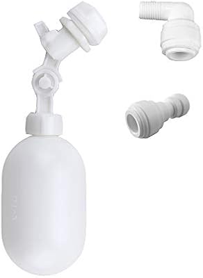

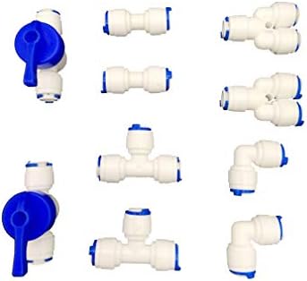

The coffee automation threads should be combined! Not so long ago I plummed in a 1/4" hose to my Keurig with a float that comes off my RO watermaker. So now...no more filling the hopper with water, it's automatic. As a failsafe I got a 1/4" water solenoid that plugged into an old Iris smart plug. That solenoid opens when there is motion in the pantry and shuts down a minute after. Therefore the only time that float can fill is when someone is in the pantry making coffee. It's the little things that feel good...
I've thought of doing this but haven't started my research yet. Do you have more details about the parts?
Float:
Misc parts (especially the shutoff valves):

Plus your 1/4" plastic line and whatever else you may want. Of course you don't need the solenoid part...I just thought that was a really nice backup if anything went south with the float.
Really it's just drill a hole in the top of your Keurig fill lid. Getting that hole in the right location is important though. You want to test the float and the angle and make sure you are drilling the hold where the float won't contact the sides of the water container once installed. Otherwise this is a really easy project.
