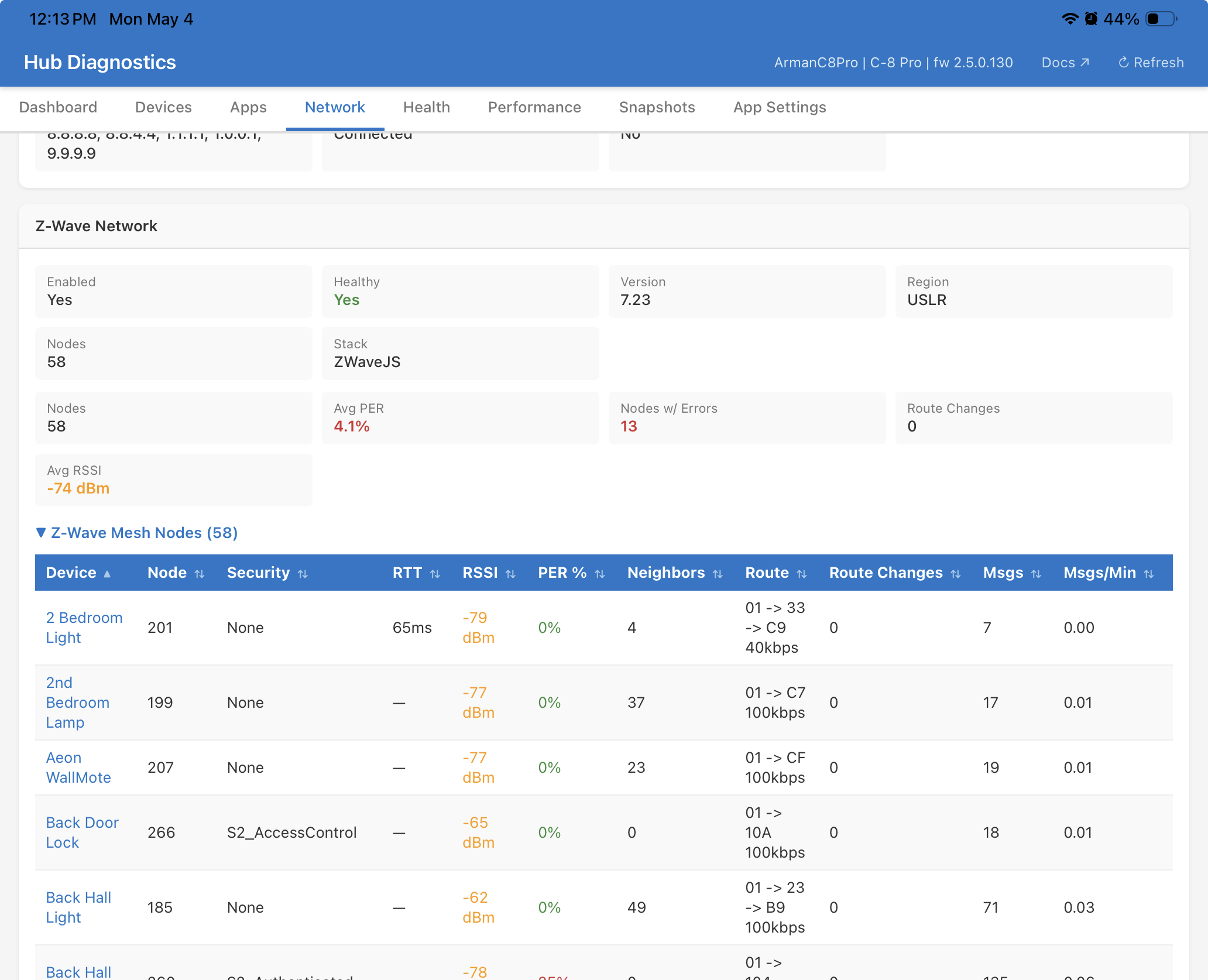

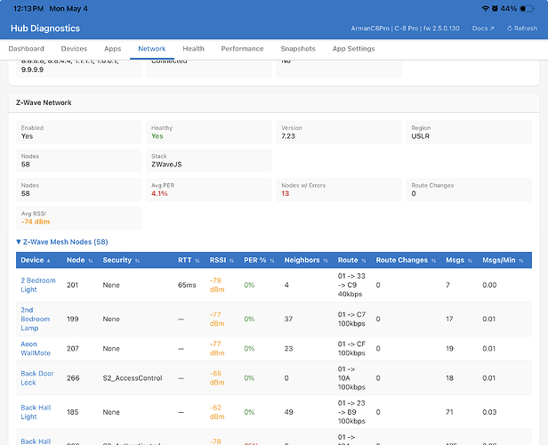

hubitrep has a new “Hub Diagnostics” app that shows (among many other things) the Zwave device routing.
So maybe there IS an API.

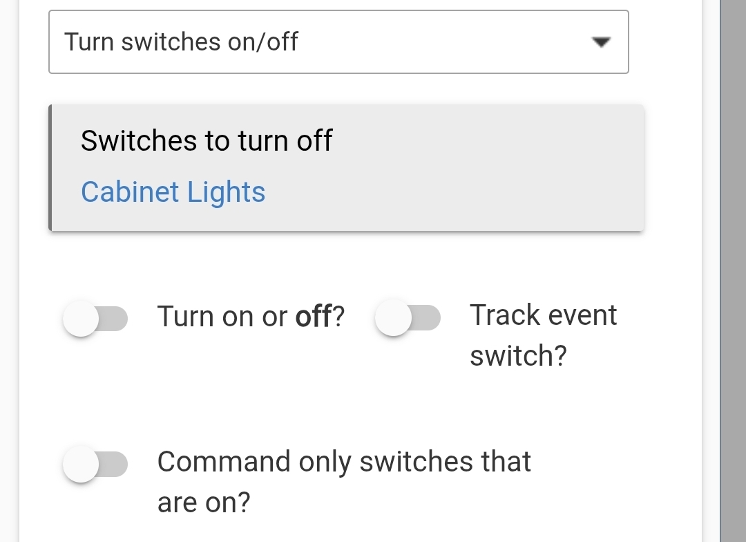

I'm not sure why you would regularly run an All On command for 50 to 55 lights, but for running all off, there is a setting in rule machine where you can tell it to only try to turn off switches that are reporting on. That would significantly reduce the load that the all off rule is putting on your hub.
"Command only switches that are on."
