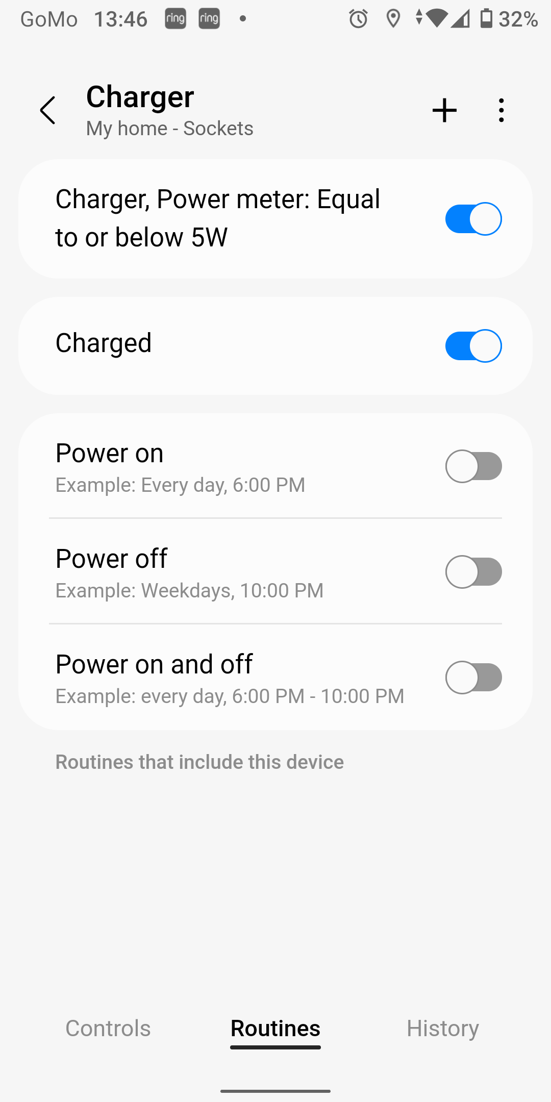

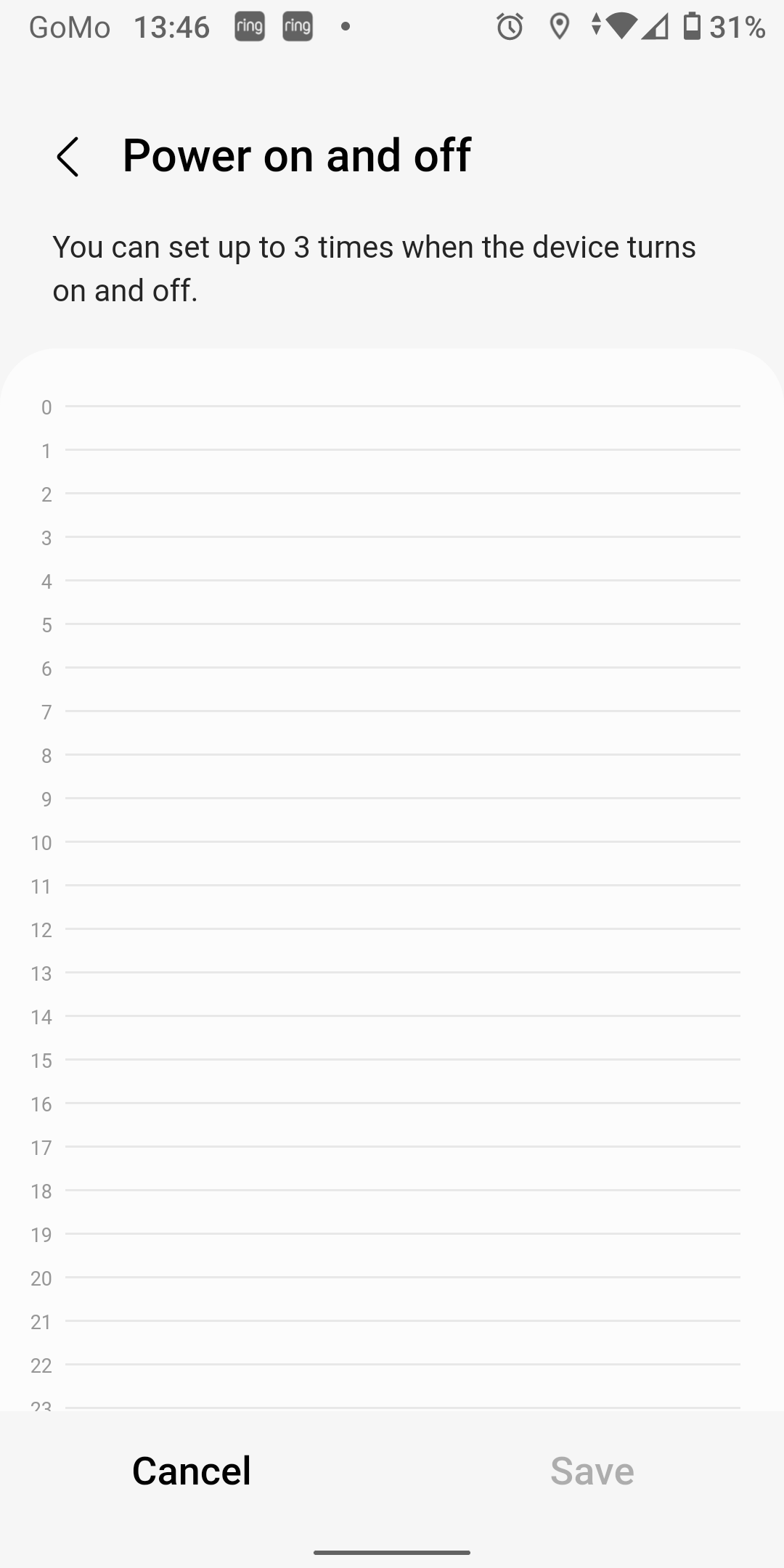

The second thing that I'm missing from ST is that in their app you can very easily go to a device and set it to turn on and off at a certain time and it will do that once off.
I know I could do the same thing by creating a new rule every time, but that seems like it would take a few more steps than it does in ST. Is there a user friendly way of achieving that as I'd like my partner to be able to set up these automations easily too.

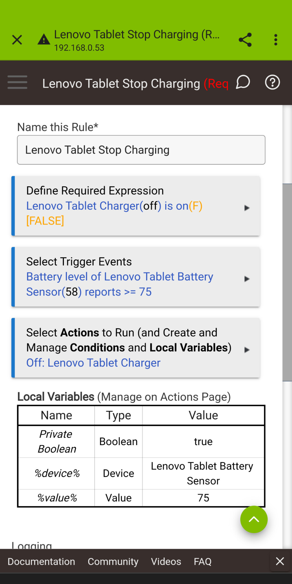

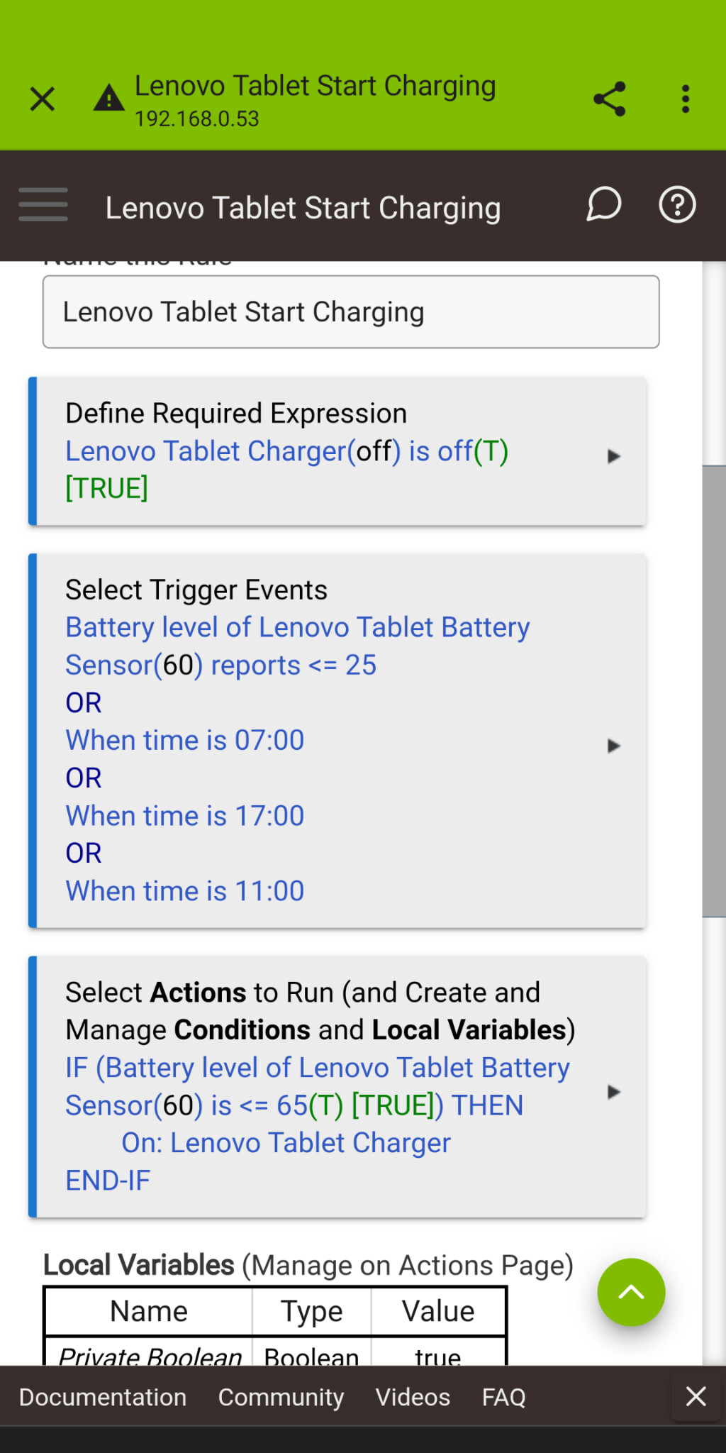

An app would be nice, but I chose to include one more thing into my two rules that handle keeping my Yoga tablet charged. While I was targeting ~20-80% charge, I also wanted to have enough at certain times of the day when I often use the tablet to watch YouTube (meal times).

On the scheduling side this is what ST has available which is very quick to get to and quickly set it up. I'll have a look at that kitchen timer app, it does look like it might do what I'd like it to do.

Tasker, using maker API, is setting the battery percentage on a HE virtual device that represents the battery for my tablet, then the rules I posted are controlling a Kasa outlet using Dave's version of the Kasa integration.
