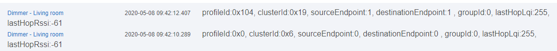

In Hubitat, clicking it sends a physical on/off command and rotating lowers or raises the current % dim from 50. This can easily be linked through to another switch with RM, to give dual control. It’s pretty quick, but not instant. The mirror application didn’t work for me (or others) - I think it’s too quick / gets confused and ends up in loops.
I’ve also found that while in slave mode, rotating the dim to zero or 100 causes it to ‘reset’ to 50 again (based on the Hubitat logs). There are ways to work around this - eg taking the action of dimming as the trigger for RM rather than the % dim value to drive the actions, but tbh that is a pain to sort.
