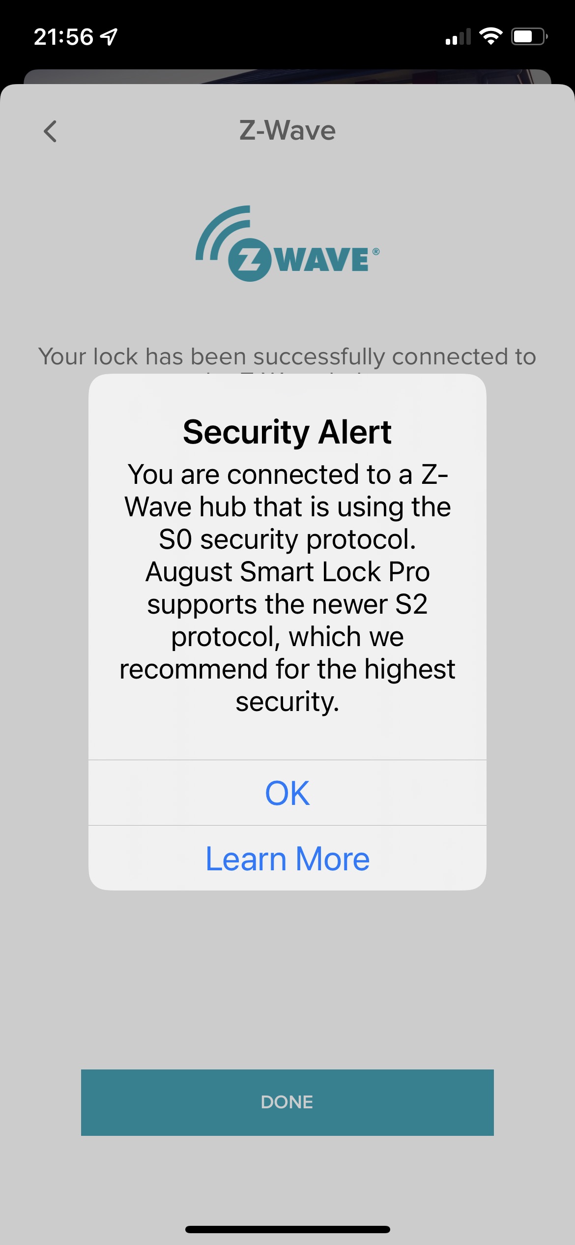

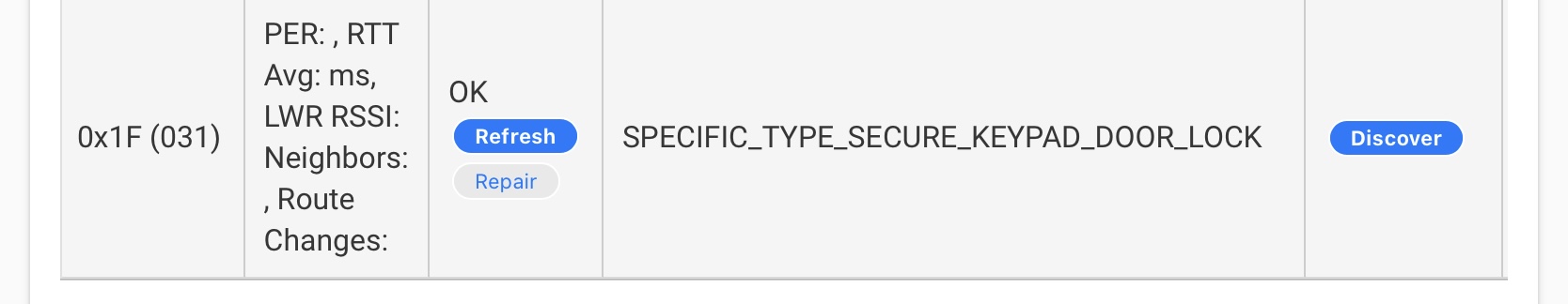

Below are screenshots of the (failed) process. Each attempt triggers a ghost device in HE that has to be removed by exclusion or forced deletion, and the August app indicates that the pairing as completed in S0.

I am also curious if you hit "Discover" on that ghost device, and put the lock back into inclusion what happens. Also, maybe use another hub or Z-stick to exclude the device (Don't exclude using the Hubitat) then hit Discover and see if it will include that way, like a failed device replacement?

Although the pairing failed from the HE side, the lock believes it is paired in S0 (see screen above), so I have no opportunity to put it back in inclusion mode.
