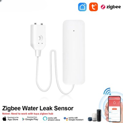

I'm looking at that CHEAP Tuya device, do you think it will work with Hubitat ?
@kkossev is our local Tuya genius, he has helped many w/his custom drivers and assistance getting Tuya devices working. :slight_smile:
There are a lot of companies selling "Tuya" devices as the name is used by many different manufacturers. Here's a link to a search in the Cutom Drivers category for Tuya drivers releases. Many from of them by Kkossev.
Majority of the basic stuff (motion/contact) will usually just work w/a built-in HE driver, or some may require a custom driver. Make sure the devices you order are Zigbee, some Tuya manuf. sell both Zigbee and Wi-Fi versions of similar devices and we've had folks get caught by that. :slight_smile:
Thank you for your answer. It seems to be a real Zigbee device. I'll wait to see if @kkossev has time to answer.
Thank you.
Yep, these look like the ones supported in this driver,
But there is a very good chance that this water leak sensor will also work with the HE inbuilt 'Generic Zigbee Moisture Sensor.' If paired as a 'Device', change to the HE stock driver manually, and then obligatory pair the device once again (without deleting it).
Thank you very much for your help ! I'll order a couple of them ! :slight_smile:
