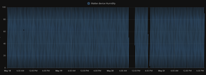

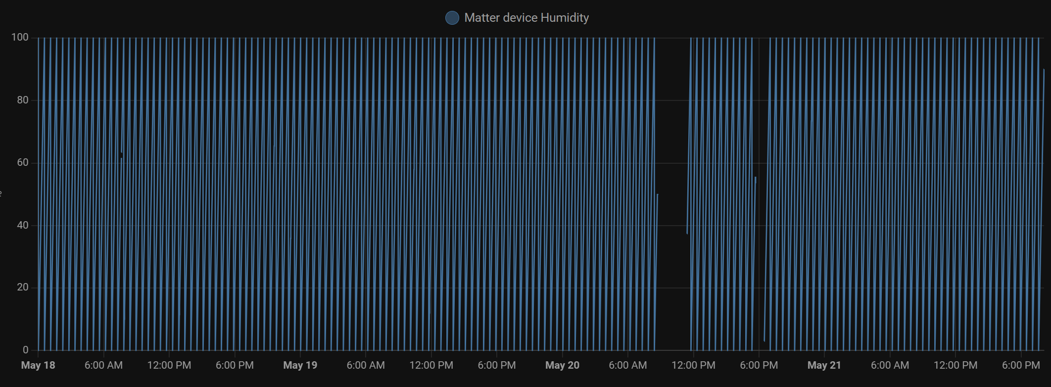

@JasonJoel - Here is the latest data. Looks like there were two dropouts yesterday. I do not have an explanation for either one of these events.

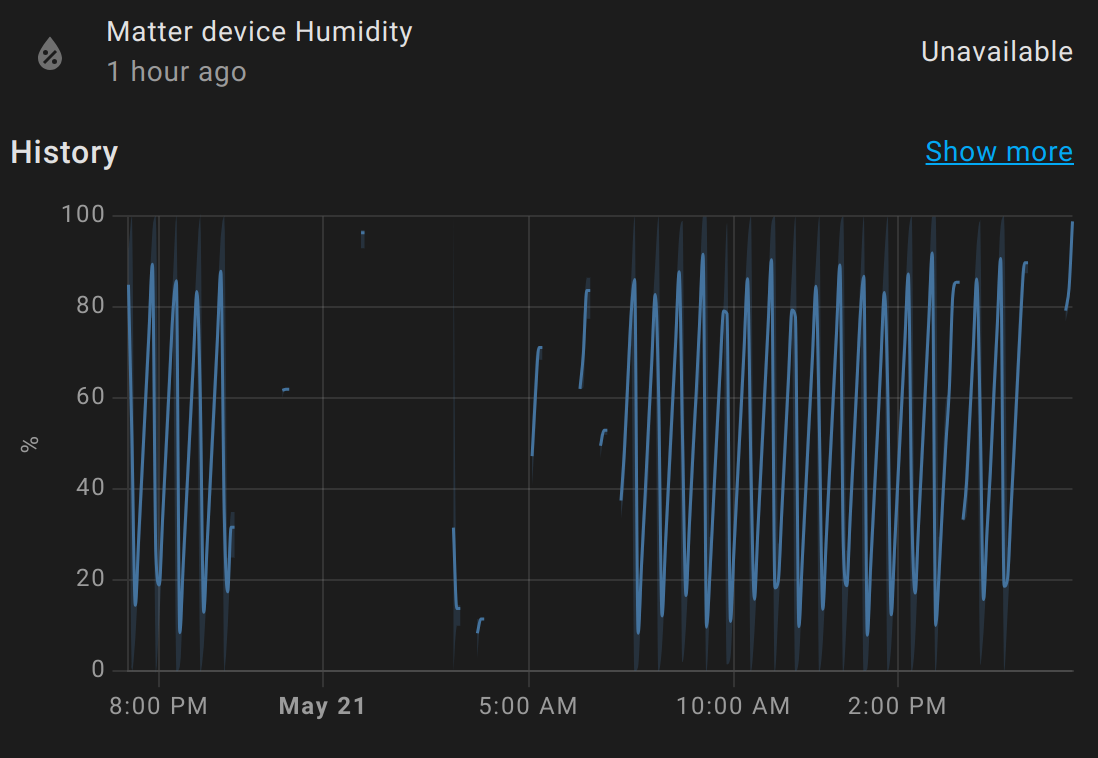

Mine's a bit less impressive. Since moving it to a room way from the Amazon Echo I'm seeing random dropouts a lot.

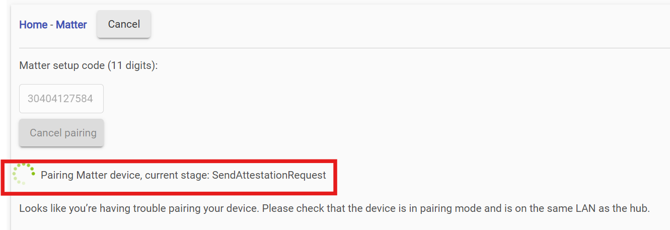

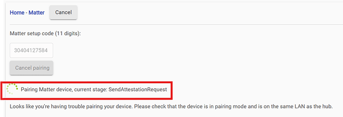

@bcopeland, I am still getting stuck at the same spot in the Matter pairing process on a C8 hub, running the very latest 2.4.3.144 platform. Any chance you could help debug this, when you want a break from Z-Wave for a little while? :wink:
I let it sit at the above screen for about 10 minutes with no changes noted nor anything in the Hub's Logs. I was able to pair it with Home Assistant with no issues afterwards.
