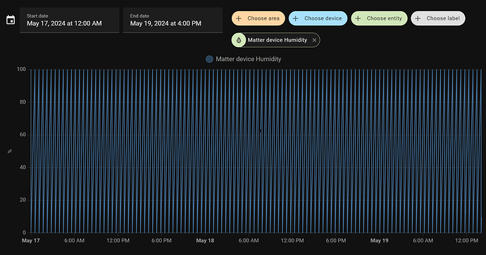

I just switched my Arduino sketch to be the matter humidity sensor example. I have it commissioned/paired to my Apple Home, using one of my AppleTV's as the TBR. I then shared the humidity device with Home Assistant. I'll let it run for a few days to see if there are any drop-outs. I do have multiple AppleTV's and one HomePod Mini that can act as TBR's, so my Thread mesh might be somewhat robust??? Not sure. The Nano Matter microcontroller is not in the same room as any of the Apple TBR devices, though. So, we'll see how it behaves. HA will log the data to its historical DB as well as to InfluxDB, so I should have decent data to review.

Okay, so after sorting out things with my AppleTV firmware upgrades, and finding a self-induced bug in the Matter Humidity sensor example sketch (I made a small mistake when adding in the decommissioning code), I have had a very stable system.
The one drop out in data, circled in red above, was when I upgraded the Home Assistant Matter Server this morning. I figured it would be a good test to see if things came back afterwards, without any manual intervention. It worked great.
So, I am not seeing any drop outs thus far. I will let it continue to run to see if anything odd occurs.
