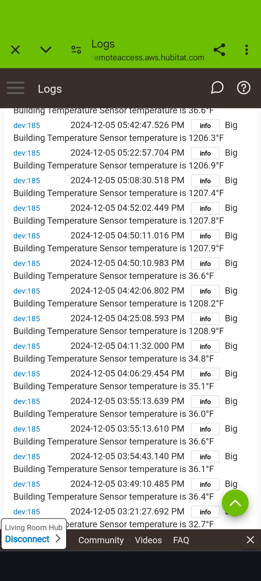

The weird thing is looking back through my logs you can see log entries where that the temperature is reported correctly and then most instances where it is not. Also all entries are in Fahrenheit.

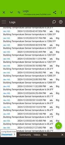

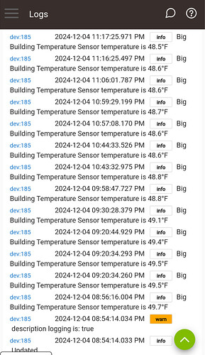

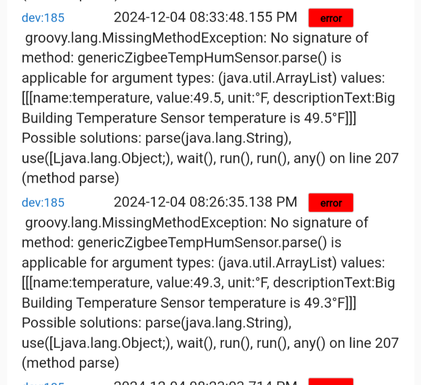

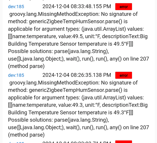

Bobby and @durable-navy-blue-ot my sensor has been reading correctly since yesterday evening. Yesterday I switched to the "Generic Zigbee Temperature Sensor" driver and left it that way all day. It did not work correctly and I got a bunch of warning in the logs. I attached screenshots. Then yesterday evening I switched it back to the "Generic Component Temperature Sensor" driver I was originally using and it has reported correctly ever sense. Which it was not doing originally. I have no idea if this done anything I just wanted to share with you guys.

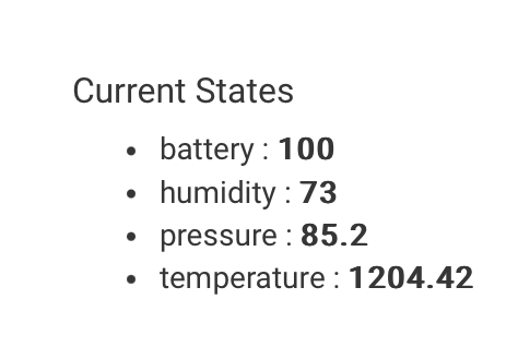

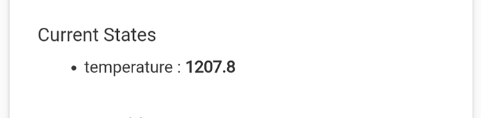

To further confuse the situation I've been having a similar situation but with a wholly different device.. I cleared the logs but I remember at one time it was 1207°F
Current it is working but is seems to come and go.

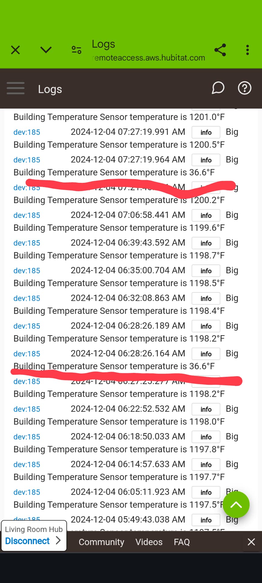

Well, if it matters, it seems like my temperature sensor goes wonky about once a day around 6am!
If it's notable, these are brand new Aqara sensors reporting 100% battery. Thanks for looking into it.
Mine was messed up all night and just changed itself to reading accurate again around 11:45 and been reading correctly the rest of the day.

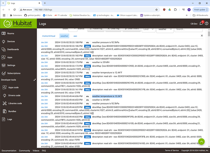

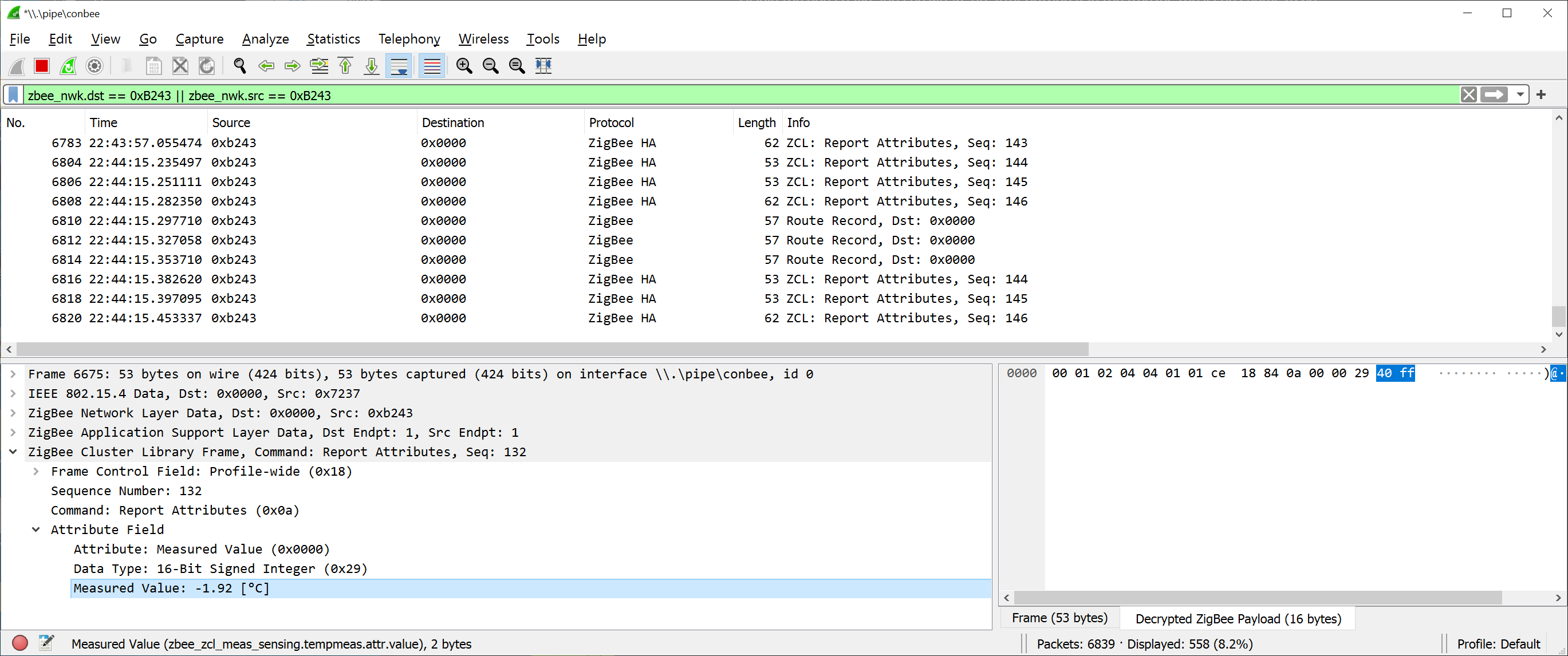

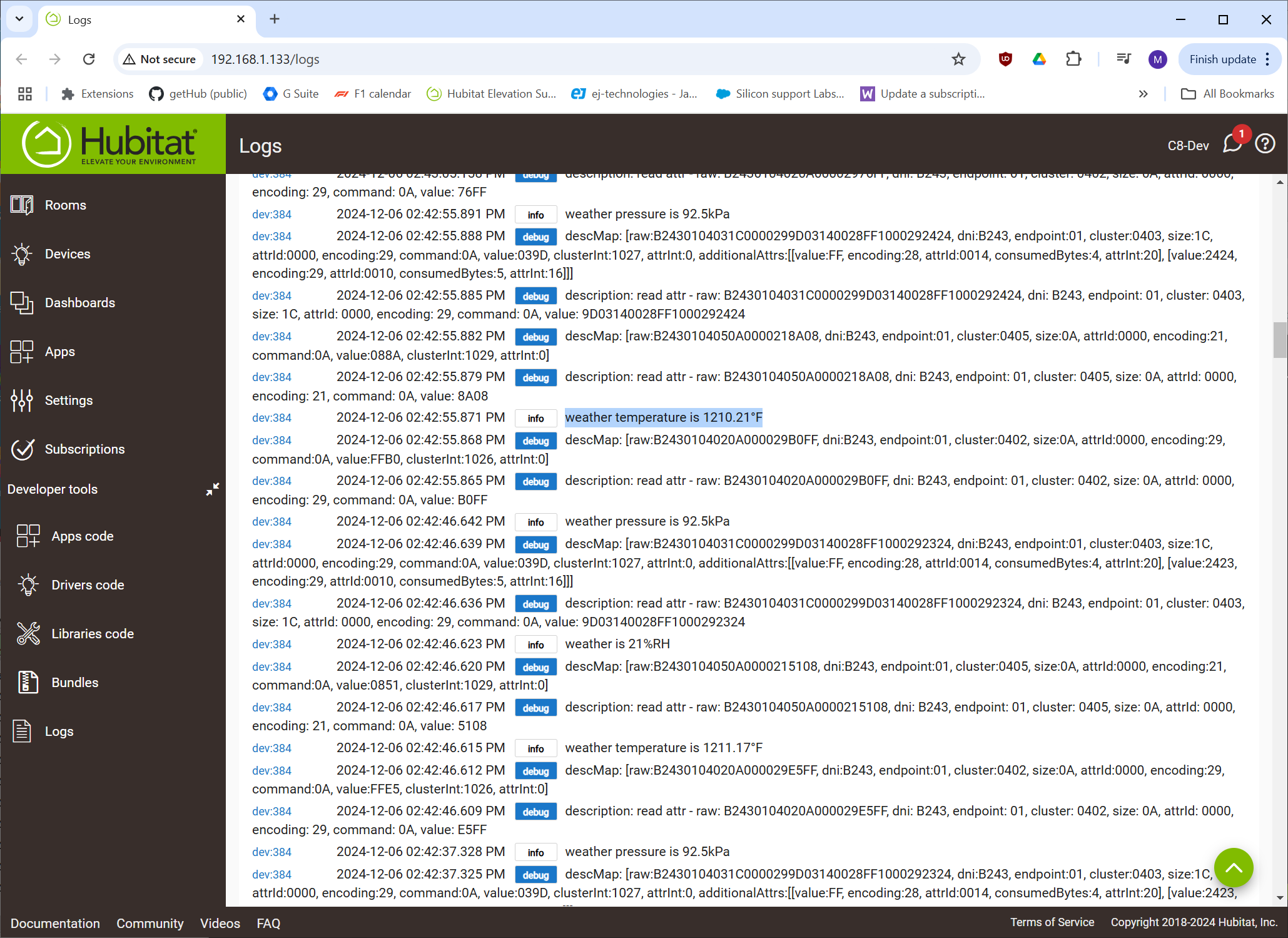

I'll join the one I have and see whats up after putting it in the freezer, the issue seems to be when the device gets around 32F?
bingo, value returned is signed, we're treating it as unsigned
should be a simple fix
a little better, this will go out in the next 2.4.0 release
