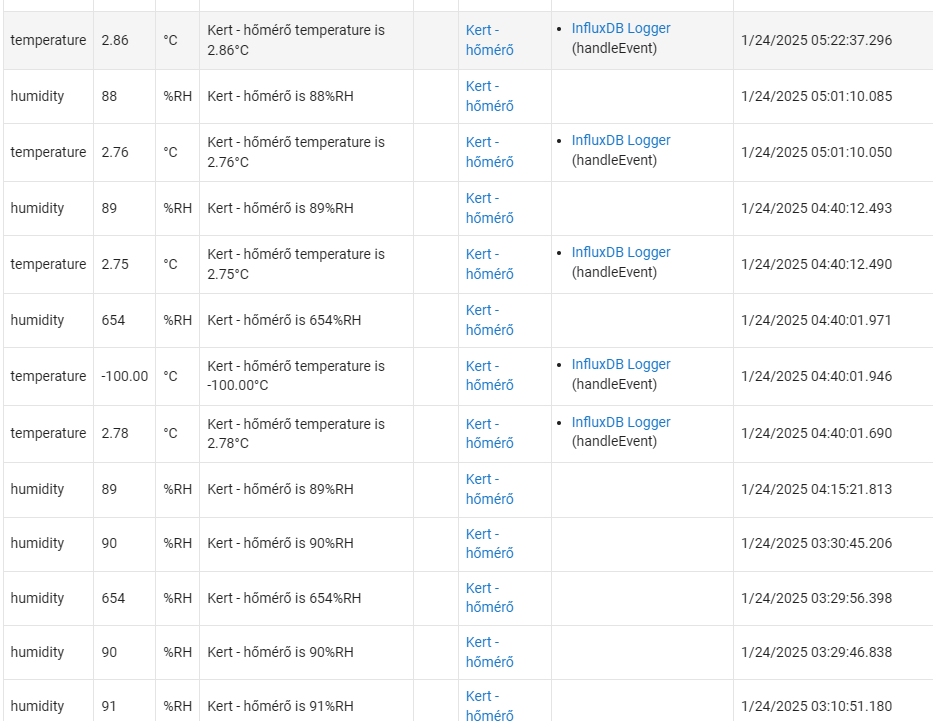

I still receive incorrect values, however this issue seems to be quite a bit different.
The device usually report correct values, but sometimes things go awry, and I receive a temperature value of -100 (Celsius), and/or 654% RH.
It happened twice in the last 48 hours, but I haven't experienced it before. Nothing has changed in the setup since then.
This is what I see in the events:
No errors logged for that device, and the battery was replaced a few weeks ago.
Any ideas?
Thanks.
Which device type/integration is this?
It's a zigbee "lumi.weather" device (WSDCGQ11LM) with the built-in "Aqara Zigbee Weather Sensor" driver on a C-7 hub (fw 2.4.0.143)
I'll have something to handle this in release 2.4.1
