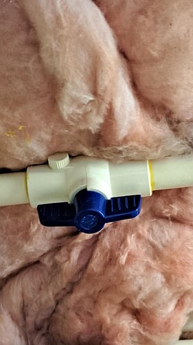

Tagging along because it just popped up on my YouTube as well. I have two different valves on my incoming water supply, a Gate Valve and this which i believe is a Butterfly Valve:
The Dome shutoff valve that I got when living in previous house and all the other ones I could find only work on Ball valves. The Aqara says that it will work on a Butterfly Valve but none of the limited videos about it show how to install on Butterfly Valve or a picture of it installed on that type of valve.

I admit my bigger concern would be the CPVC pipes and valve... CPVC is more brittle than other materials (copper, galvanized, PEX, brass/metal valves), so it's on the do not use or not recommended list for many automated valve manufacturers. I didn't see any CPVC-related info from Aqara in that Amazon post, but I admittedly didn't pour through it all in great detail.
I plan to build a makeshift frame around the valve controller to hold it in place so that it is not applying any dangerous stress to the pipe. Hopefully that will work.

The one in my photo is only a 90 degree turn and I am not saying that is a gate valve. The problem is all of the valve controllers I have found, like the Dome Controller I already own, only work on this type of ball valve with a long arm:

It seems the problem you have is connecting an actuator to your plastic valve. Honestly I would be concerned using an automatic shutoff on a plastic valve. I have no direct experience, just my "feeling".
You could adapt the Dome you have by making a longer arm, however I feel you should find a location where you can install a brass ball valve for your dome. Or maybe you can find the fittings needed to convert your PVC to brass/copper, install a proper valve then convert back to PVC.
