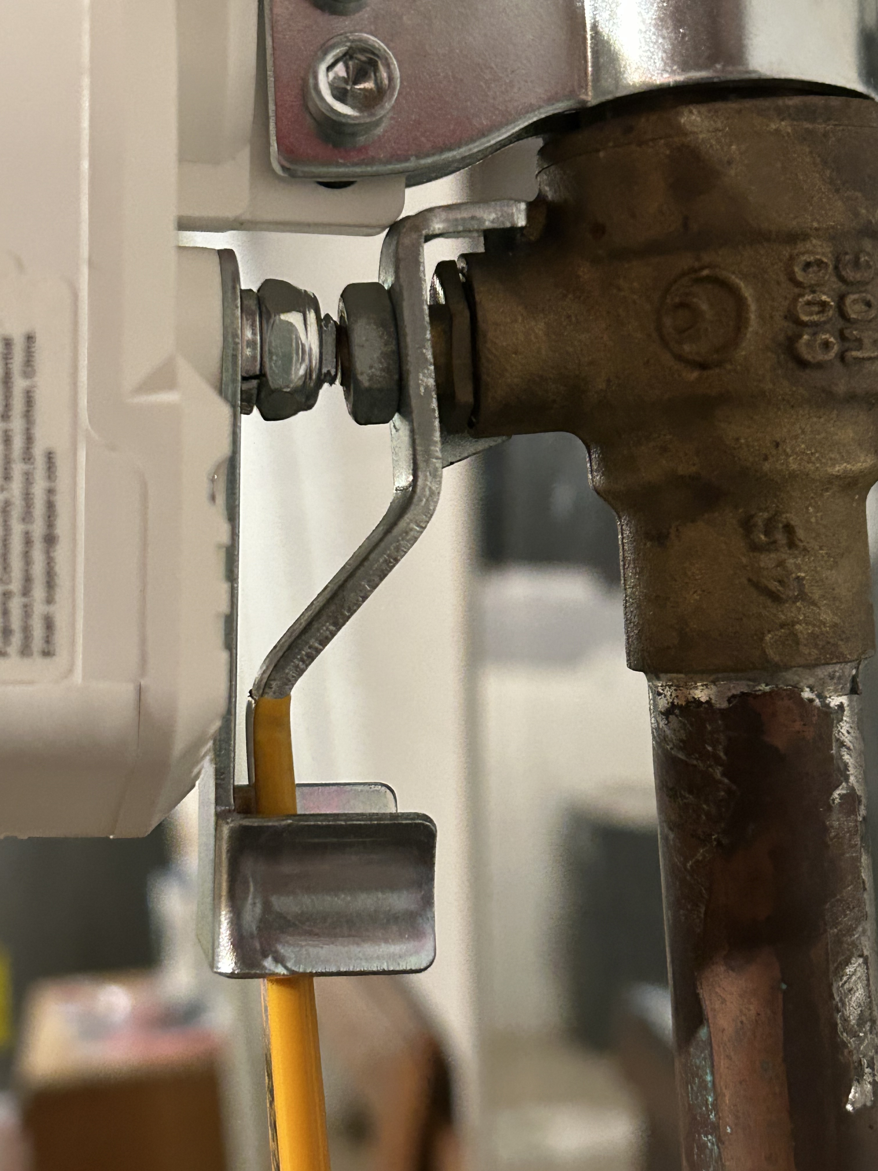

But… Buyer Beware! The mounting brackets have very tight tolerances and no easy way to adjust the fit to my water valve. (see photo) My valve lever appears to be about 1/8th to 1/4 inch higher above the pipe than I have seen in photos or videos of other installation. Also the screw from the Aqara device may be a tad longer than need be, causing it to touch the screw on the valve lever.
The Aqara works but it only turns about 87 degrees, not 90, in each direction. I suspect that this may be caused by the touching (friction) of the 2 screws which may limit the rotation. But I don’t know for sure if this is the reason it is not turning a full 90 degrees.
I could hacksaw or grind down the screw to try to create some space but I don’t want to mess it up either.
Anyway, if you are planning to buy one of these, make sure you pay close attention to any and all measurements and instructions, cause if it’s a hair off you may have issues like me.
