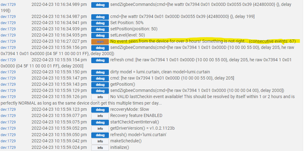

I then change the driver:
The Driver is definitely 1123x
Here's the log after I Initialize a couple of days later:
Just don't know what to try next.... I would give up if it wasnt that @mo.hesham @JTT & @poli all have these running.

Taking another look at the data i sent to you @mo.hesham I really wonder if that indicates I'm just not running the new Driver... is there a line of code I can drop into the Driver to show up on the log?
no it appears you're running the latest driver; it showing as 1123b is just a display bug that I've fixed now; it shouldn't impact the operation of the device though. it seems that your device is not communicating at all. can you please try re-adding it but don't use Zigbee this time, use "Iris V1 Zigbee" hopefully this will fix it, let me know how it goes.
