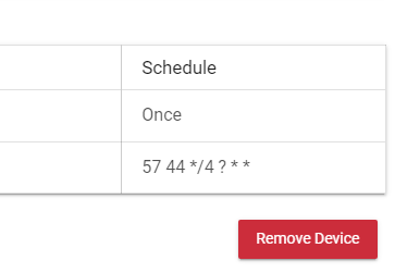

Did you delete the device first? Use the red "Remove Device" button at the bottom-right part of the device web page :
