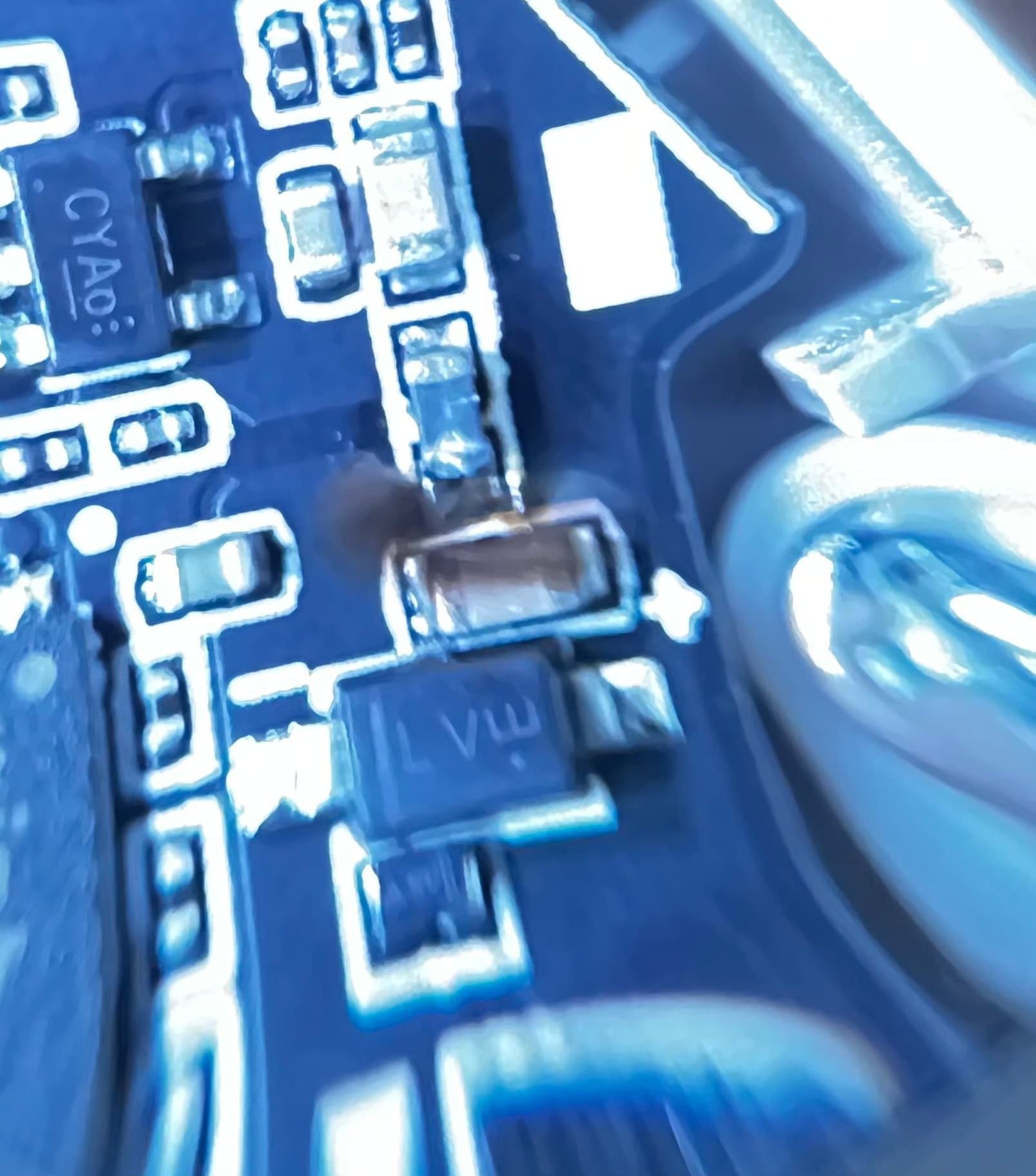

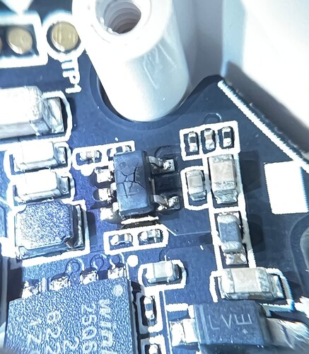

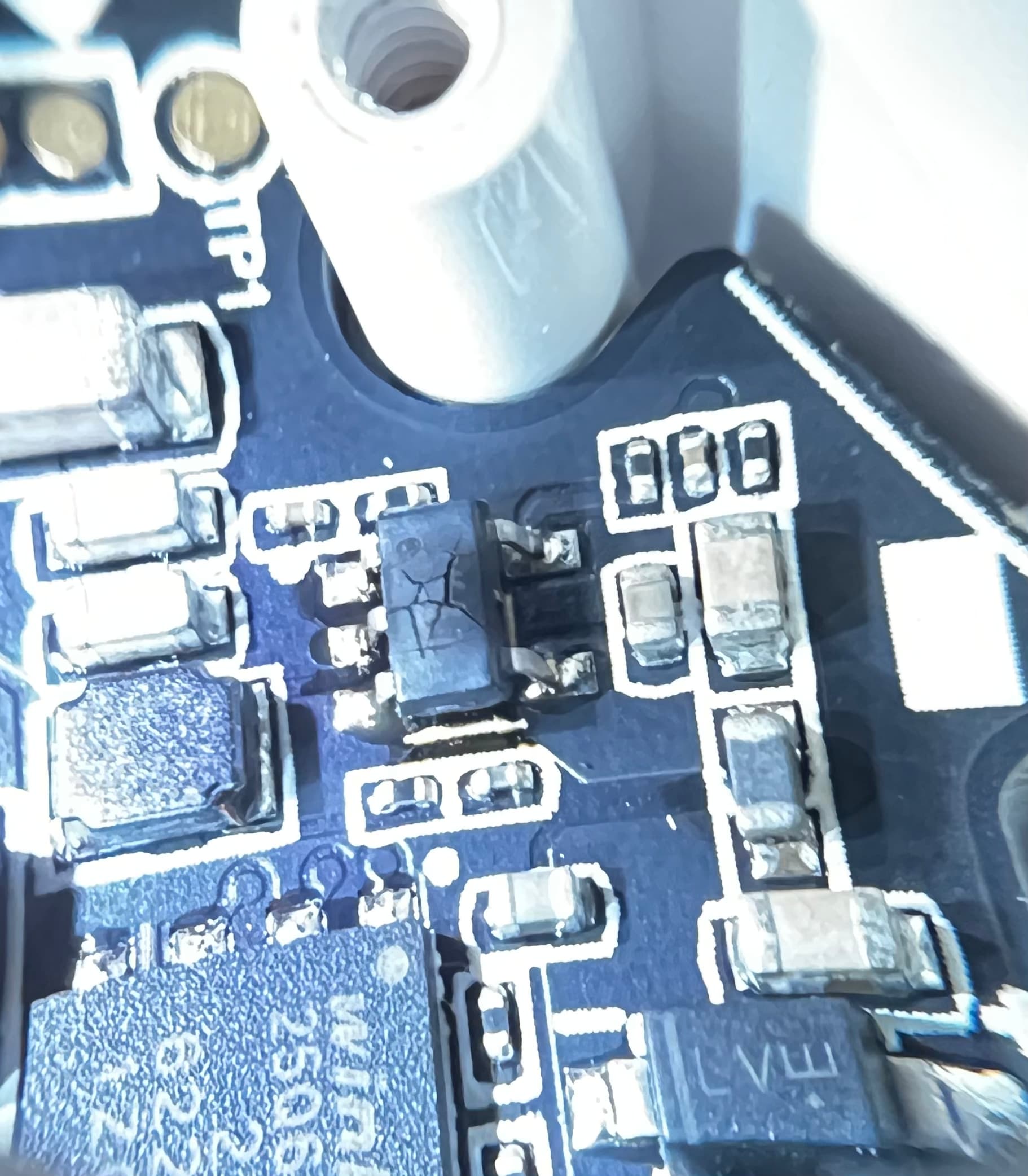

I’m just guessing, but it looked to me like there may have been an over voltage in this case. One unit appears to have a blown capacitor and the other appears to have a blown bridge rectifier.
Supplying a power supply with the device would cost more and be regional, but :man_facepalming: Every cheap security camera I’ve seen includes the 5v adapter. If they can make the pricing model work for devices that are often $50 or less, than Aqara should be able to do the same at this price point.
I only used one of them; the other FP1 was connected to a powerstrip with a USB port. But my devices didn't die like yours -- they just stopped responding (and now won't properly reset). I did open them up but didn't find anything obvious blown like you did.
Need a powerful loupe to see these. I have one that is lighted which makes it easier to spot issues. Without that, it would have been almost impossible to see, but that telltale smell was present.
