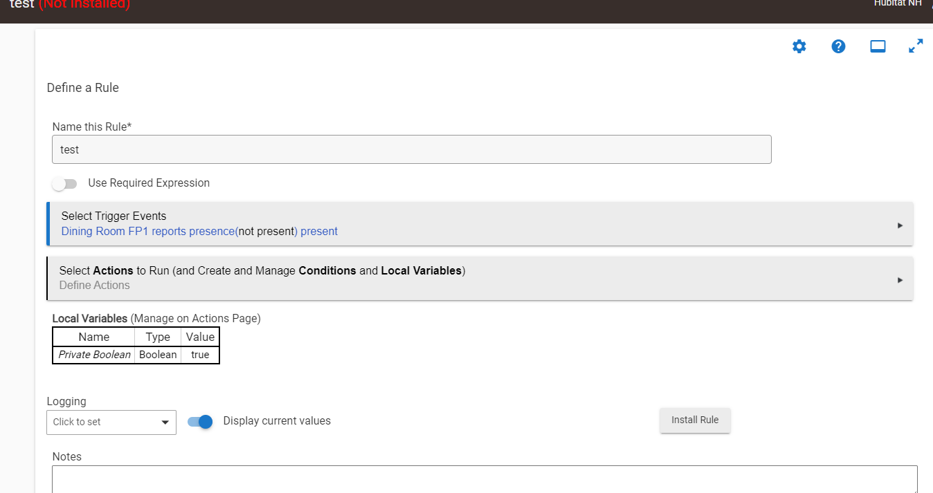

From what I’ve researched the ‘presence’ is the main feature to be able to detect if someone is still present in the room whether they are perfectly still, sleeping, etc and would be used to prevent light automations from shutting off like a typical motion sensor would. However I’m not seeing those results as presence would shut off repeatedly overnight as I just checked my logs and events from last night for my bedroom FP1.

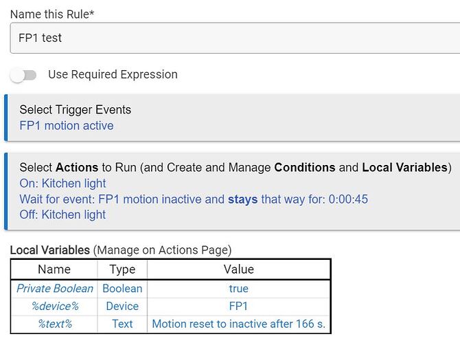

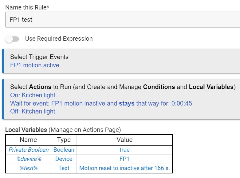

I just received mine yesterday and I just did a basic setup for testing on Rule Machine. I'm using my kitchen counter as desk. I'm in / out, seems to be working well. It doesn't turn off when in the kitchen and I am surprised how fast it turns my light on when I come back in. I have the turn off time 45 sec after no motion. The turn off time varies but does turn off the light.

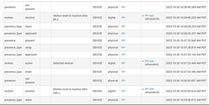

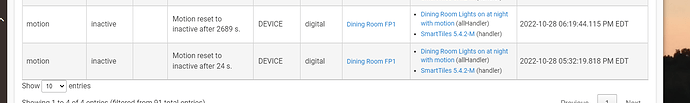

What I’ve found in my testing and can prove with logs and events is that even while still being in my room well within the active field of the FP1, it eventually switches over to “not present” after prolonged inactivity (incorrect) and motion switches back to “inactive” (correct). This could be me on my laptop working and not moving much, sleeping or just reading. But it does incorrectly change the presence attribute to not present while still being present in the room. That was the piece I was trying to describe above in previous comments. Unless I’m mistaken you’ve paired the motion and presence attributes together. What I’m not clear on is if the FP1 is doing somewhat of a timing out and incorrectly sending out a not present response or not.
mine doesnt do that.. i've sat for over an hour there and it stays active.. weired
here tonight we were sitting there and it was active for about 45 minutes

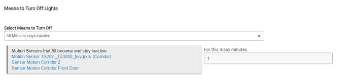

Hi, I need a bit of help with setting the P1 with my kitchen lights.
Here are screenshots of my RL app and the P1 device.
I'm trying to get the P1 to keep the lights on as long as it's activated, and when it's not, to turn off the lights after 5 seconds.
this would be much easier down in built in motion lighting app..
