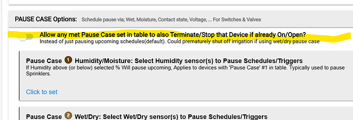

Currently Pause cases only prevent a schedule or triggered device from starting. Added this so those Pause cases can also shut off/close a device if they already On. ver 2.3.5

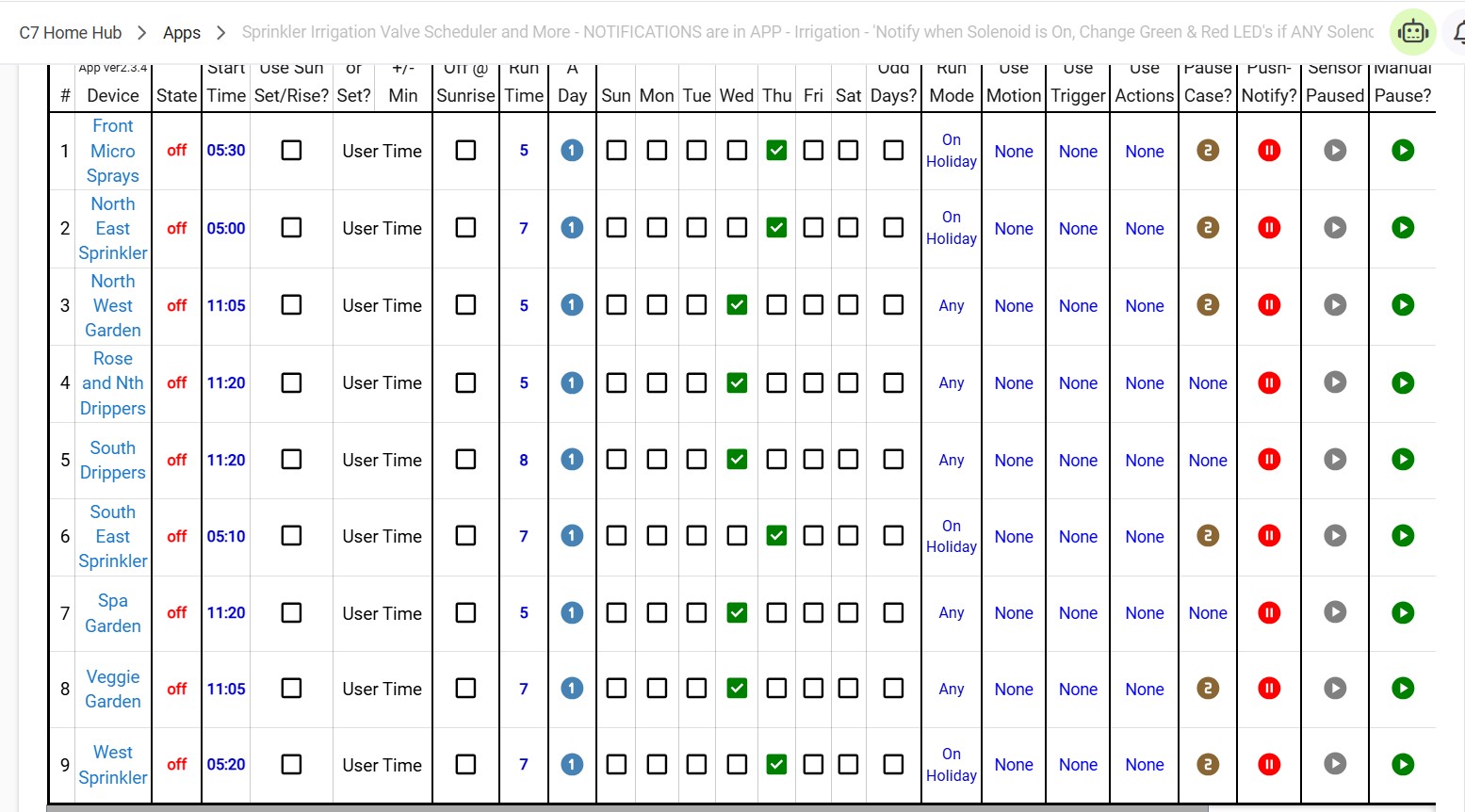

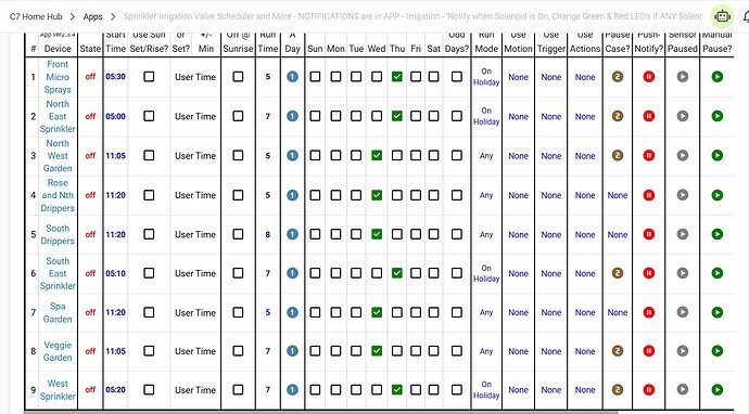

I think I finally got a seperate automation to trigger low & high flow on the flow valve, then turn On a switch to turn off the Irrigation. It’s been very tricky to get right. I recently found a bit of a glitch which I’m pretty sure (but not certain) that your app would not do??? If I have 3 sprinklers scheduled to start at the same time, but stop after different lengths of time, the 1st one shuts off, the remaining 2 kept running, didn’t stop until I stopped them. However I’m sure they used to?? Any Idea?
The glitch is continueing to occur. I've had to install an automation to turn off any switch that has been turned on for more than 10 minutes.
It's only happening with Device #'s 3 4 & 5

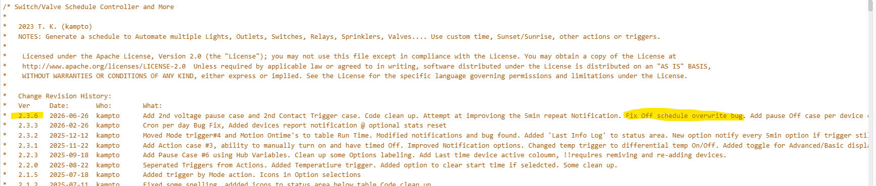

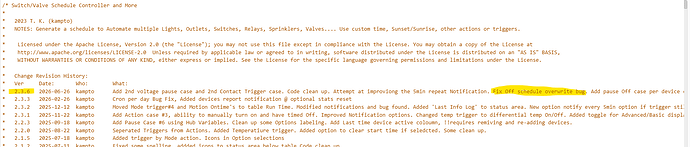

Wait, Maybe its already fixed.

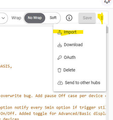

Go to App code and import the latest. Save new code. Open app and hit the update schedules button.
There's new column called "Off case" which if checked will use a pause case to turn Off a device if already On. Keep it unchecked for your case.
Thanks I've done that & left that new column unchecked. I'll see what happens next Wednesday :+1:
