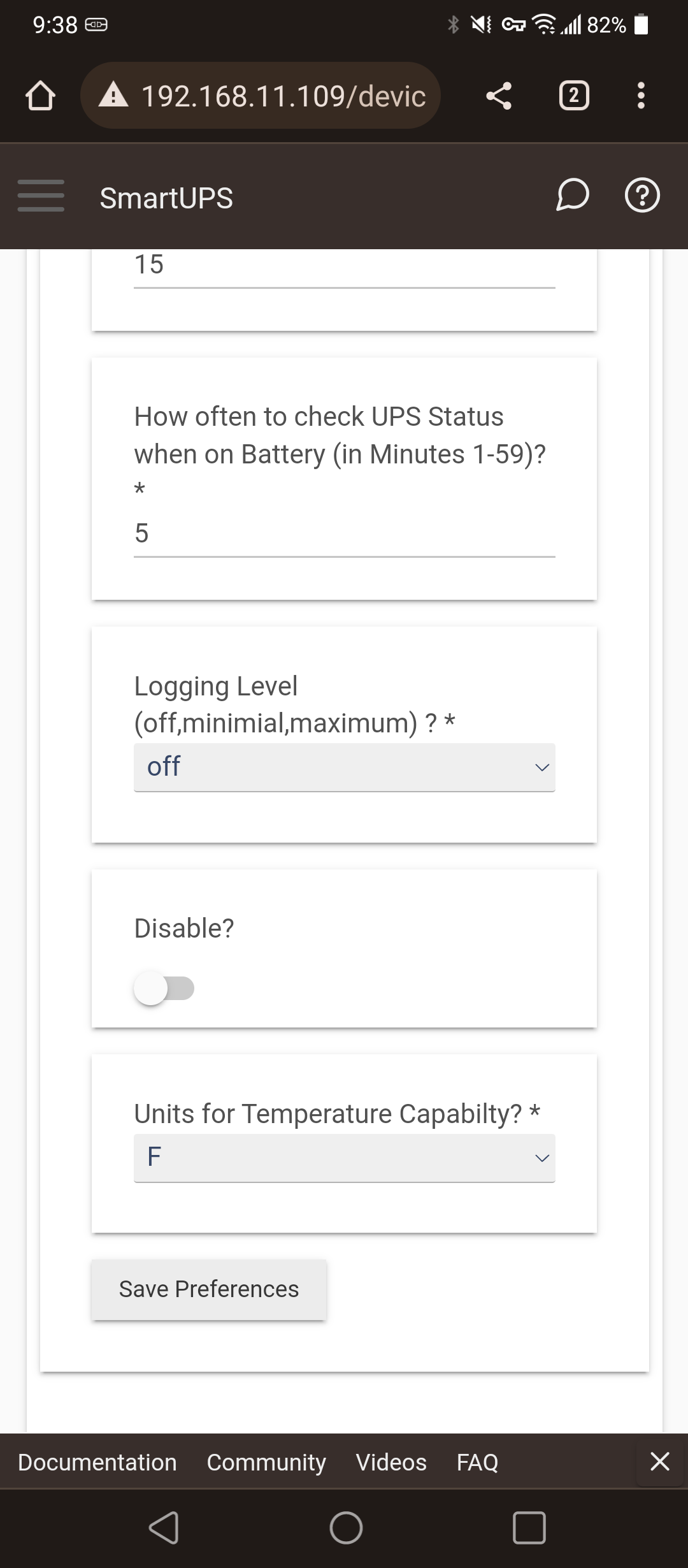

There is no disabled for logging in my driver ...off is the lowest level.
My point is they are debug level messages and debug level logging is disabled. That seems incorrect. They should be info level if they can't be disabled by turning off debug logging.

I added code to work around it.. still 4 lines come out you can comment them out if you want.
new version 3.9
v 3.9 in order to get all output some were repeatedly coming out more than once, there was no way around this so added variabled to not put out more than once.
- also change messages that cannot be turned off to info instead of debug.

I can do you one better added an offset field to parameters so you can have all run at say x minutes but offset by so many minutes past the hour..
ie
new version on github
- v 4.0 add minute offset for runtime, so with multiple device say you schedule every 15 minutes with offset 2, it will run at 2 past the hour then 17 past the hour etc
- in this way you can have multiple ups's and have them run every x minutes but stagger them so they dont all run at the same time.
quite a few lines change so let me know if you see any issues especially when switching to on battery runtime and them back to normal, as I am not home where my ups are so cannot test the switch over.
