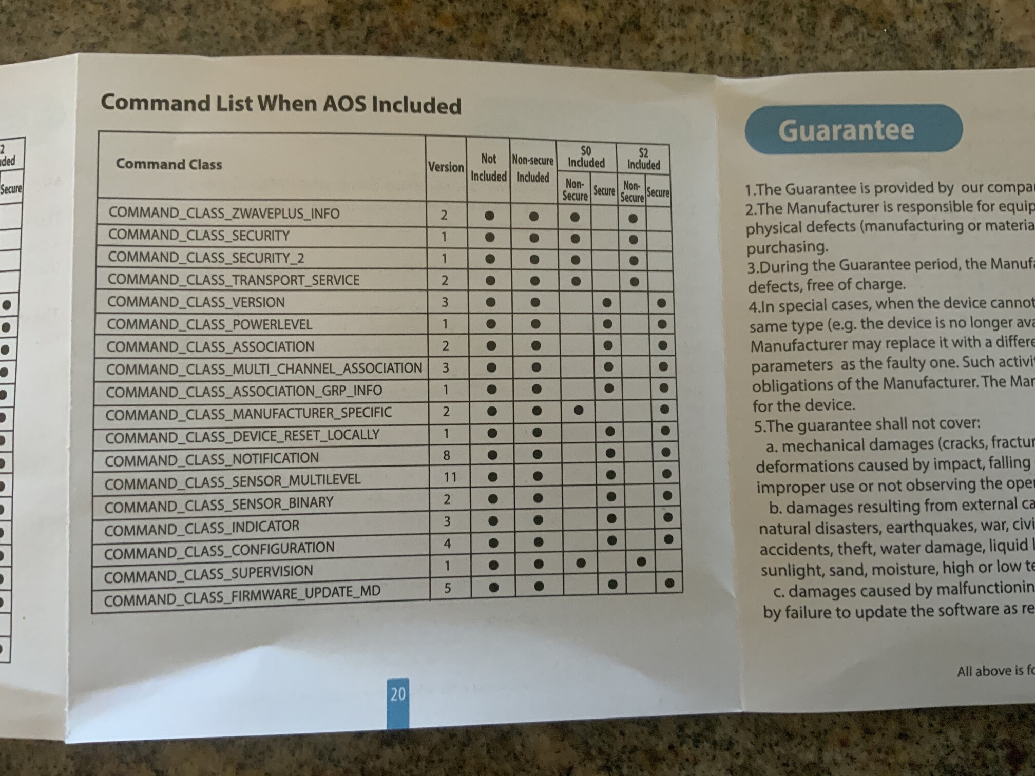

That was a lot of text to say "no battery or wakeup command classes when paired with USB power".
Thanks to your pics I found the manual online ( https://usermanual.wiki/NEO-ELECTRONICS/NAS-WR12Z1U-5245649.pdf ). After taking a quick read, I don't see why a driver for this shouldn't be doable.
The manual is pretty good for a weird/non-mainstream device.
I'll try to get a driver out Sunday after my device gets here so I can verify functionality.
Sounds good, I changed it to S2
Did you try Aeotec Multisensor 6? I wonder it's from the same manufacturer, both have similar features and use 2x CR123A. And just like Multisensor 6, it has to be powered during inclusion to work as a repeater (forgot where I read that)
This device supports 2 role type: AOS(Always On Slave) and LPM(Low Power Mode). Which role type is valid decided by which power (Battery or DC Power) is supplied when include
When device is included with AOS, it also can make a repeater role.
(So the reply from their support from Aliexpress which said not to be used as repeater was wrong)
It would be worth a try using the MS6. I haven't looked at that driver in some time, but as this device just uses notification and multilevel reports for the value reporting, it wouldn't surprise me if another driver worked.
Need a custom driver for the parameters/settings of course, though, as they are on different param #s.
